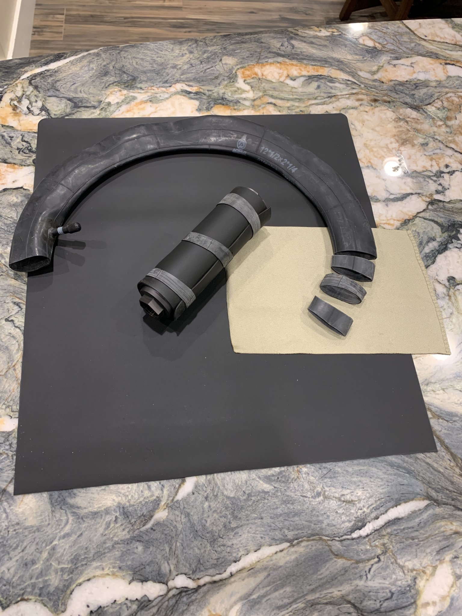

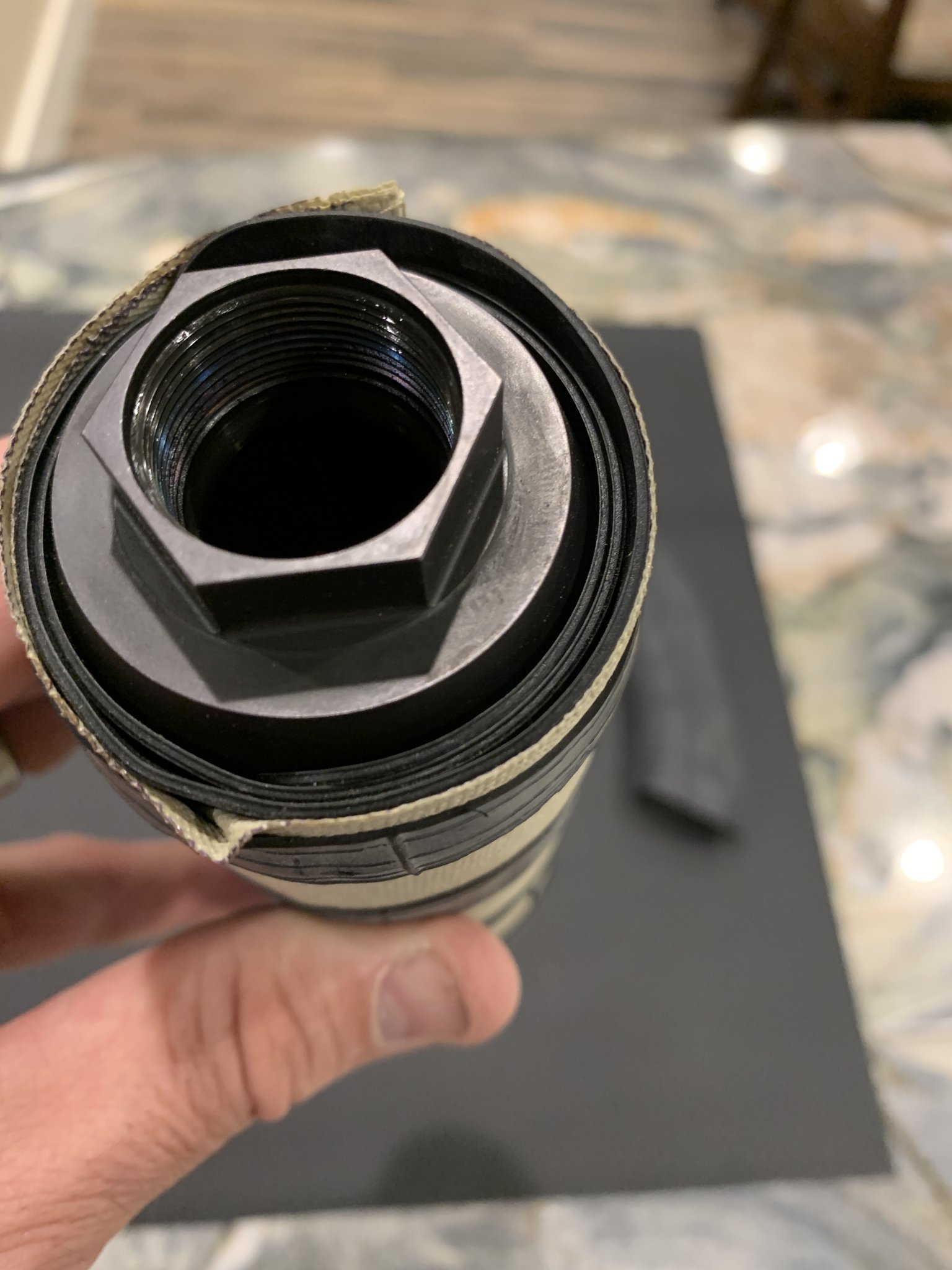

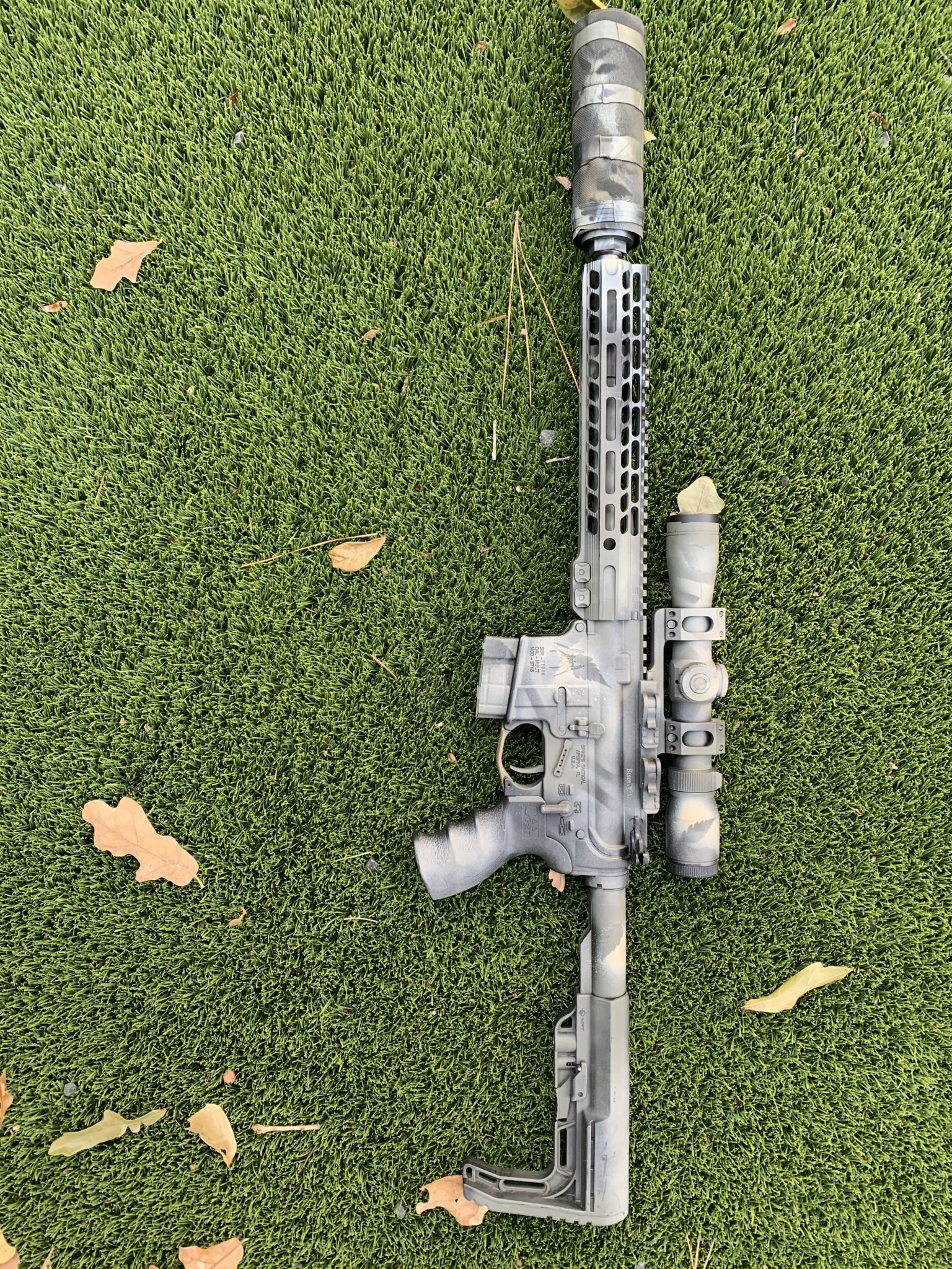

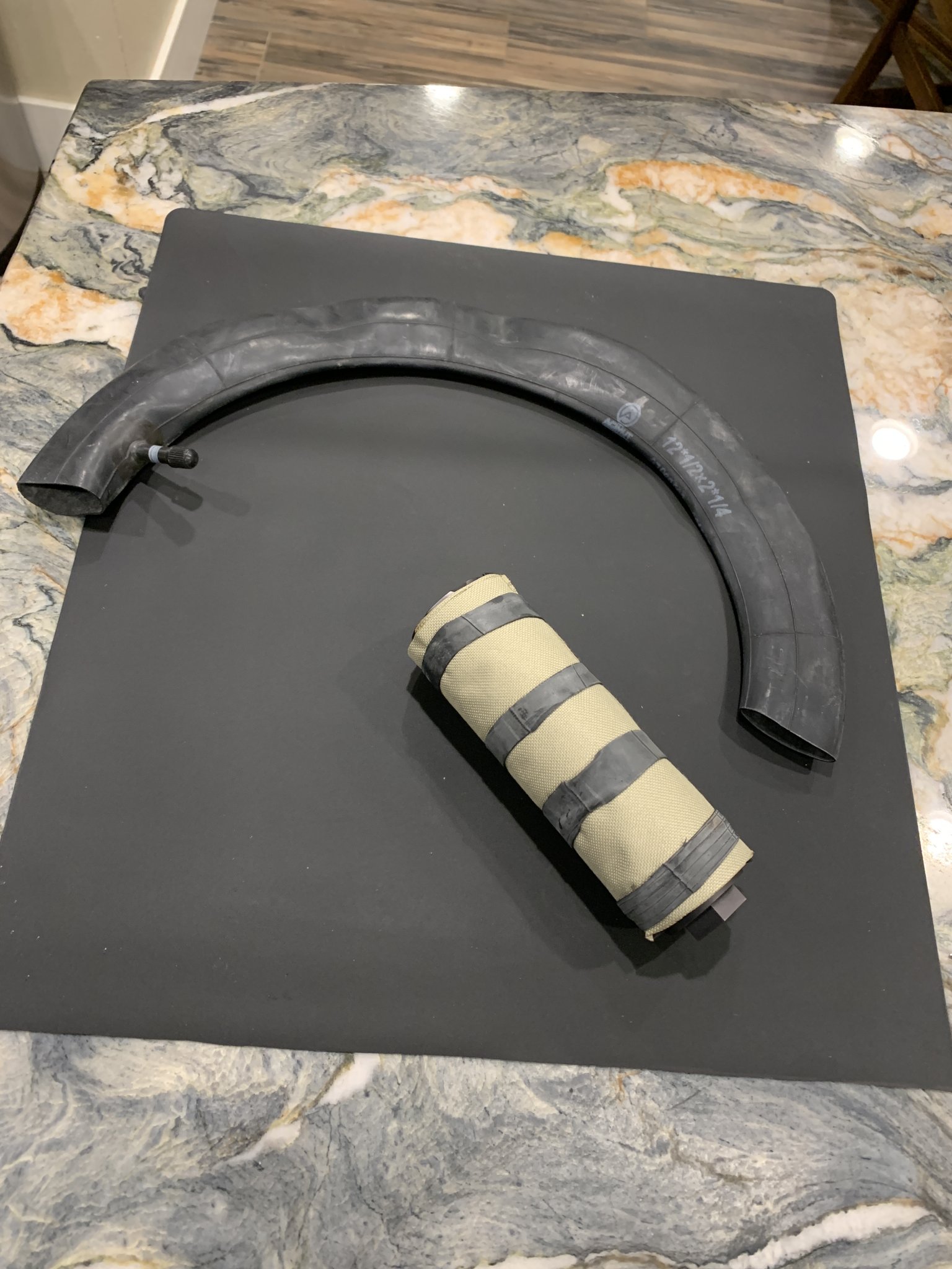

I make mine out of silicone pads too. Cheap on Amazon. To hold them in place, I cut a bicycle inner tube and make heavy-duty rubber bands. Then I wrap that with cordrua (also cheap on Amazon) and hold that on with the inter tube bands. And if I’m feeling fancy, I spray paint them. And sometimes the gun too!
