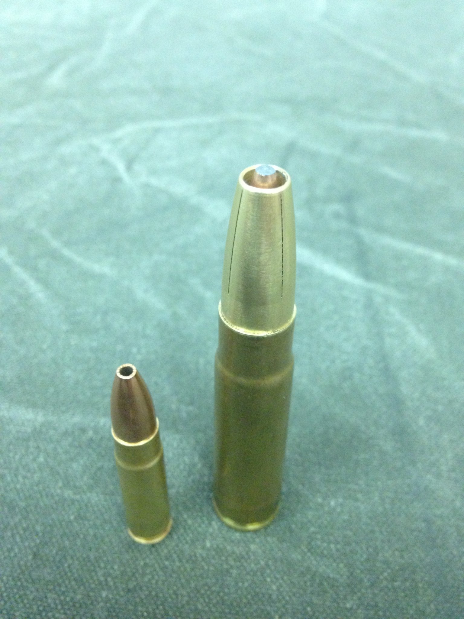

458 from a Rigby. 300 bo on the left for reference. Don't know of any cheap and easy way though.

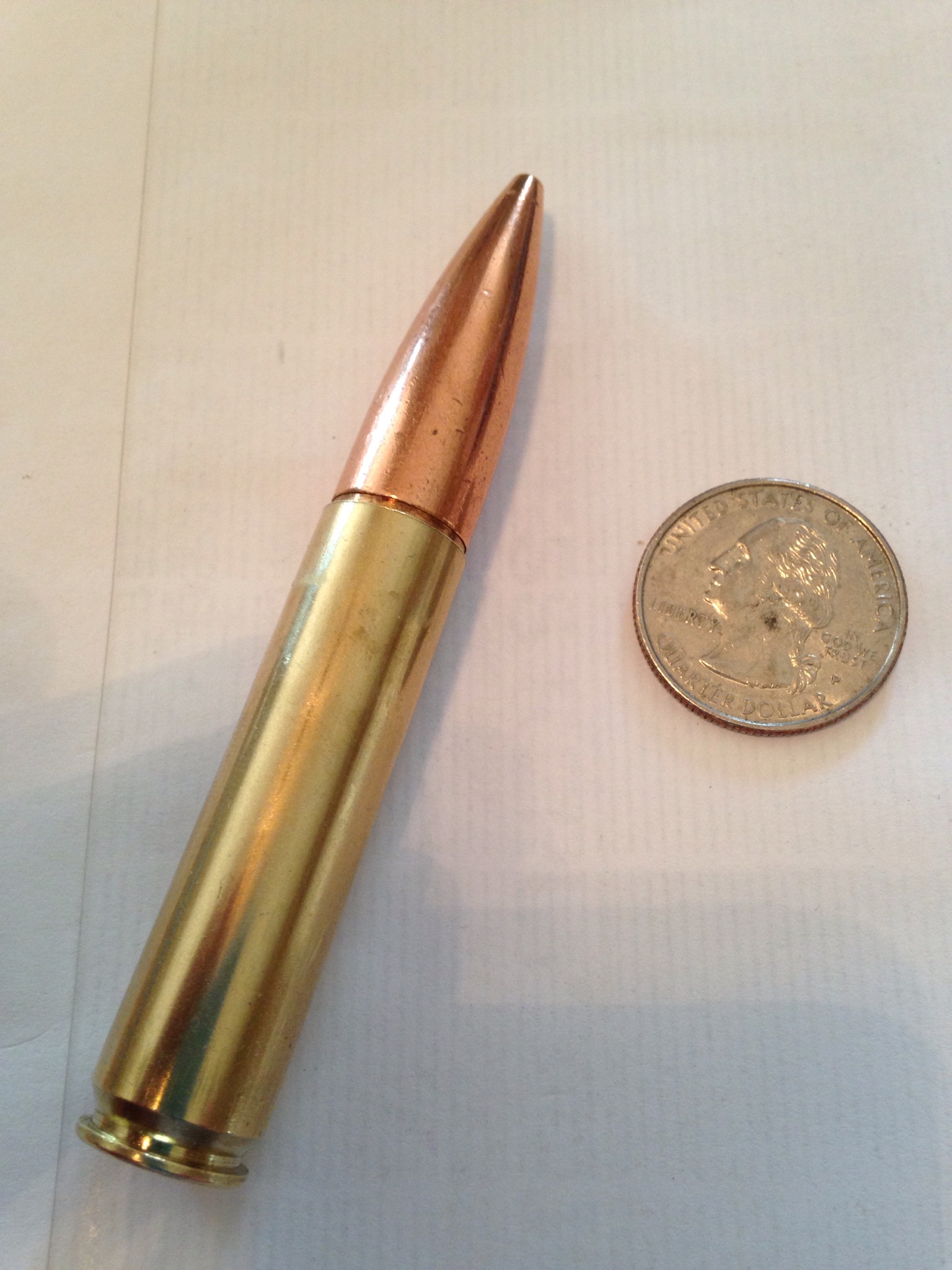

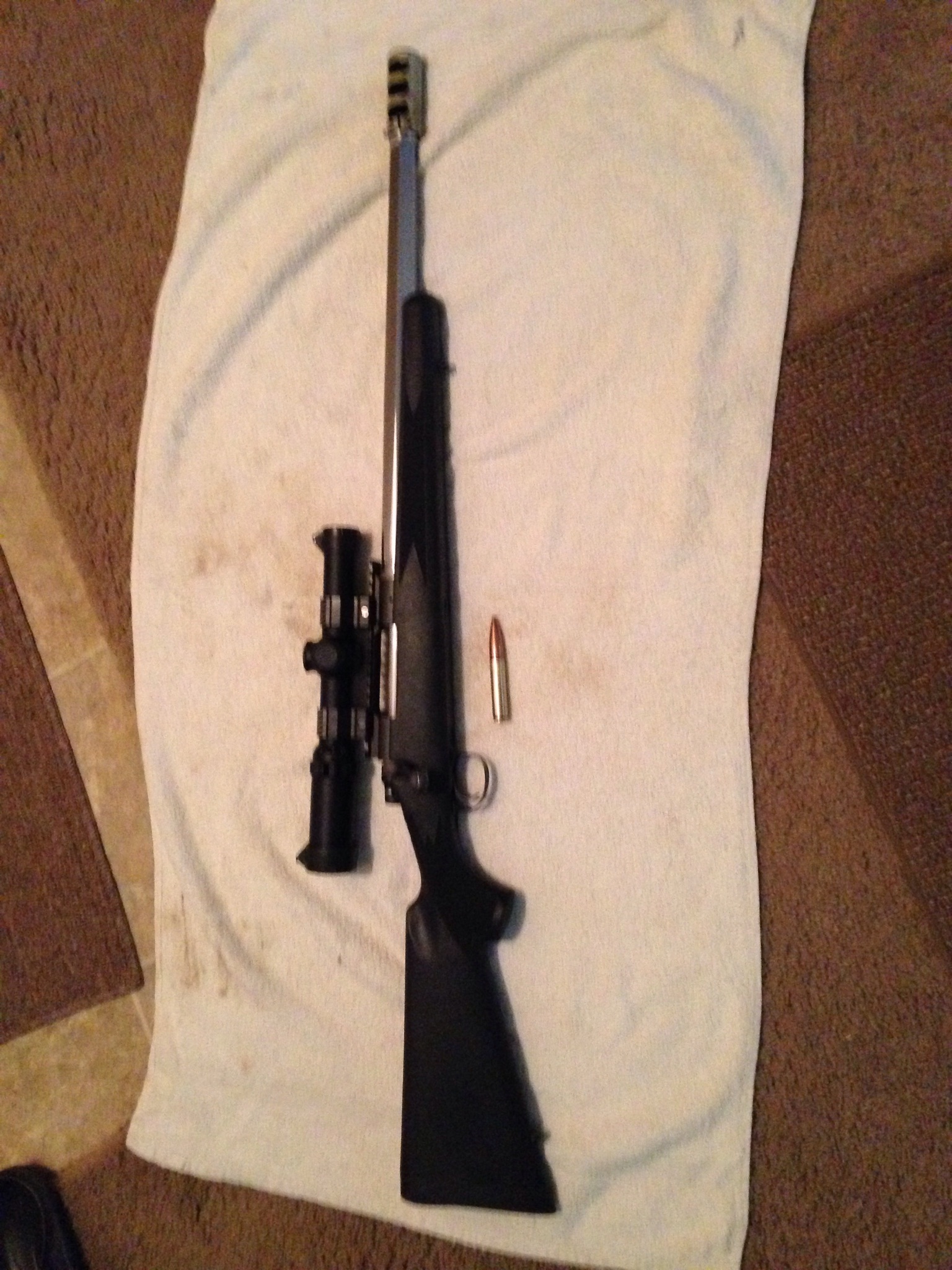

Not common. Actually, there's only one that I know of.
Modified 300 RUM case. Pretty much a rimless 50 Alaskan that headspaces on the case mouth.
