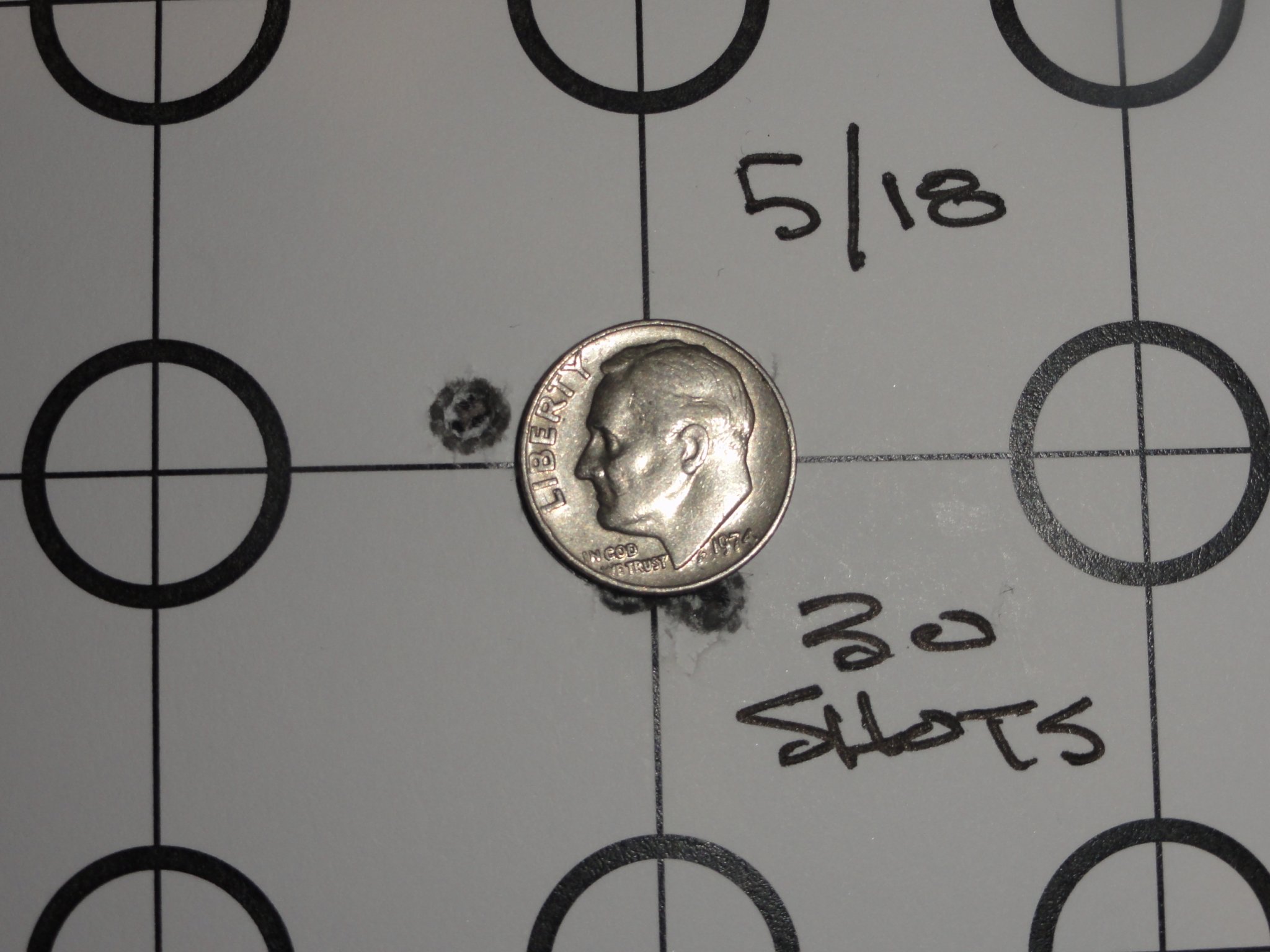

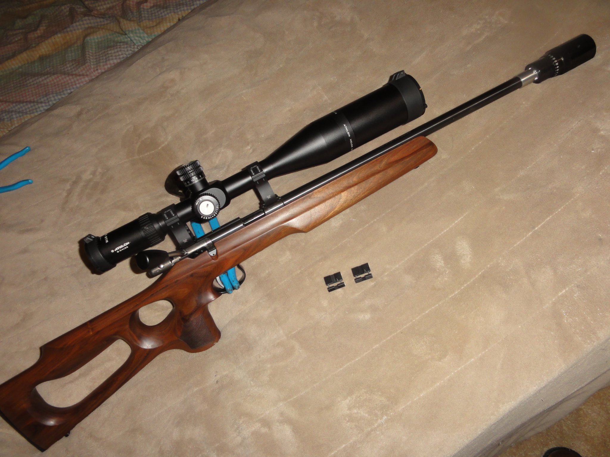

Hello MJ, I can't speak to the 419 457 but I can tell you that my 457 MTR shoots nearly as well or as well as my Vudoo. These are old photos and I didn't shoot these with the tuner on. The 457 cost me about 750.00 and the Vudoo plus the MDT LXS chassis and a Trigger Tech Diamond trigger set at 6 oz. was about 3300.00. The 457 is stock except for a Yo Dave trigger spring kit that brings the trigger down to a crisp 9 oz. and an AREA 419 bolt knob. I would never even consider putting on a new bbl. on the CZ because she shoots great ! The shot outside of the dime was my fault.
Currently I have my Trijicon 5-50x56 scope on the CZ and that is very nice as well. 1800.00 from B&H photo. They have a 30 day return policy. I would recommend the AREA 419 scope rail and their bolt knob is a MUST have item.

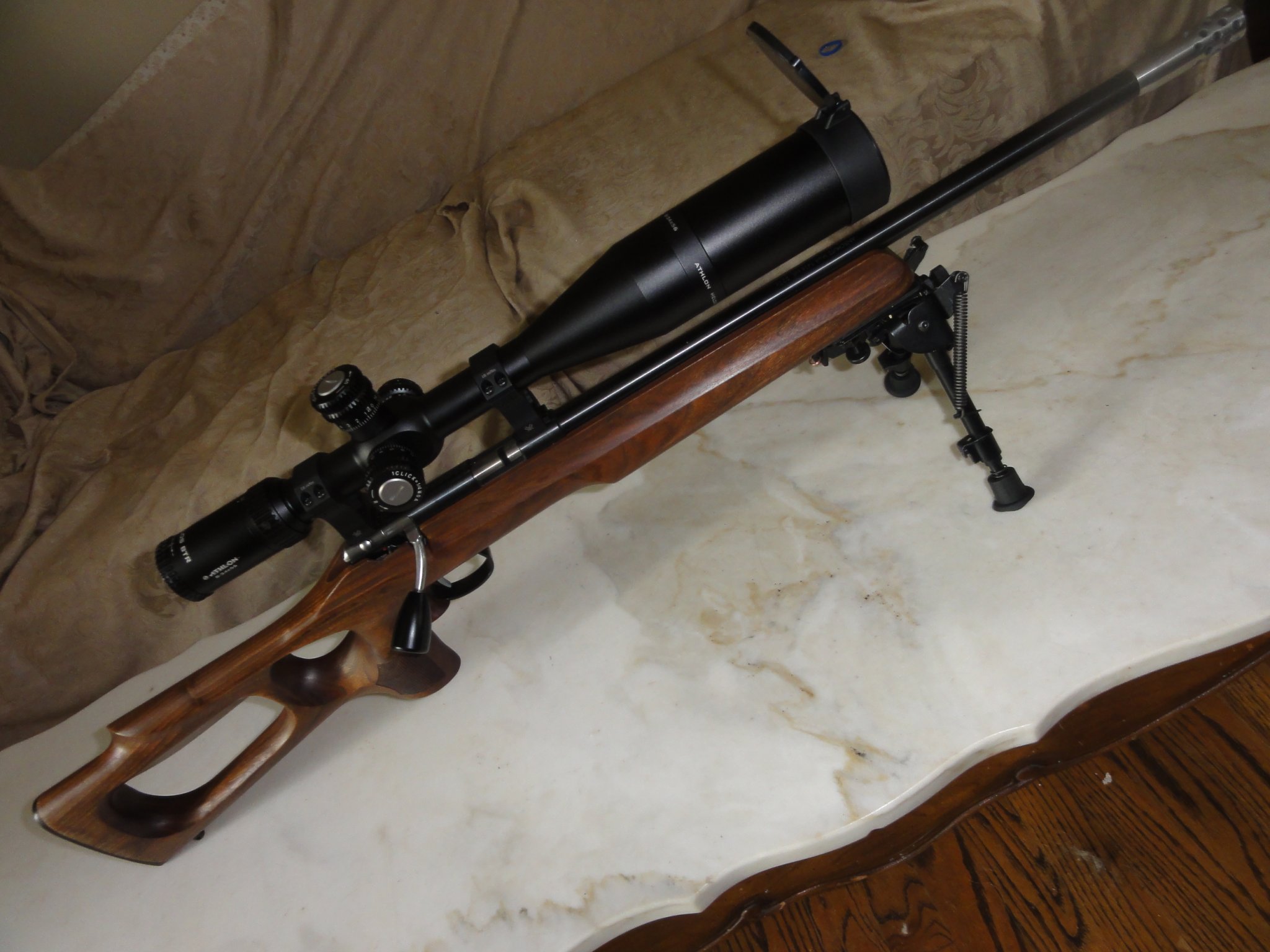

Both guns are about six months old now and they are all set up. Minus the scope, I think I have
1230.0 into the CZ and 4460.00 into the Vudoo. Keeping in mind that I have 20 mags for her and a real Atlas bi-pod and she is totally loaded with weights now. In fact, with scope she is 18 lbs. I went all out on my Vudoo as it will be a one time / lifetime purchase. BTW.... they have a lifetime warranty

If you manage your hold and trigger control, I can hardly imagine that the CZ would fall short of your needs. BTW..... I shoot SK red out of everything I own. It is 65.00 a brick from Target Sports USA.
Hope this helps....

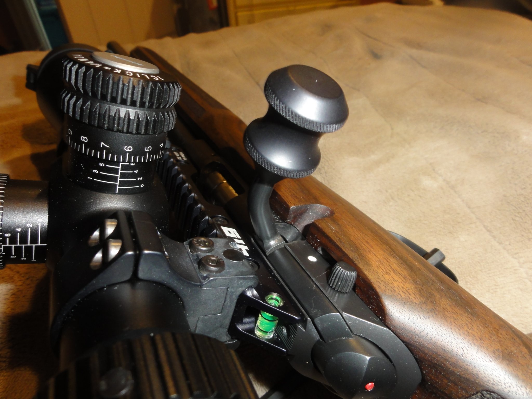

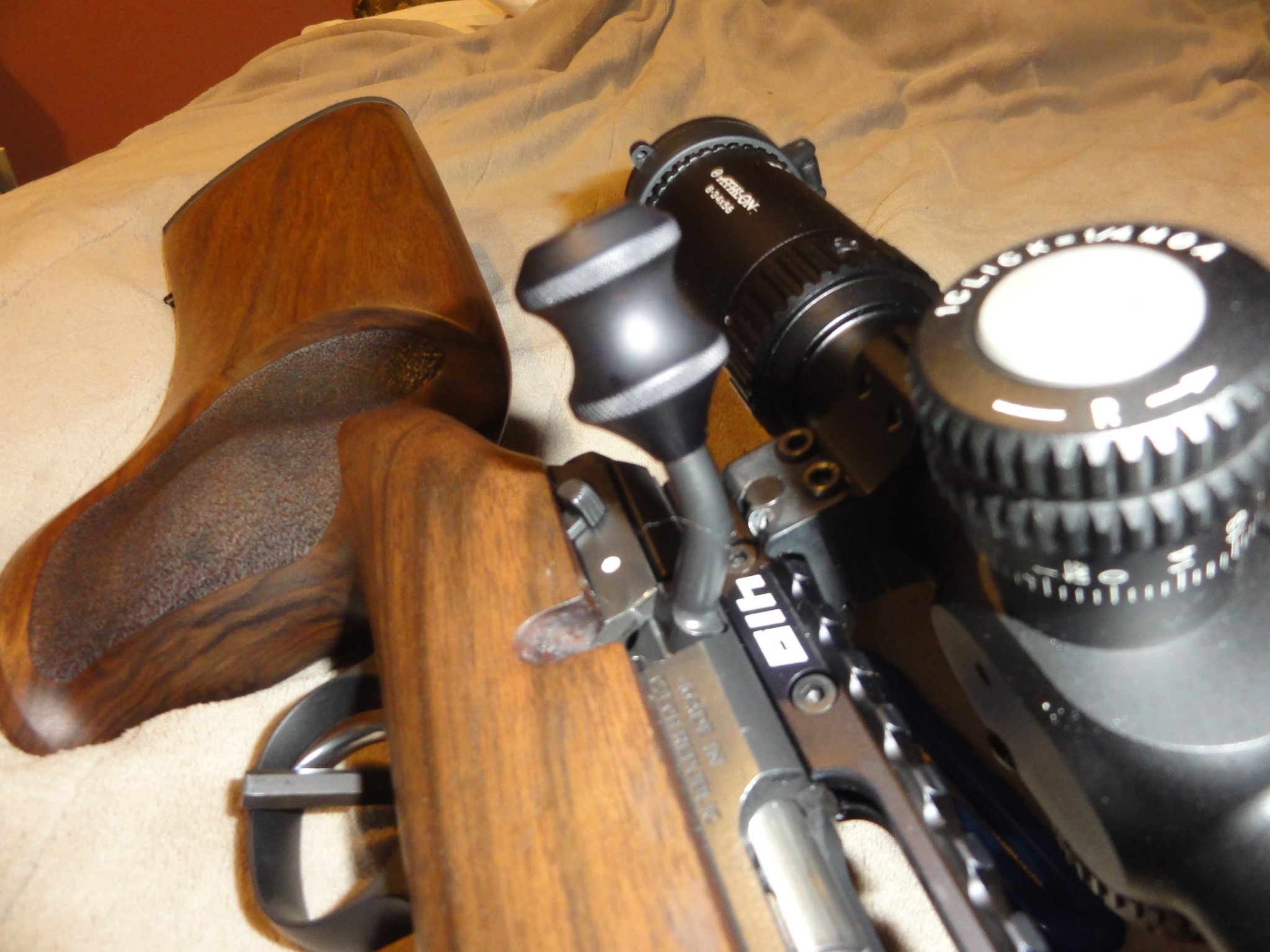

Hello MJ,

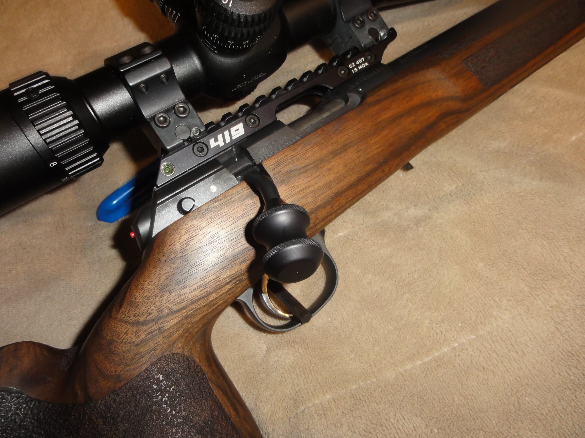

This is the AREA 419 bolt knob. I had my doubts about it because of its peculiar shape but after a very short time it felt fabulous and exactly what the CZ needed. I would go so far as to say, that if you bought it and didn't like it, I would pay for it.

Hello MJ,
at does look slick. That’s about as good of endorsement as you can give. I will check them out. Thanks for taking the time to respond and post pictures.

As I recall, I applied a little heat and used an old leather belt to wrap around the ball that comes on the CZ and used some Vise-Grips to unwind the ball. For reassembly, I used some low strength purple Loctite.
I only screwed it on enough to cover the threads on the bolt. That gave me the best leverage and feel.

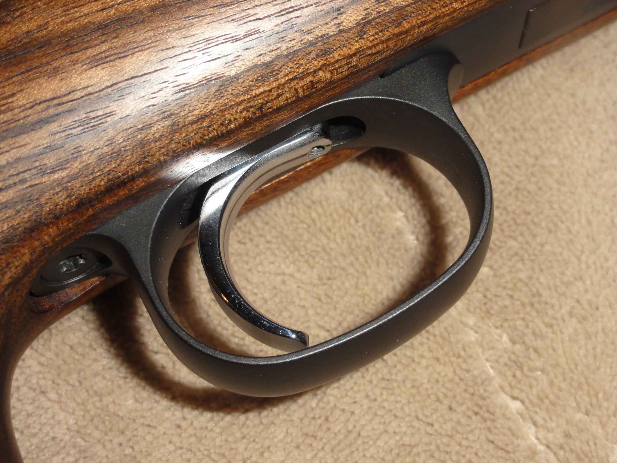

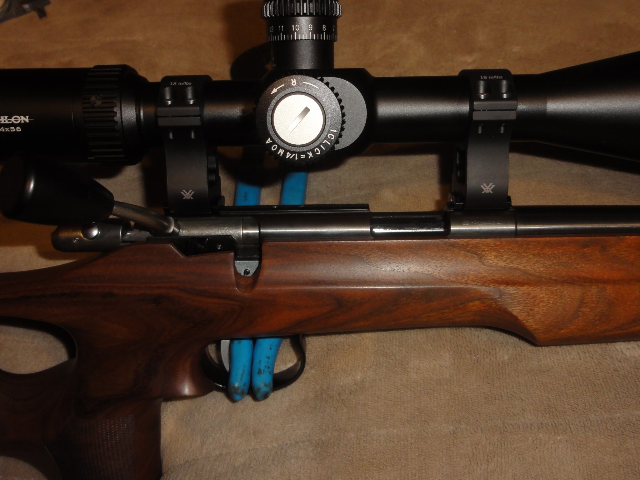

I'm going to look into getting a CZ Royal. Here are two of my Annies. They both have the 5098 6 oz. triggers.
The top one was 1650.00 and the lower, 1150.00. A ten round magazine is about 100.00 as I recall and the mag release just sucks to operate. They both have good fit and finish except for the cheap bent sheet metal trigger guard. the last photo is of the much nicer CZ 457 MTR guard. If I could go back in time, I would not
both of them and very likely neither of them. Another issue is the action itself. It does not operate in a fluid motion. And the butt plates are hard plastic that slides all over my shoulder. I also replaced the plastic round bolt knobs with DIP knobs. And DIP just mad some special scope rails to accommodate these 64 actions. ( not shown in these old photos )
