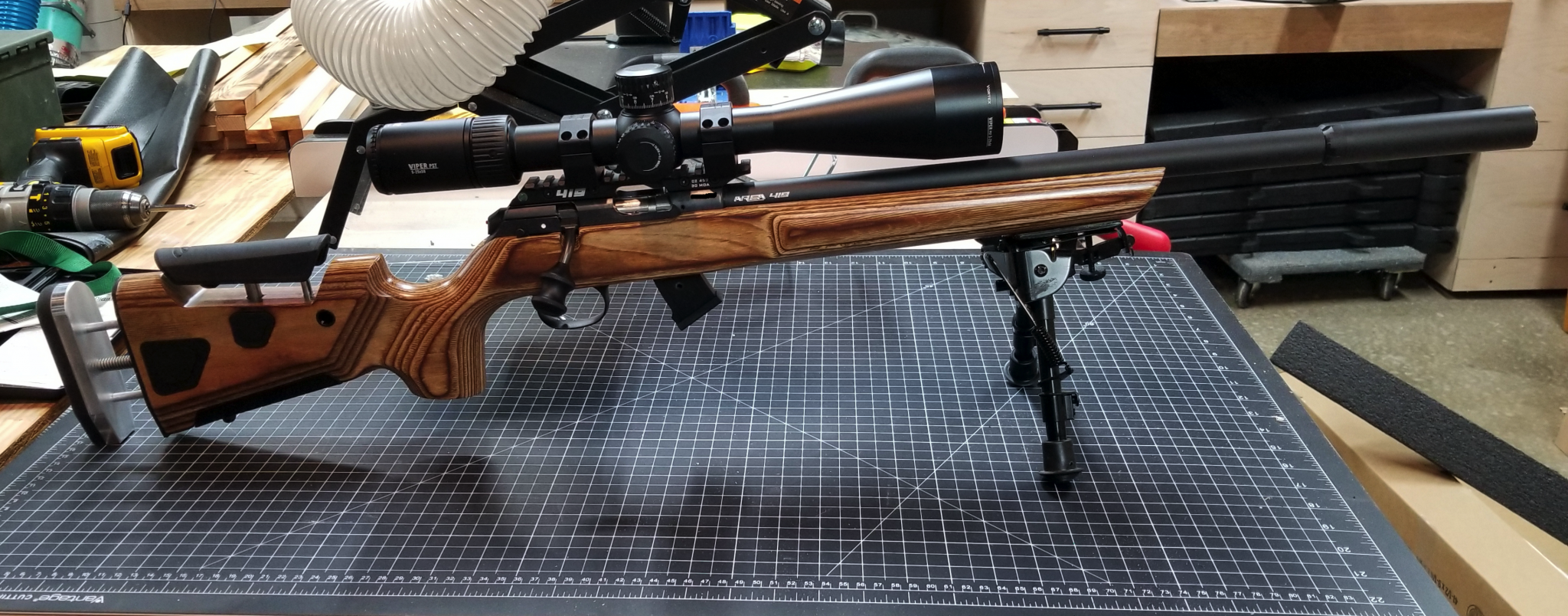

Mine also tight fit I like it. I GOT MINE DIRECT FROM BARTLEIN ITSELF CUSTOM CONTOUR AND LENGTH. sorry if I jump off the topic.just share the brother barrel of yours.
