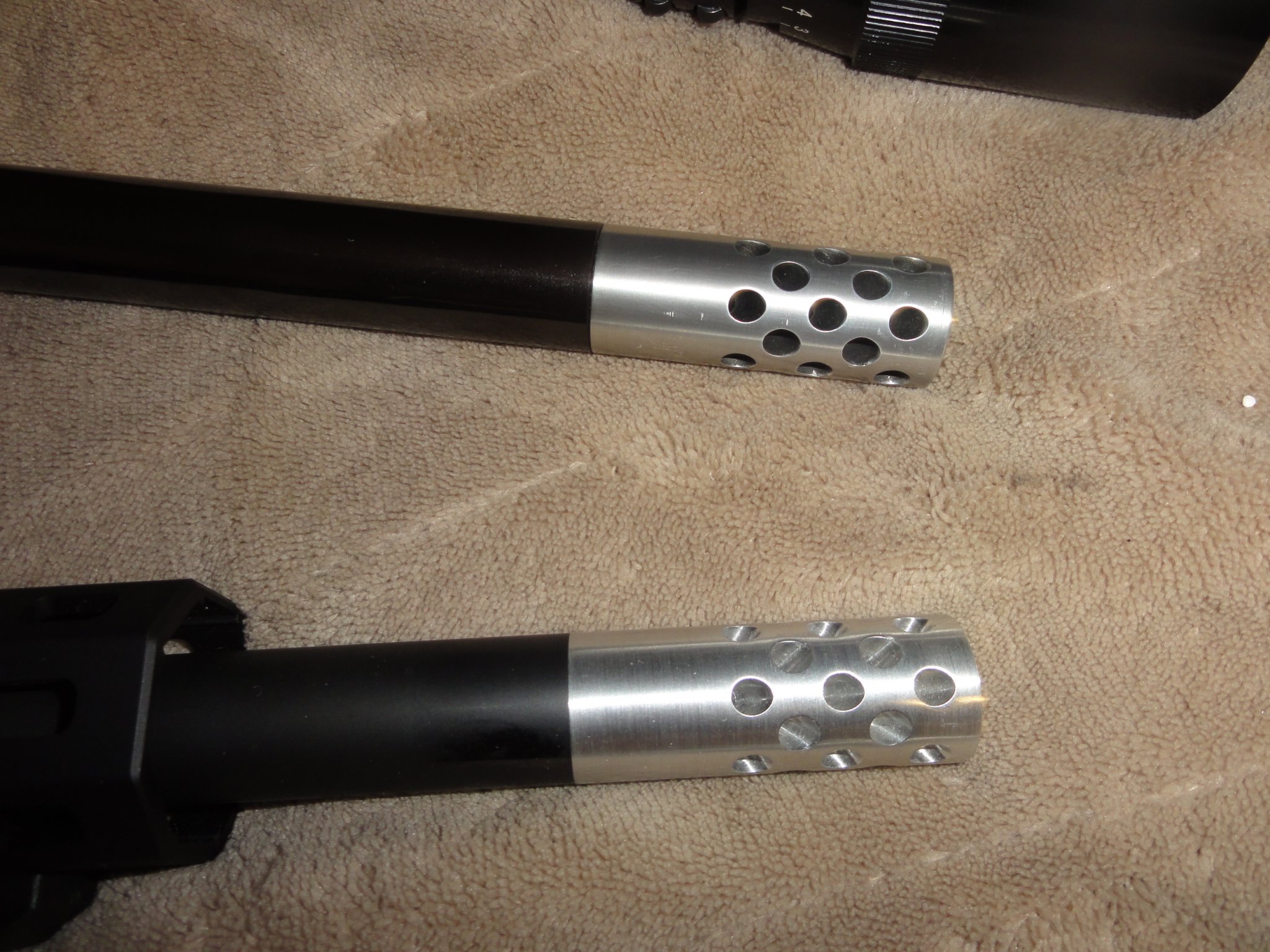

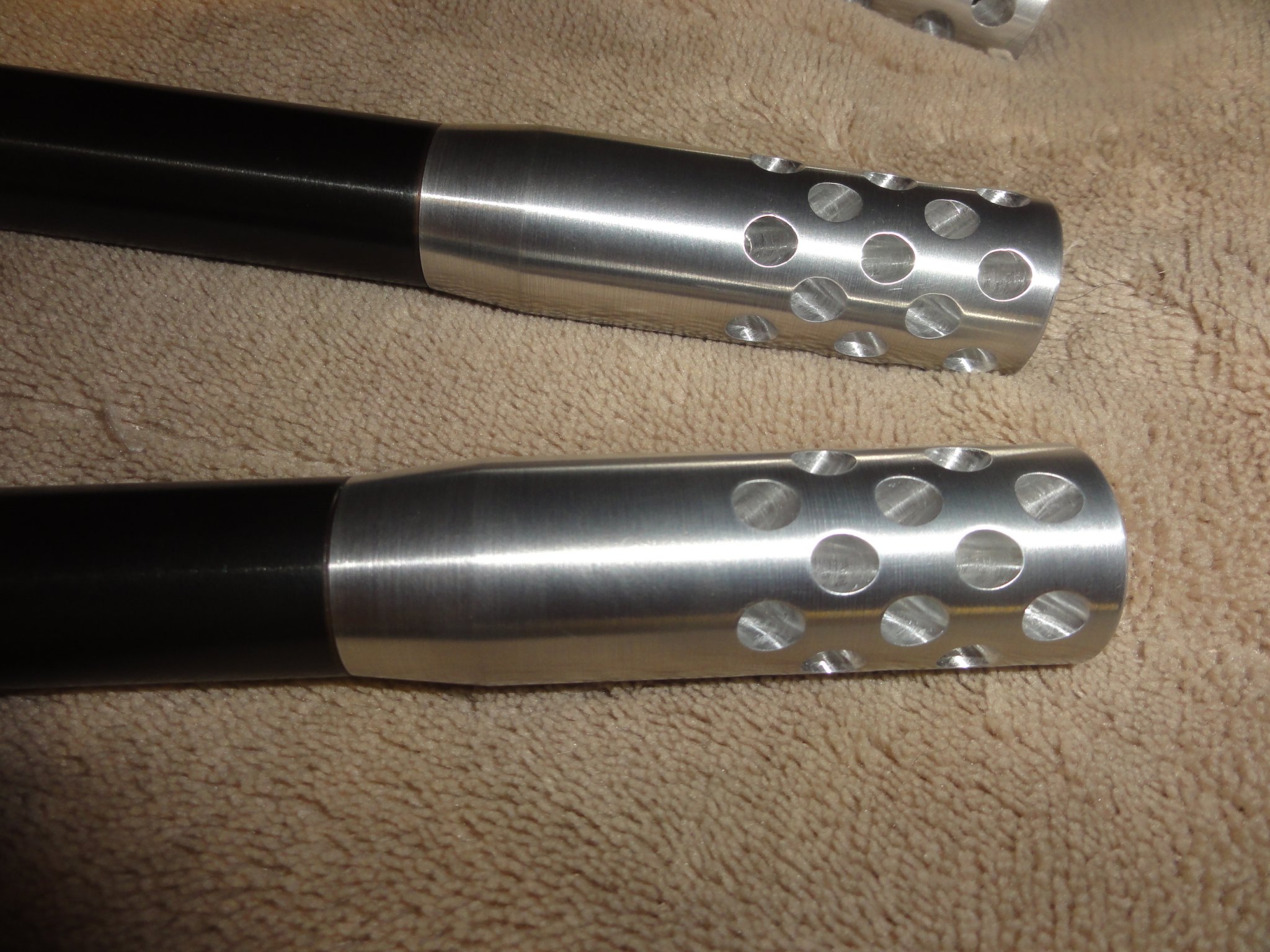

How far back is the choke on your bbl. I would hate to see it cut off by accident. I get my brakes for 35.00 from a guy on evil-bay. They were both customs for my Annie's and Rugers.
I’ve got room to cut and rethread, was just trying to avoid that if possible.
419 doesn’t offer that thread pitch anyways.
brakes look good but I’m wanting a different style.
Thanks!
