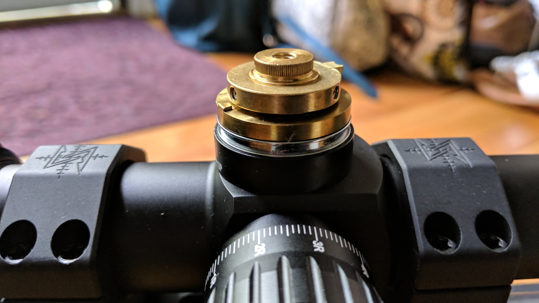

I read a review on the BTR with the upgraded turrets that said it also had stainless internals. Can anyone confirm this? I searched but couldn't find an answer.

This is what the elevation turret's guts look like on my Ares BTR with the turret secured by a big screw in the middle of the turret. The recess in the steel section is where the o-ring is from the factory. The functional parts look like brass.
I went and zeroed my rifle with the Ares BTR today then came home to reset the elevation/windage. I can confirm the picture above. I set the zero stop which was really easy.
