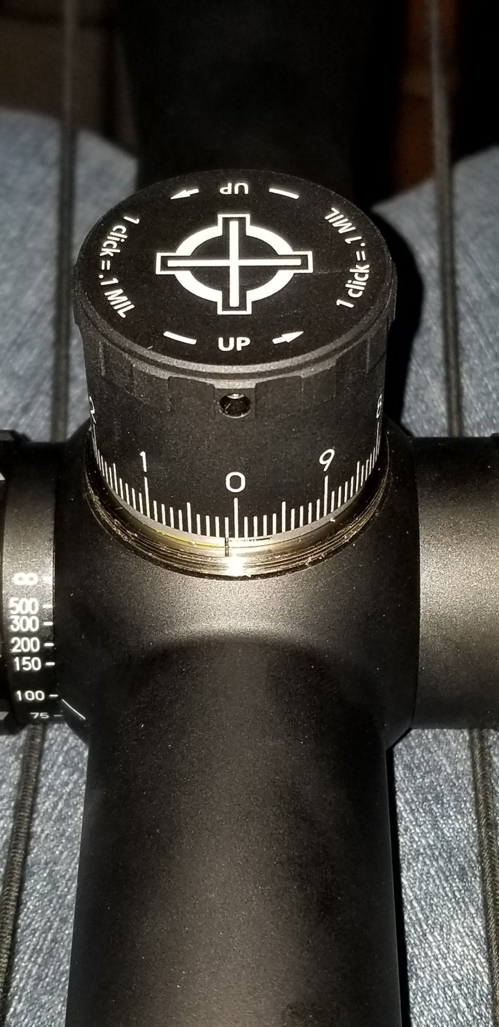

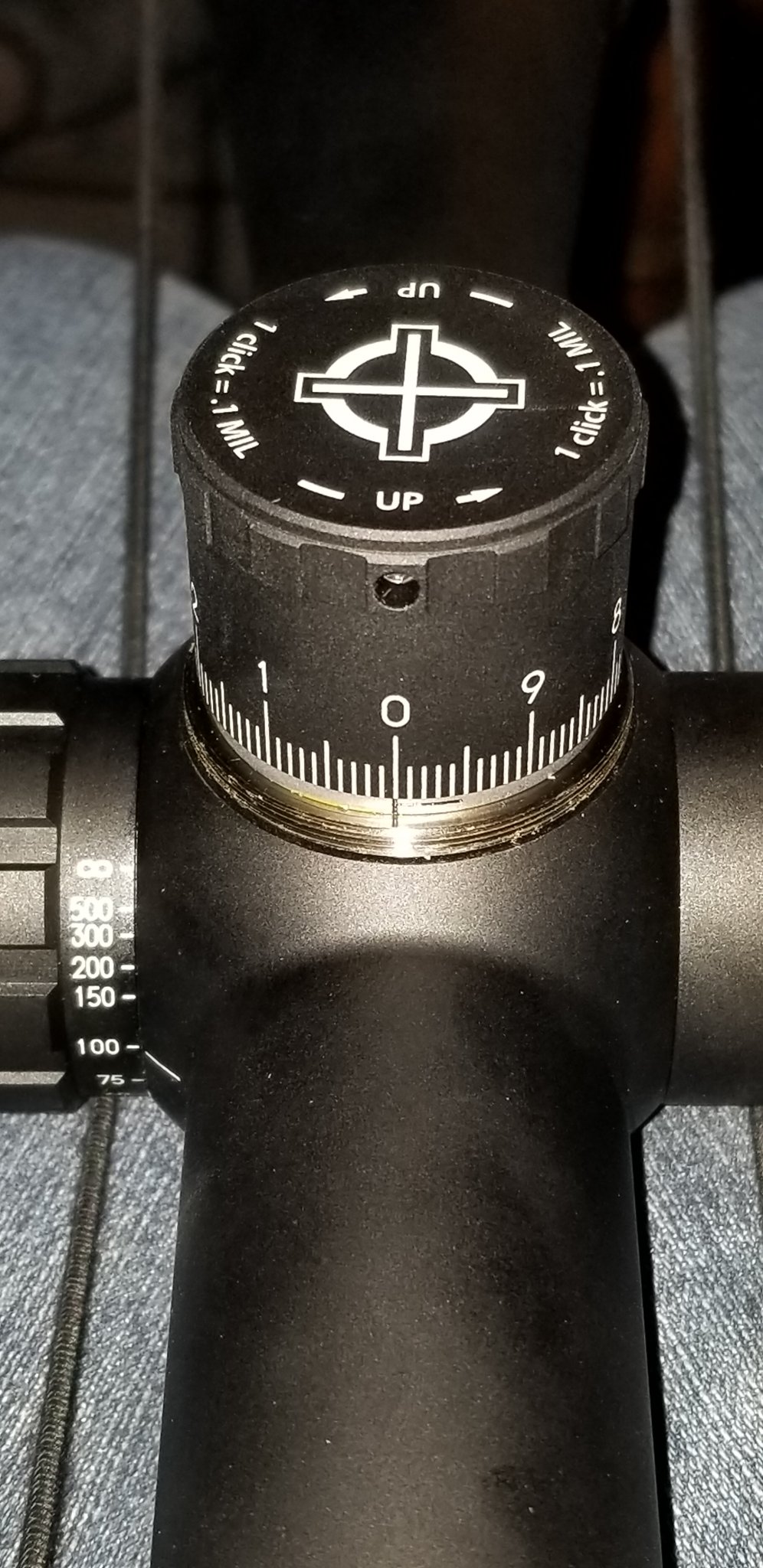

But then I found the Sightmark Pinnacle 3-18x44 for $547 (give or take a few dimes) shipped. It arrived today and I'm very impressed with the glass clarity and feel of the turrets (of course I can't really comment on it in real use yet).
However, the elevation turret is misaligned by one click. It isn't that the markings on top of the turret were applied incorrectly, the turret itself was installed one click off center. It may not be functionally an issue, but I'm anal about such things so now I either send it in for warranty repair or wait 2-5 weeks for Amazon to get another example in stock.

Perhaps I wasn't clear, the static rev indicator ring (see silver at bottom of turret) is installed off center. No amount of adjusting the turret or zero stop changes where the static rev indicator ring on the turret lines up. Placing your zero on the static rev indicator line will always result in the zero being one click off to the left from true dead center. It may not bother some, but like I said I'm anal about such things.
Edit: Sightmark said that it needs to be warrantied and I'll get a new scope.
Edit: The plot thickens. Amazon won't have any additional stock for 2-5 weeks so they just offered me $100 off the scope to go with the manufacturer's warranty option.
Ok, I see it now. That would bother me too.
Reactions: Cotay
