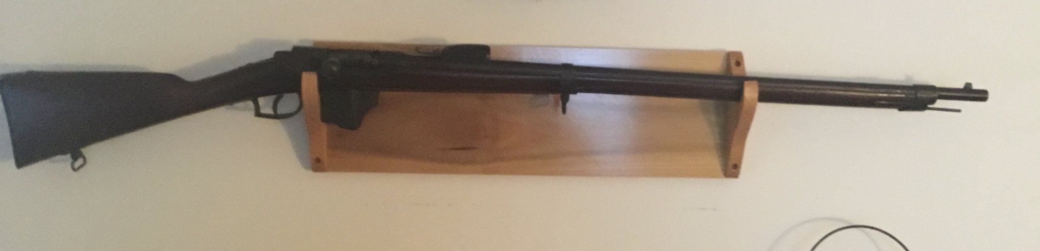

Once upon a time my mother purchased me an old, bolt action, black powder rifle for Christmas (I had asked for an old, none shooter double barrel shotgun). So, figuring I might actually want to shoot it, i went to the “gentleman” who sold her this rifle and asked if he was sure it was a Mauser and fired an 11mm Mauser round. He became quite belligerent. So, not being able to afford the dies, brass, bullet mold anyway, I put the thing up in a closet and there it sat for decades until I made a rack for it and hung it up in our den.
The rifle, as I was to learn was a Bertram Vittali, not the slightest relationship to Mauser and fired an 11.3x50R Beaumont M71 round that did not even resemble the 11.15x60Rmm Mauser.
