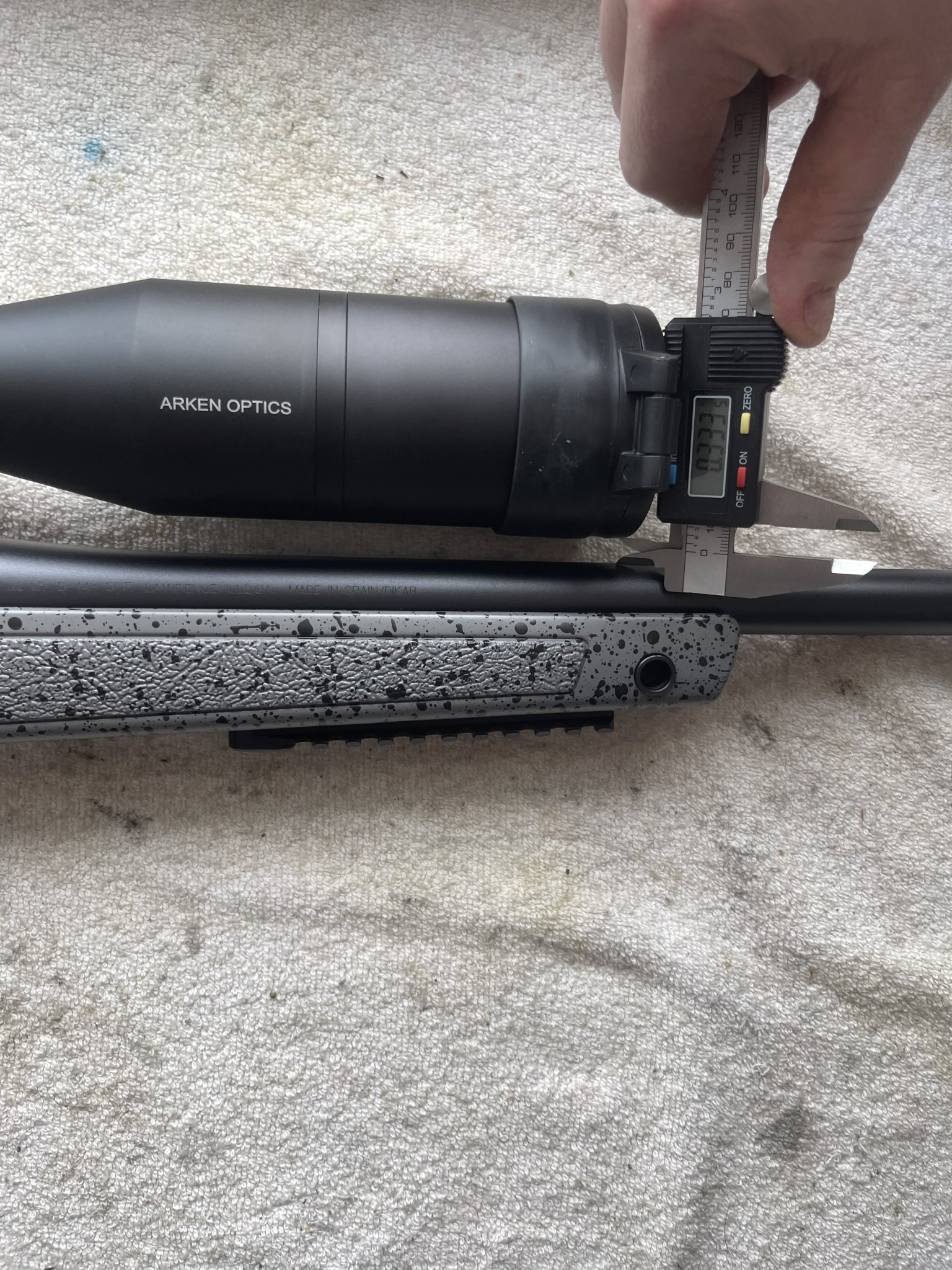

    Don’t have an Arken yet, but have a 5-25X56 Vortex in 1.060” height rings on a 40MOA rail.
    This will give you an idea of needed scope height for zoom ring and scope cover clearance:

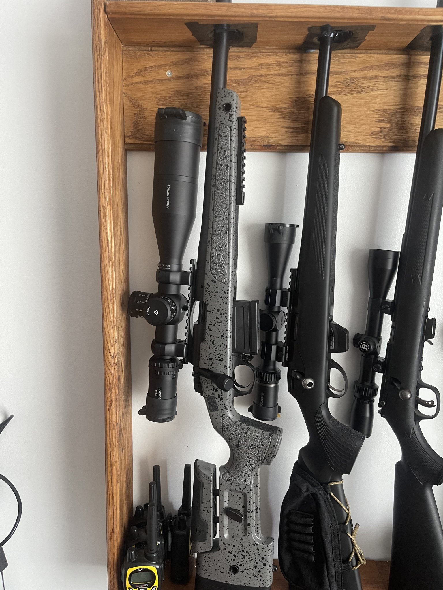

    This will give you an idea of needed scope height for zoom ring and scope cover clearance:View attachment 8030786

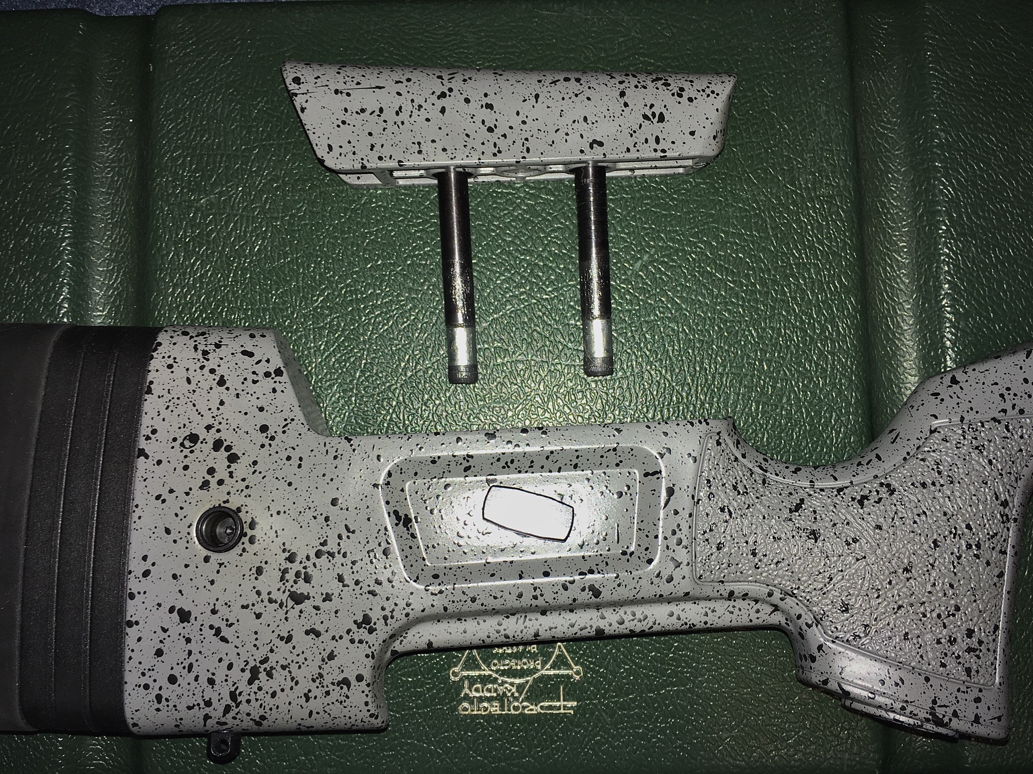

    Should add, if you go much higher on the factory stock, check the rods on your cheek piece. On my HMR stock they were threaded, and I was able to add screws and spacers to increase cheekpiece height.

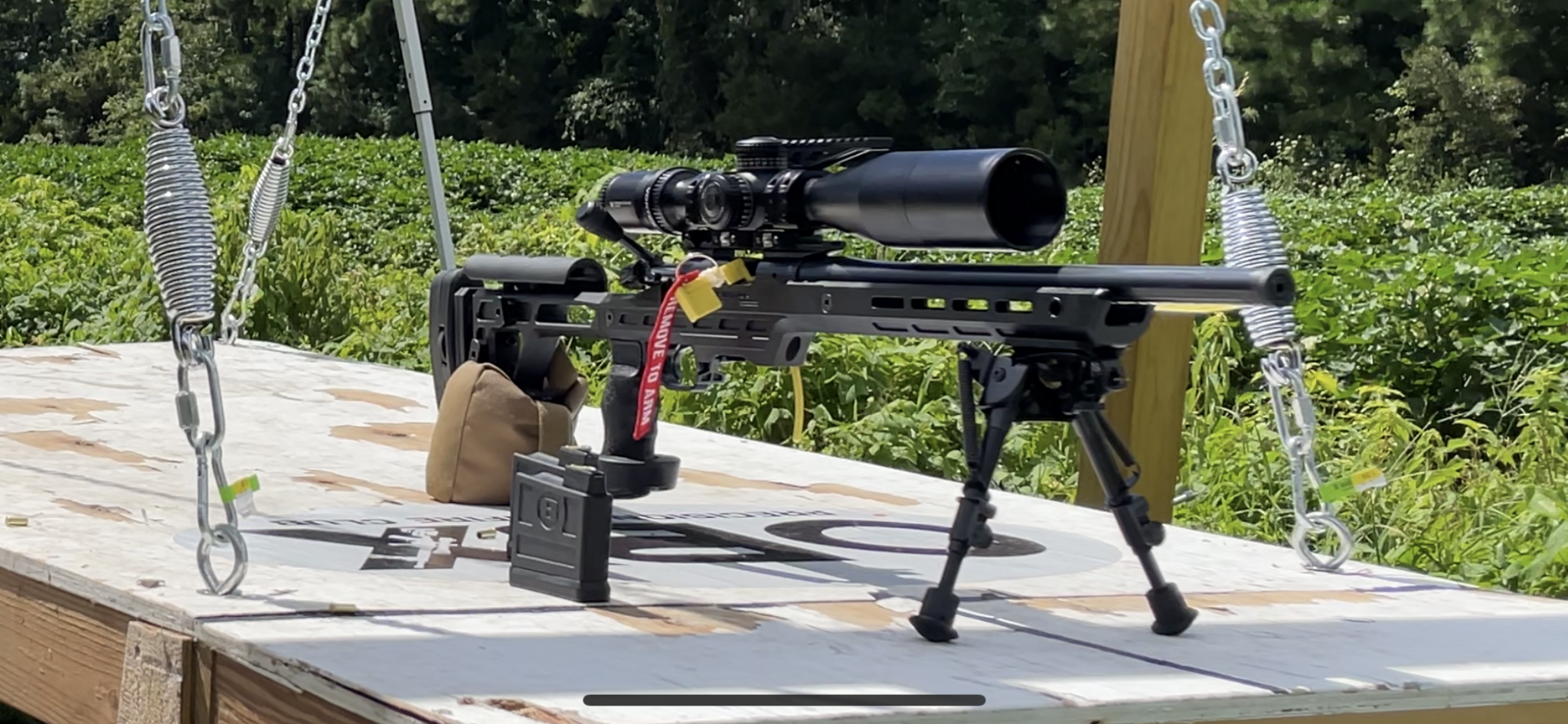

    I have an ep5 on a 457 mtr with an area 419 30 moa rail and have the low and it is fine, but should have went with mediums. I do not have an adjustable cheek riser on mine so better lower than higher.

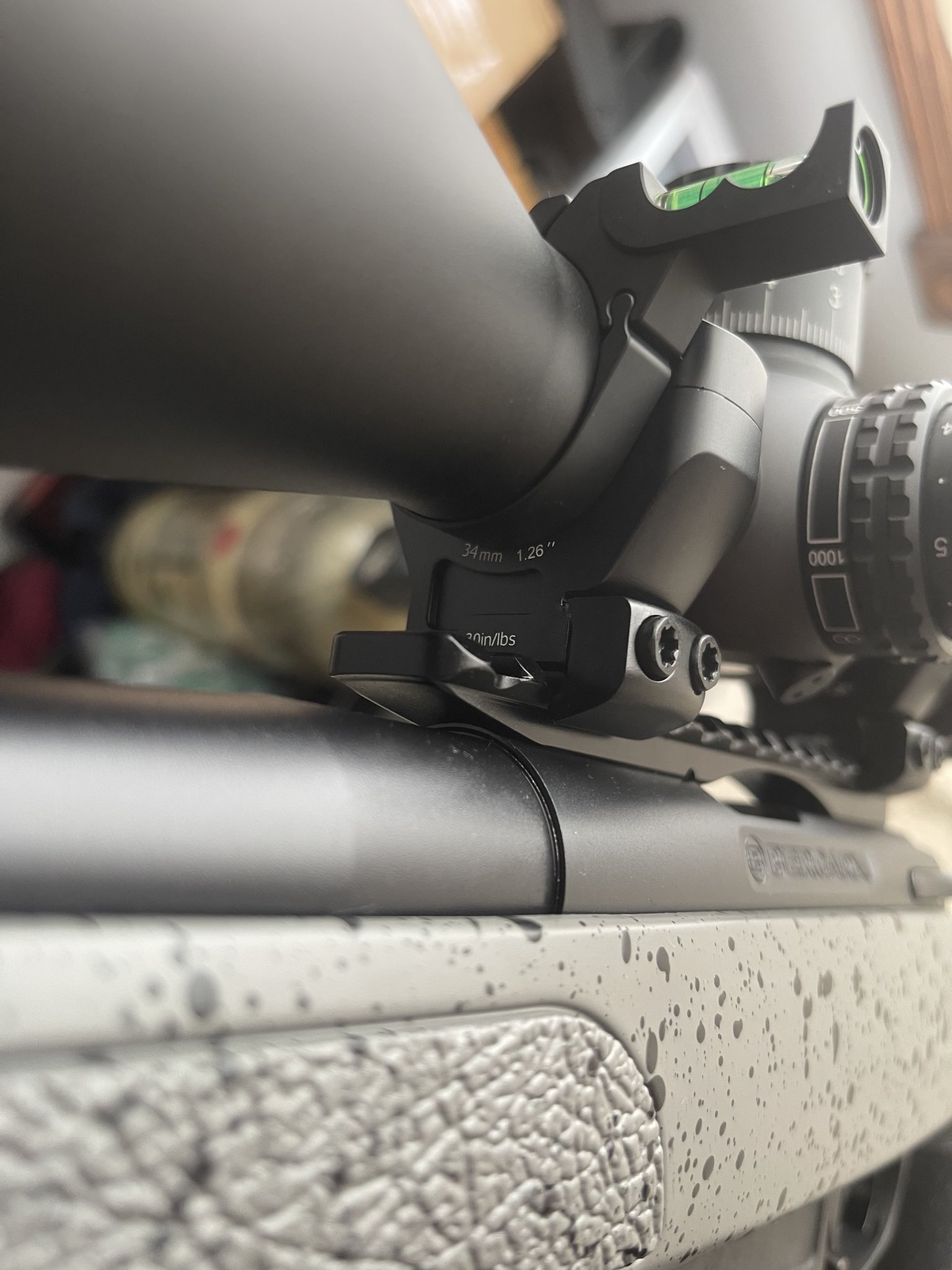

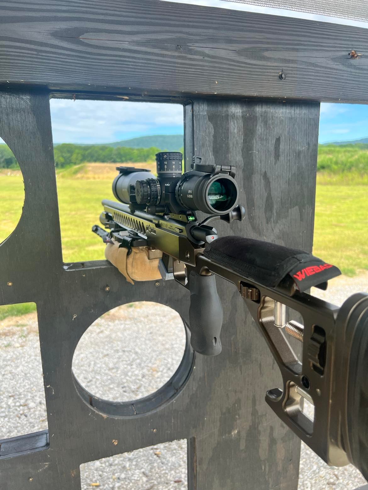

    I have an EP5 on my 457 VPC, needed the medium due to the scope flip caps. If I didn’t have the caps, the low would’ve had it barely above the barrel
    I have the same setup and that’s as good as you can get it with Arken rings. BTW which bipod rail is that?
    I believe 419 but I can confirm later. I put it on last year just haven’t had time to get around to using it much yet
