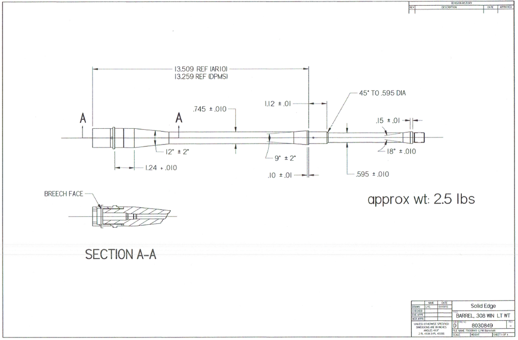

I am sorry for wasting your time, but I have looked and looked for a top of the line barrel to go into that darn AR 10 and everyone seems to be doing DPS.
PLEASE HELP ME AS I AM ONE LEGGED AND WALKING IN CIRCLES WITH THIS ONE.
Craddock is the only guy I have found that will cut one.
With Respect,
Alvin
Fulton and Lilja usually carry them as well.

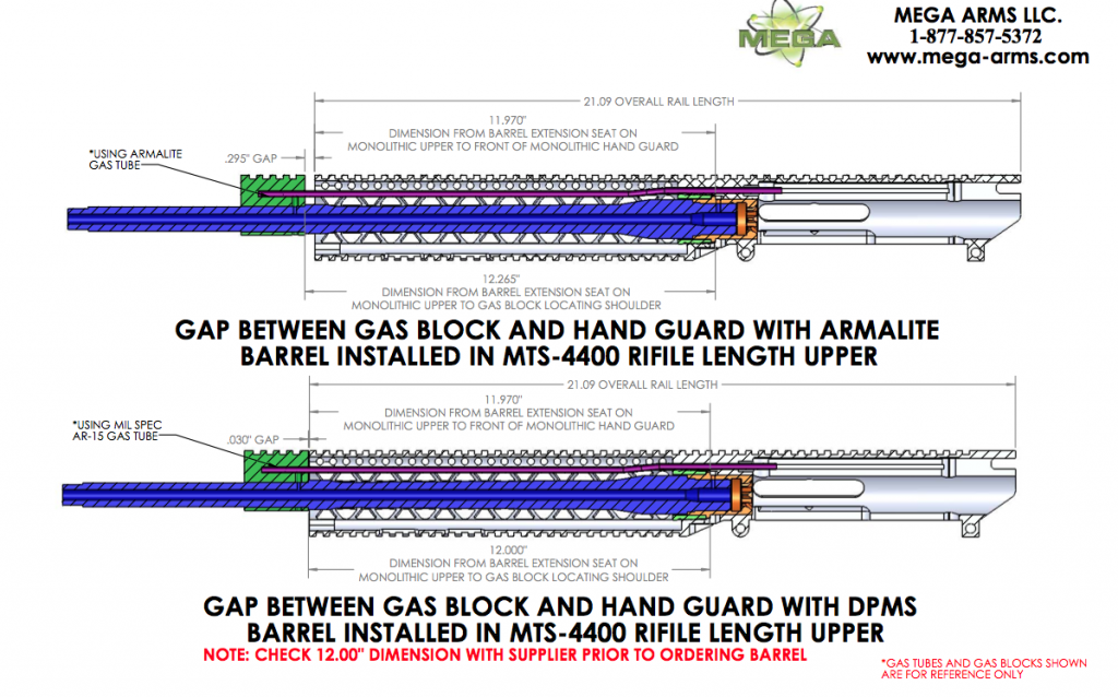

I just go with the AR308 pattern and use a shorter M16 gas tube -- but then you have to use a shorter rail or float tube. They're more available.
The difference is a quarter-inch:
