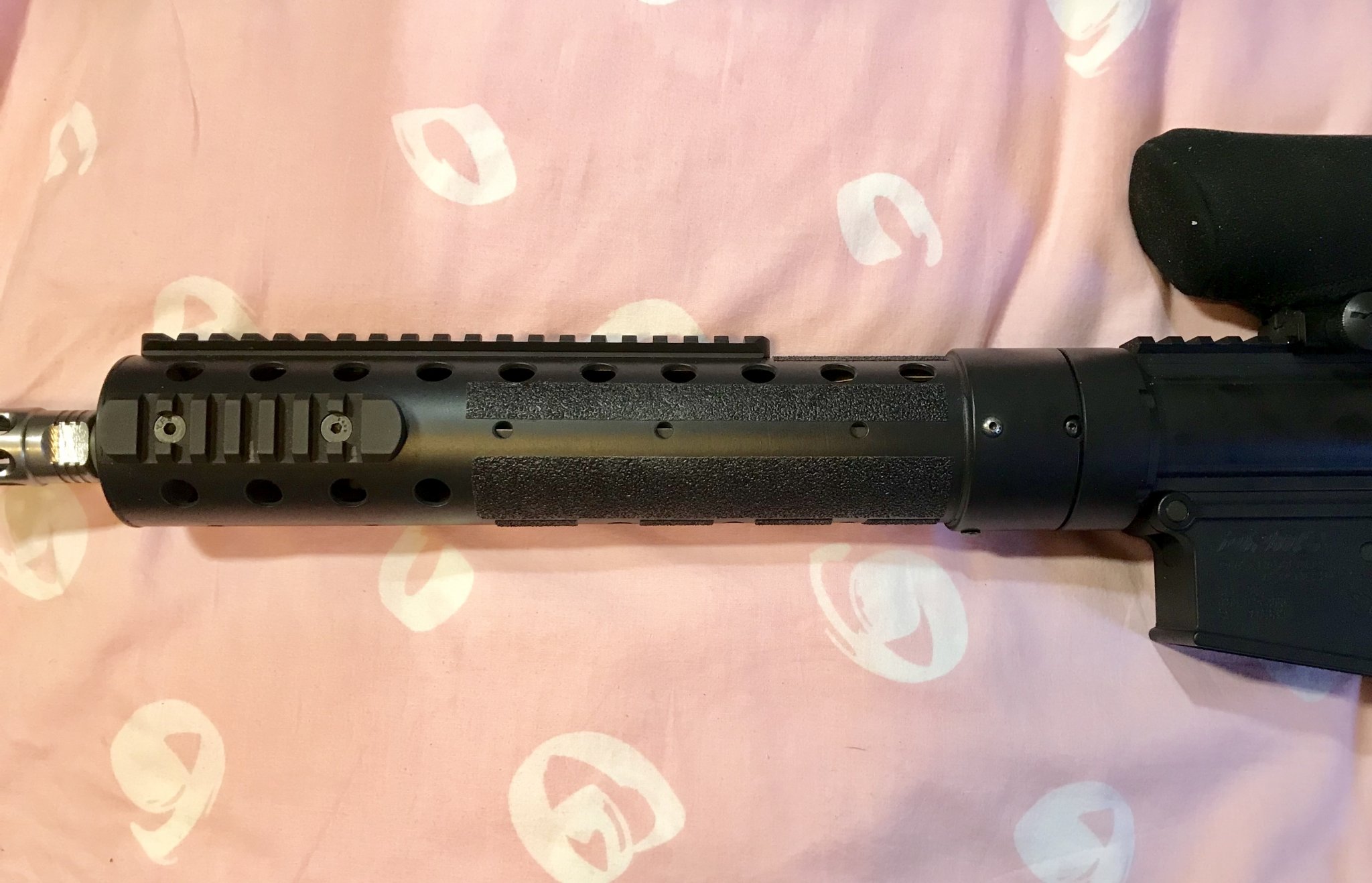

    The Armalite key mod is very well made, it locks up tight and it’s light weight and narrow. This one pictured is an A4 that I had the barrel chopped to 16 inches. I have one on my T too but I had to have the barrel turned down at the gas block because the .875 low profile gas block would just barely fit under the rail. I wouldn’t want any other hand guard on them, not a Geissele or a KAC even if it would fit. They are really that nice....
