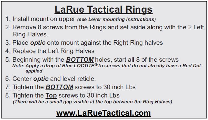

Which Larue mount ?
I ask, because the "Vertical Ring" ones MUST have the bottom screws torqued first and snugged with about 30 in/lbs equally , then the top ones. Mark LaRue confirmed this at one point in time.
Failure to do so can create "loose scope" issues.

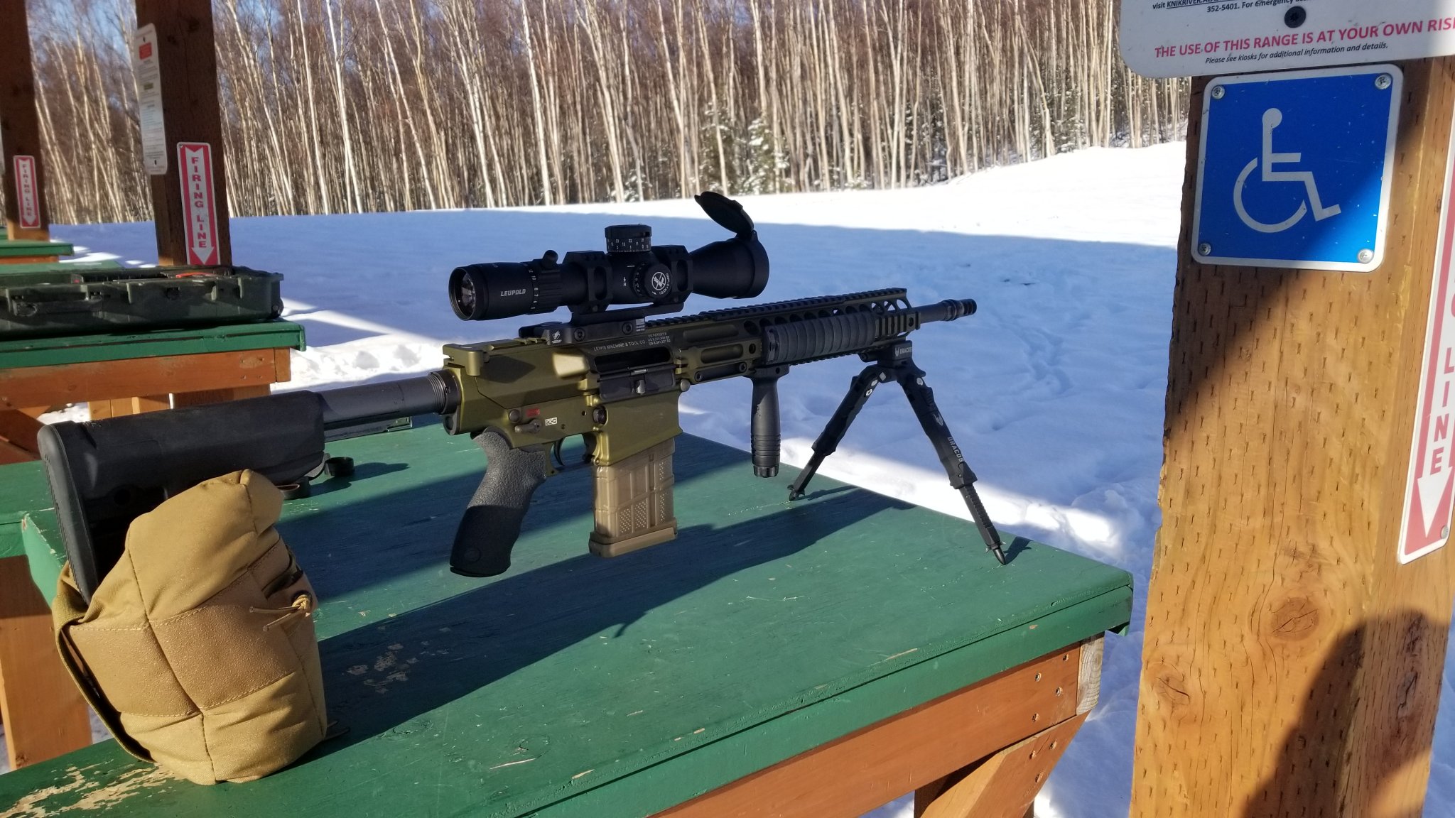

I had a super sass years ago for about 6 months. It was consistently a 1.25-1.5 minute gun at 100 with myself and other, better shooters. I sold it to buy an LMT MWS.
I did the same thing but with a knights sr25 as Nn8734 did with his armalite sass. Couldn't get the thing to function reliably and it wouldn't shoot under a minute to save its life. I sold it a d bought a South American lmt mws and I'm in love. It's been shooting. 68-.80 all day. If you feel unhappy with the performance sell it and a look at lmt, there are great deals on them. ?

I’m also strongly considering a MLOK MWS in 6.5. While I love my SR25 (being converted to a K1) the LMT is the best value hands down for the money. Most shoot 1 MOA or less without trying with factory match ammo (hand loads shrink this even further). The newest LMTs also don’t have the back pressure issues that the first gen was known for so most well made cans should play nice with it.
