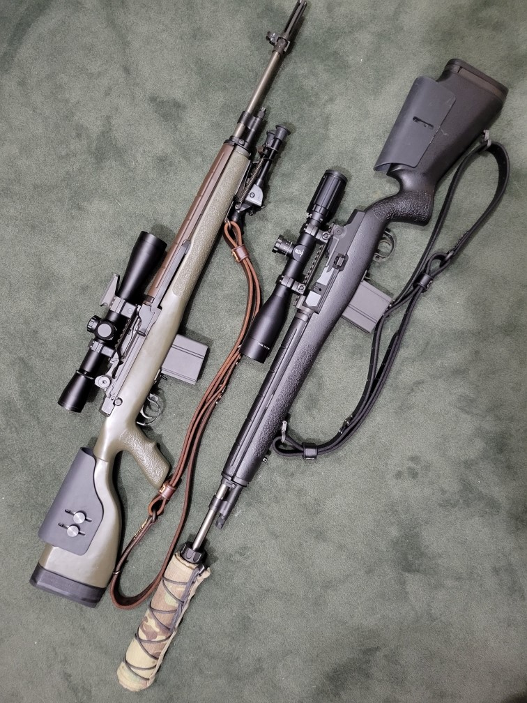

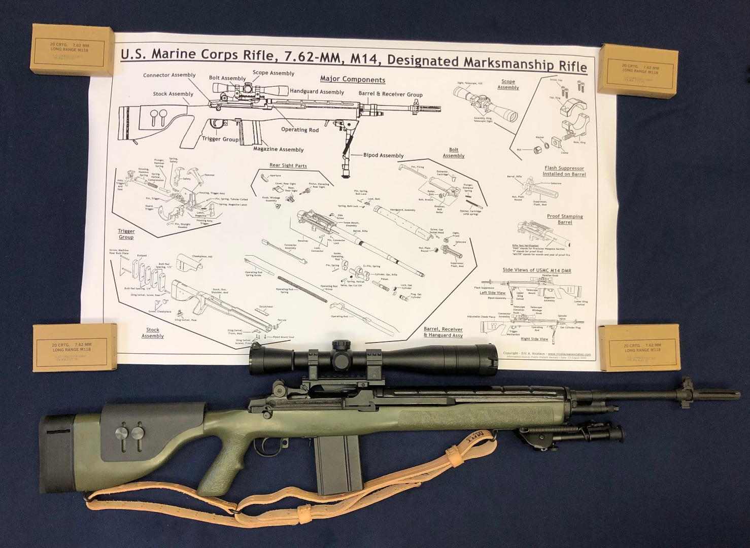

I first saw Army M14s during the early GWOT era. Vowed I would own one someday.
Well....today is that day.
"Surplus" everything with the exception of the SAI receiver and the Krieger heavy. All parts are TRW and modified as needed to meet the original build specs for these rifles (welded gas system, trigger job, NM reamed FH etc)
Barreled action done by a Navy friend who is at the top of his game. Stock work, trigger work and fitting done by the man who knows these better than anyone. I was honored to be able to do some of the grunt work with the files and paint along side him. Talk about a learning experience. What 'smiths charge for working on these isn't near enough. You don't realize the work load until you're several days in....and it still isn't done. Amazing stuff.

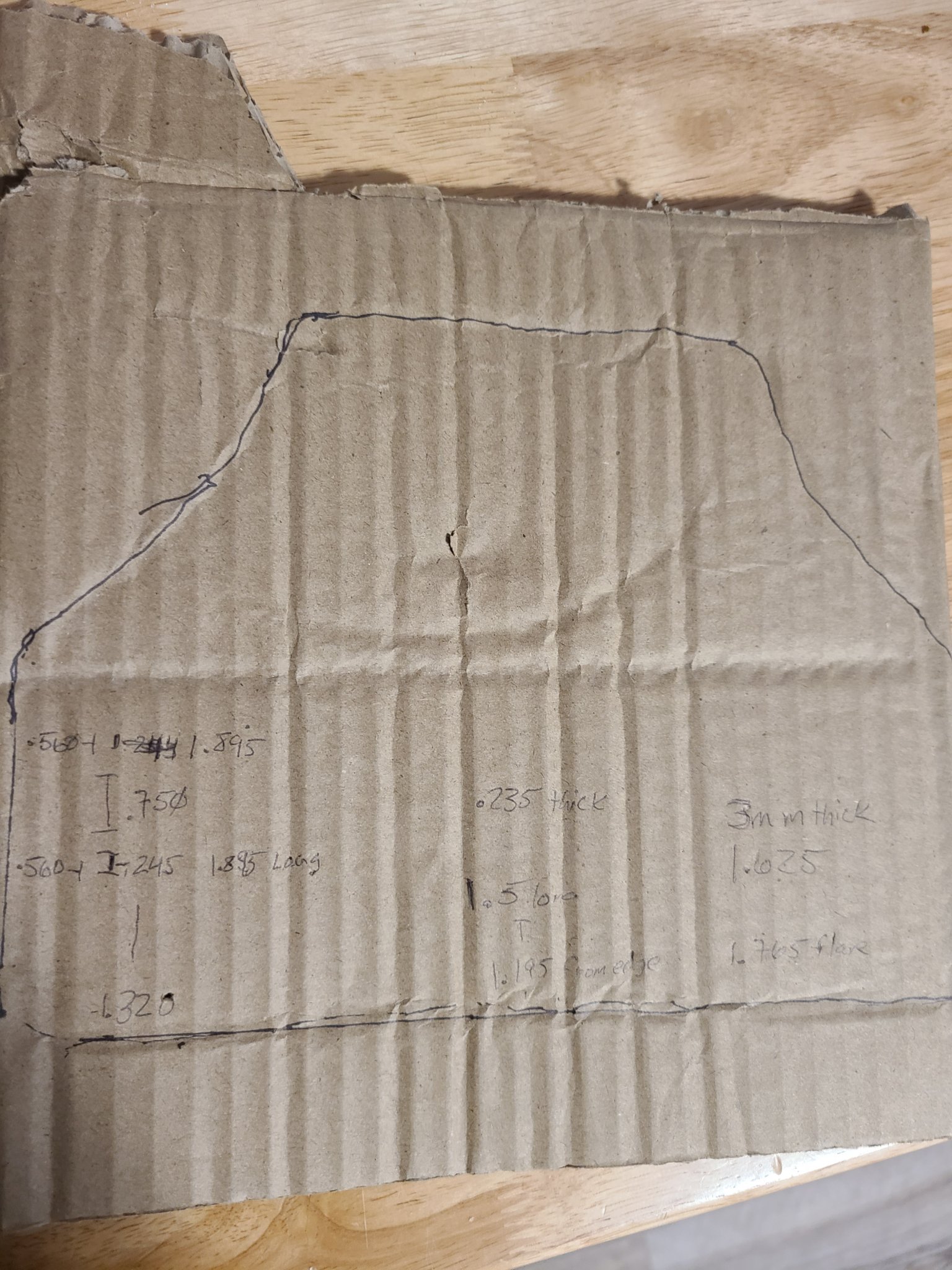

As a side note- I am searching for one of the cheek pieces for these. If anyone's holding, or has a lead, please DM me. Don't care what it takes......
2 hole cheek piece as shown below

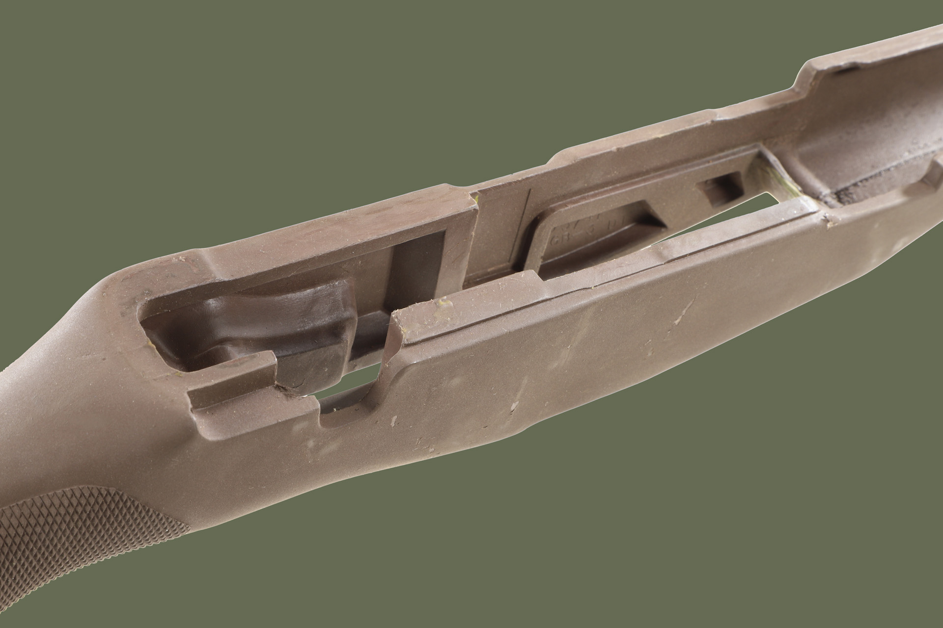

For those who don't know the history, I think 36 such M14 DMRs were made for the Iraq War by a Washington state NG unit. I call them the "final M25" rifles used in combat.
A few of the Army Reserve Shooting Team guys from Pennsylvania and the Guard built a LOT of "M25-ish" DM builds on former National Match competition M14s for deploying units. Nobody knew how long GWOT was going to go, and everyone deploying wanted to make sure if they were going their stuff would be right.

I'll fab one worst case. I have access to a real one.
You could always just drill some holes and paint the butt using that as a stencil -- just like the rifles of Joes who lost the damn cheek piece! 😃

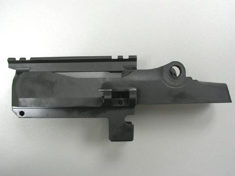

One anecdotal about these Washington state NG 'M25' DMRs. I was told that by the NG armorer is that it was somewhat difficult to get US Army permission to make these accurized M14-based rifles back in 2003. He apparently made the case to those in charge that the USMC DMR rifle (which had an NSN and was built in 2000-01) was a 'standardized configuration' for an M14 DMR rifle, and the rifles he proposed building used the same basic configuration, but minus the welded-on rear lug that the USMC used. (Seems doubtful a welded-on lug would have been approved).
I seem to recall that he said that using a commercial barrel was also an issue at first, but the USMC used a Krieger SS medium weight barrel on their DMR, so the armorer argued that Krieger barrels were also an approved item with an NSN for a combat weapon, so he was able to get permission to make them along the lines of the USMC DMR variant. At least that is my understanding. Here's my example of a USMC DMR replica with a poster:

Technically true -- Problem part 1 was copying a Marine or Navy pattern (welded lugs), not safety-certified by Tank and Automotive Command.

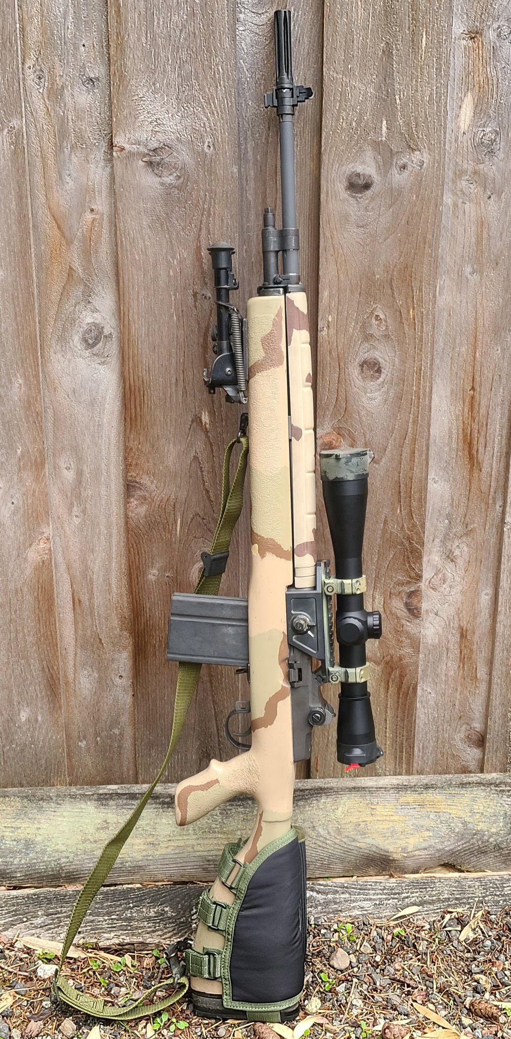

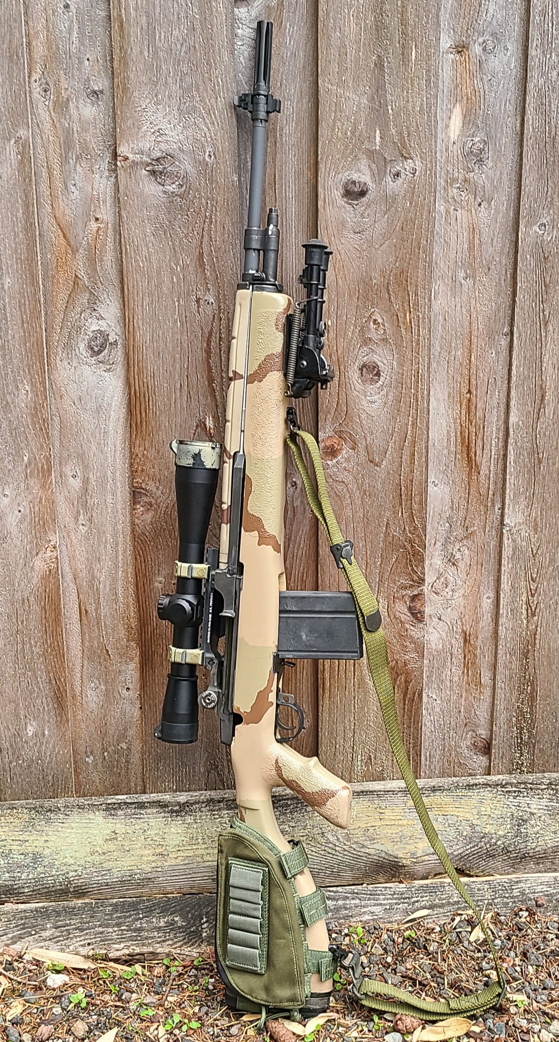

My USMC DMR project still needs the correct flash hider, and my Navy SSR project needs the correct Leupold scope. I know the suppressor isn't part of the SSR, but I couldn't resist giving it a try ; )
My projects are a work in progress, some day I will run across the parts I need...

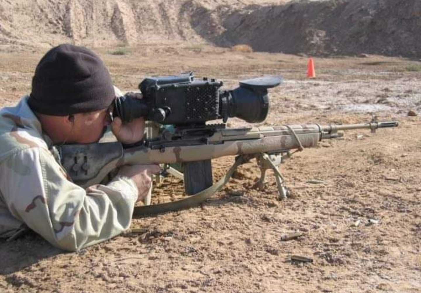

Couldn't they find a bigger night vision scope?
Scopes were bigger back in those days, we can’t bust heads like we used to, but we have our ways. One trick is to tell them stories that don’t go anywhere like the time I caught the ferry over to Shelbyville. I needed a new heel for my shoe, so I decided to go to Morganville which is what they called Shelbyville in those days. So, I tied an onion to my belt which was the style at the time. Now, to take the ferry cost a nickel. And in those days, nickels had pictures of bumblebees on ‘em. ‘Give me five bees for a quarter,’ you’d say. Now, where were we? Oh, yeah! The important thing was that I had an onion on my belt which was the style at the time. They didn’t have white onions because of the war. The only thing you could get was those big yellow ones.
That's an AN/PAS-13B, one of the first thermals you could actually mount to small arms. The "B" version with the big objective lens wasn't normally on anything smaller than Ma Deuce -- but it did give you a better long-range view.
You can see the shooter pushing in on the eye-cup (used at night to keep from lighting up your face). Back in the olden days, for long night surveillance with the PVS-2 and PVS-4 we'd take off that rubber eye-cup, tie the neck of a poncho closed around the eye-piece, and pull it over your head to do the same thing. A little like this:
