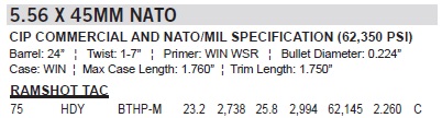

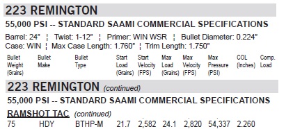

Not really. The Ramshot manual goes to 25.4 gr.
You can push them a little faster than 24, especially in the cold. Try 24.5. From Western Powders 8.0:

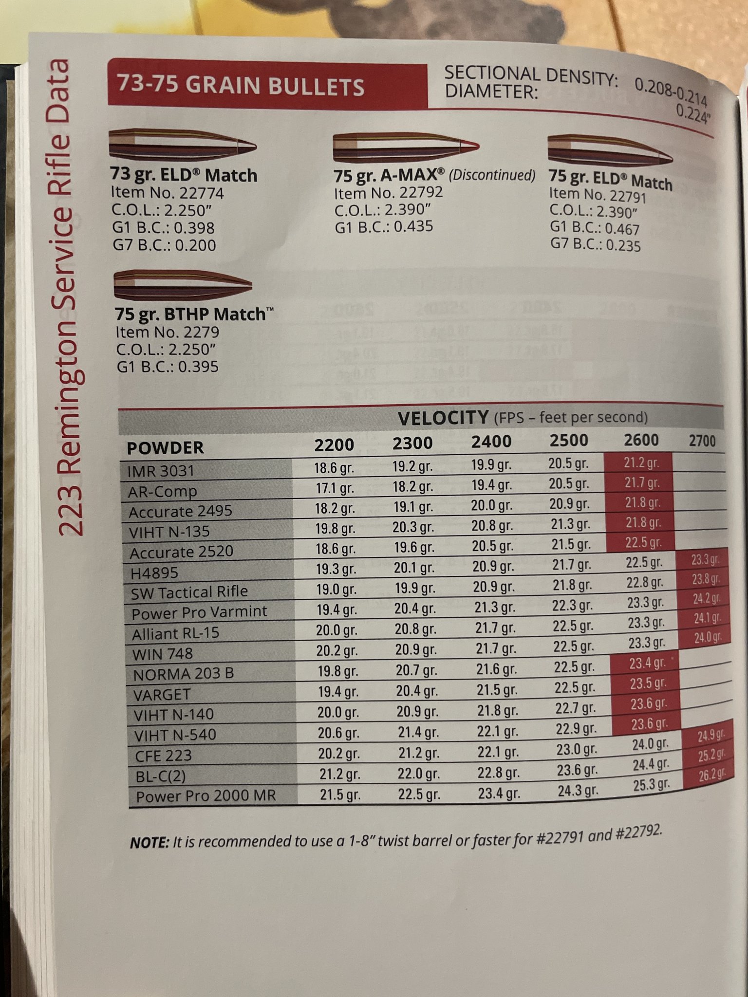

H4895 is a middle burn rate powder and should be fine around 24 to 24.5 pushing 73 to 77. 24.4 to 24.7 pushing a 69 Sierra or Nosler.

I'm loading Hornady 75 gr BTHP with 24.0 grains of TAC - That is a widely accepted charge weight for 70s class bullets. Brass might not last many reloads, but I consider 5.56 fire & forget brass.
