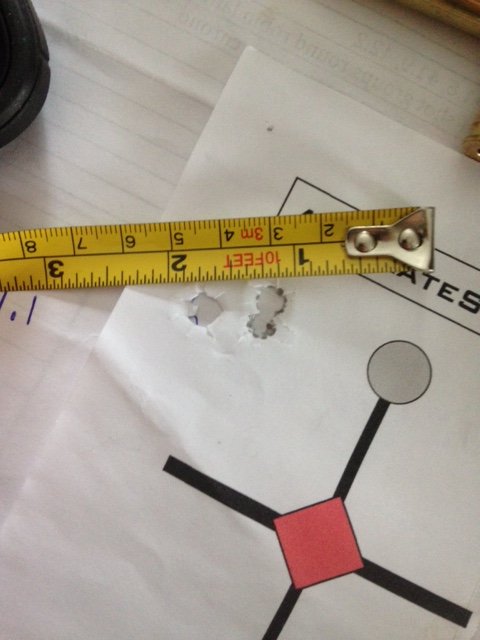

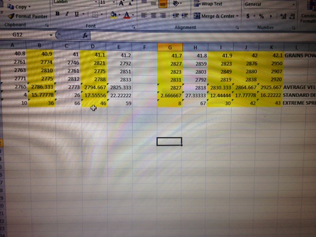

was at the range yesterday for some load development
Found a perfect load that was shooting 1/2 MOA at 200 yards pic of target attached as well pic of data from the day

Quickload is for modeling loads before you have shooting data. Since you’ve already shot, what a computer program may tell you is irrelevant. Looking at your velocities, the jumps in velocity between charges is much too great and they’re a going way too fast. Crappy chrono perhaps. Find some distance and shoot for drops to compare.

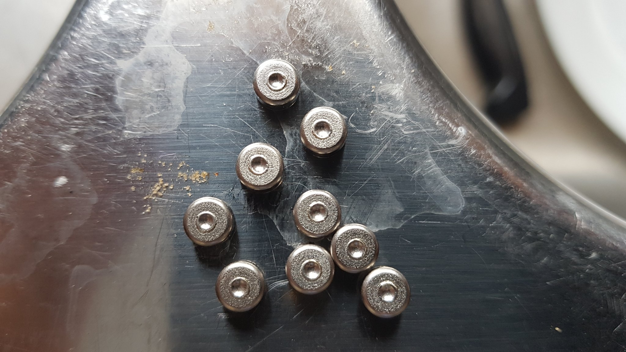

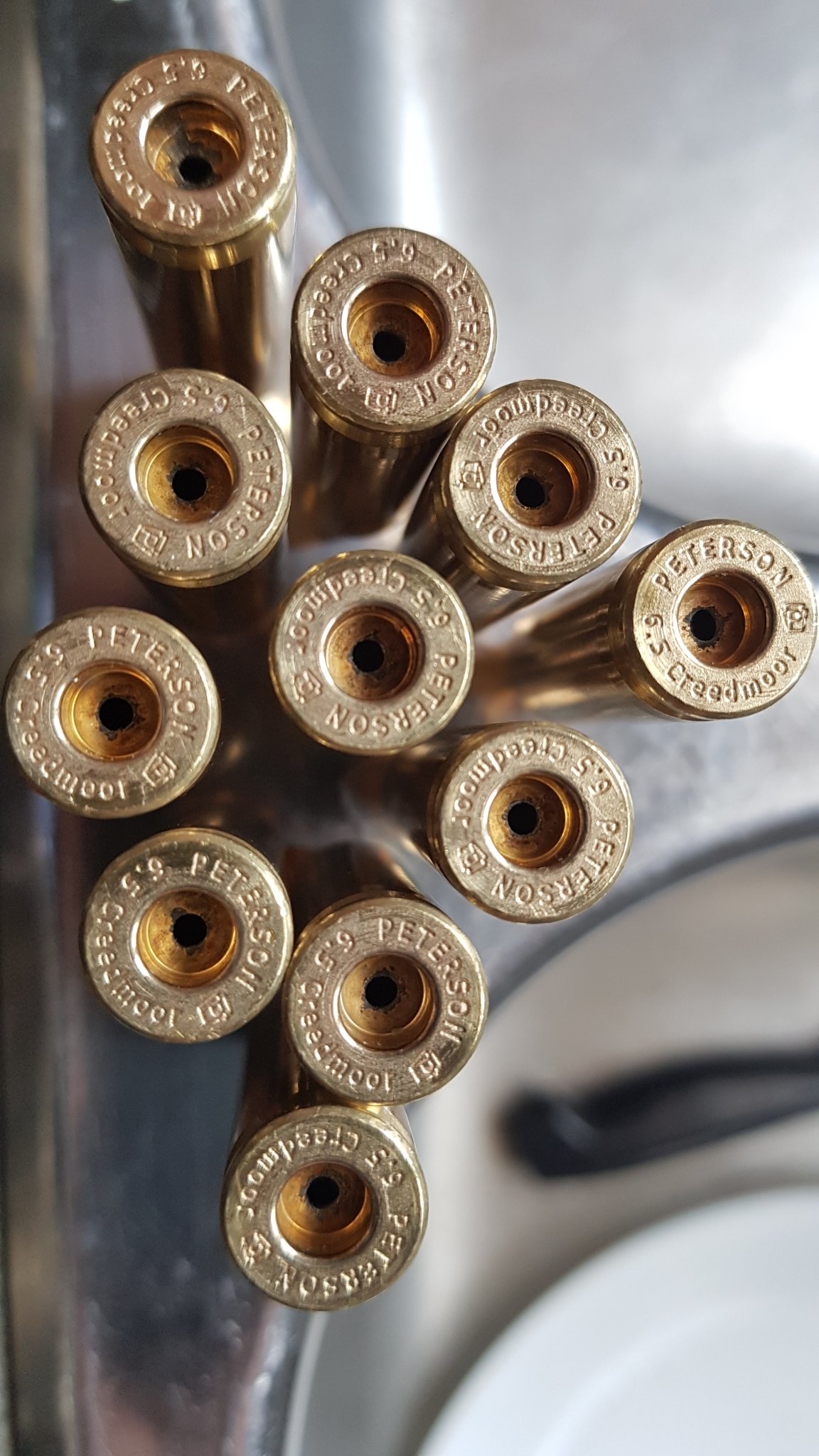

If you’re concerned with pressure, post some good quality pictures of the case heads. Many people who’ve claimed there was no pressure at all were simply missing all the pressure signs.

I wouldn’t really trust that chrony.
You can get a pretty accurate speed by seeing what your required dial ups are at distance.

I am super happy with the group at 200, the velocity seems crazy high and should have caused havok on my brass and primer
No heavy bolt lift, primers are cratered but that will happen even at the lightest loads (havent bushed the pin yet)

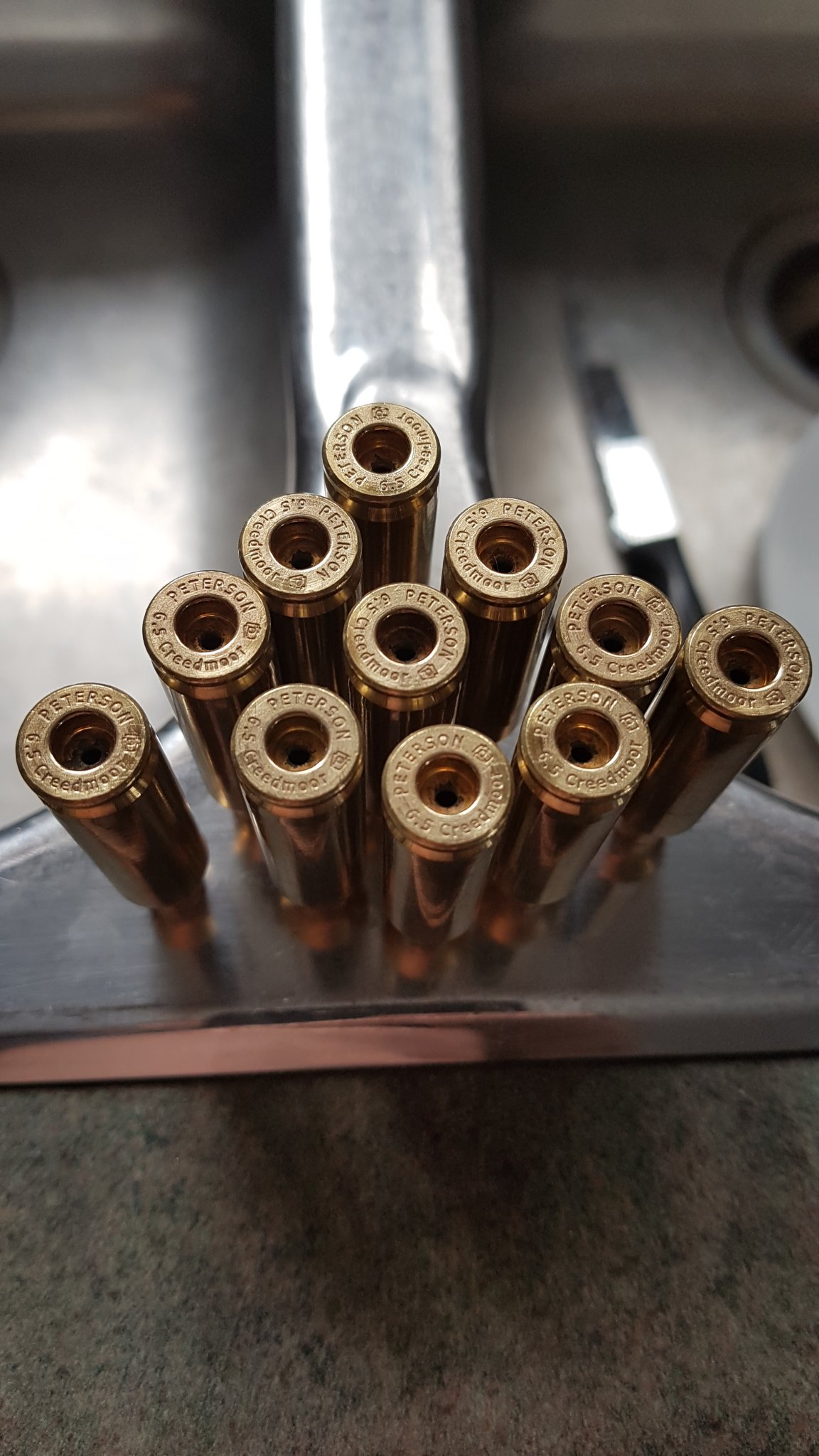

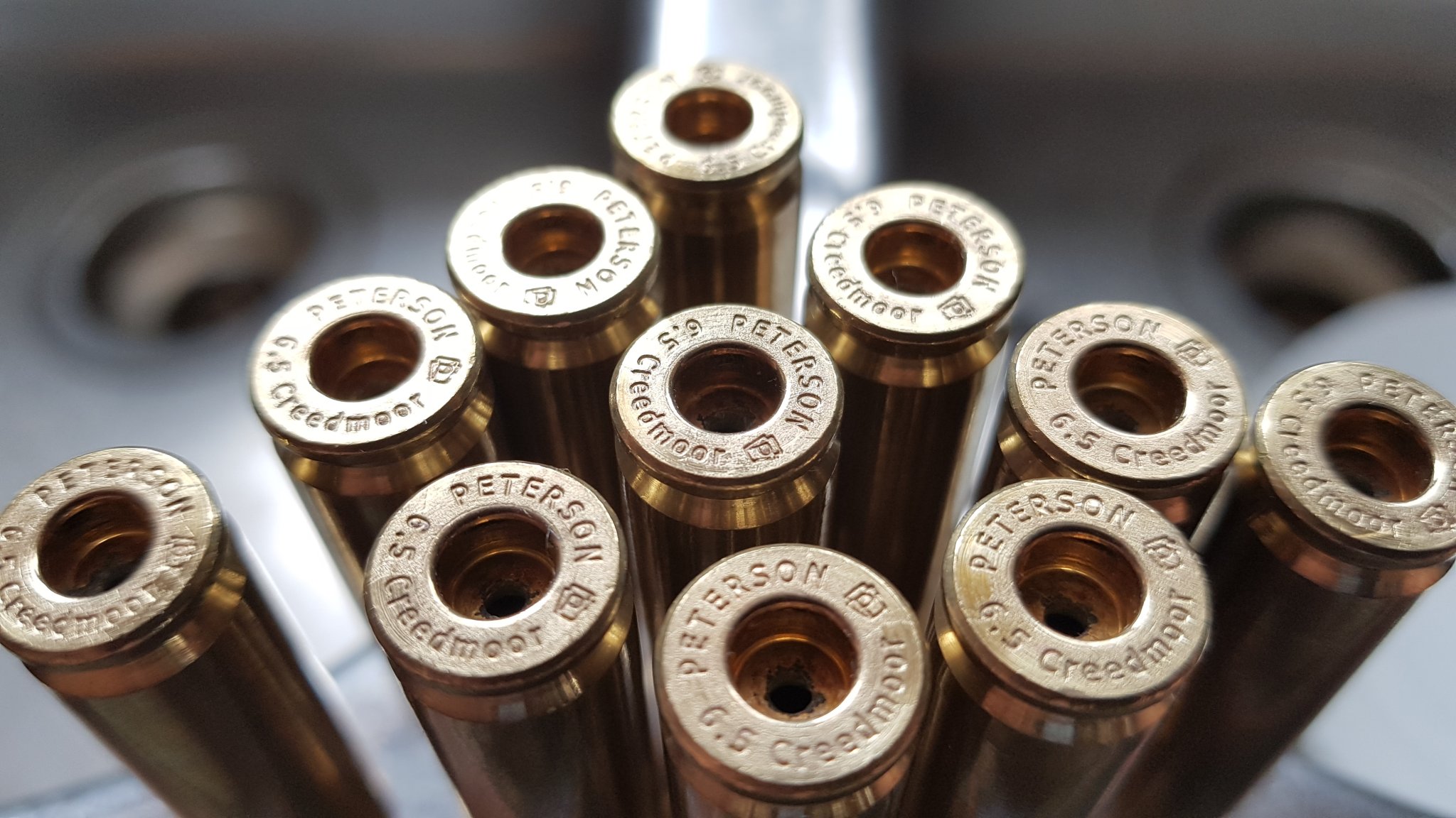

Here are some pics
Yep they are not getting punished at all
A little swiping on the case heads but I think I solved that problem by polishing the pin and rounding the edges
There is one of the cases that has a ring on it from the extractor hole but it is really faint

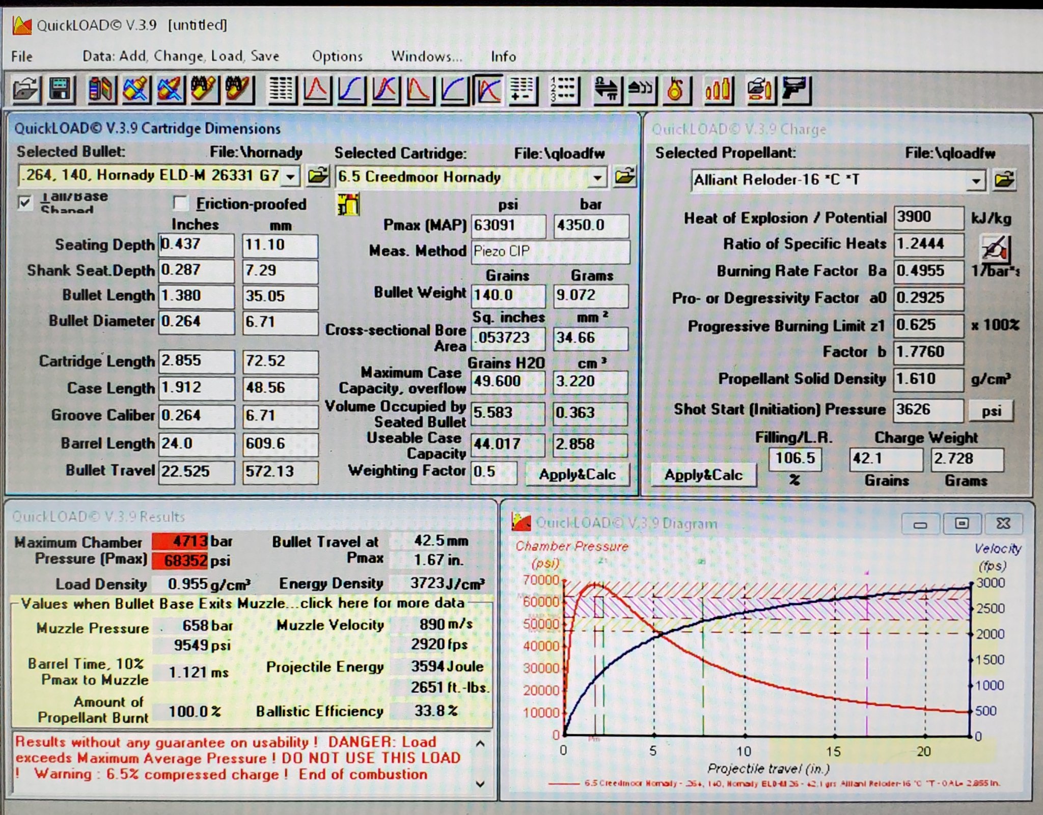

FWIW,
QuickLOAD estimates your chamber pressure @ 68,352 psi using all the parameters you defined. Including the case capacity of 49.6 gr. H20 (the QL default for the cartridge is 54.03 grs.)
QL did however estimate your velocity to within 5 fps @ 2920 fps.
Aside from that, the rounded edges of your spent primers look pretty good to me.

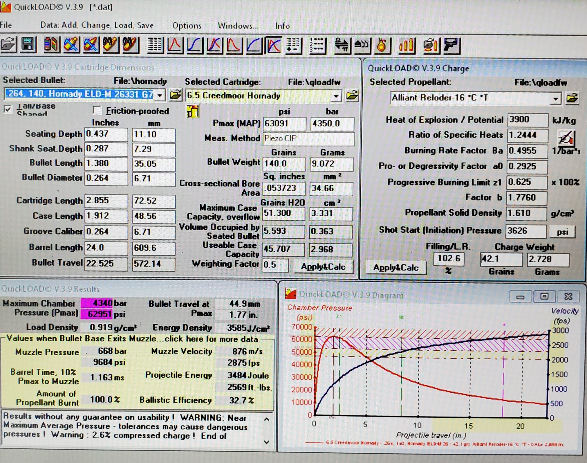

That is exactly what I was looking for Goldenbear
I actually H20 measured a couple of my cases for actual case volume of the fire-formed cases to my chamber.
Could I ask for one more favor, could you re-run quickload with the actual case volume and see what it comes up with.
Actual case volume of fire-formed brass 51.3 grains measured with water.
I am really curious as to why there is no pressure signs with this load.
Thanks again Goldenbear
After changing case capacity to 51.3 grs. H20 and leaving all other variables the same, the estimated chamber pressure drops to 62,951 psi. That makes this load right at CIP max pressure spec. Again, QuickLOAD is only an estimation.
Purely speculation, but it could be that the primer is flowing around the firing pin which is preventing the primer flow from manifesting in the crevice between the primer and case head.
So I get really good results with quickload matching up to my data. EXCEPT with Rl16, its flat out wrong they made a change to the file recently which isnt giving accurate results for velocity and pressure in my opinion. With my current load it says it shold be 150fps faster than it is and says im at like 72k psi lol.
I know they have a disclaimer within QL that powders could vary up to +/- 10% between lots. With that in mind it could be way off.

I do think you could be onto something with the primer flowing into the firing pin hole and not flattening, that is the only explanation
I really don't like that because you could load that thing to the moon and the primers are always giving you the same profile until your cases are dickerd.
