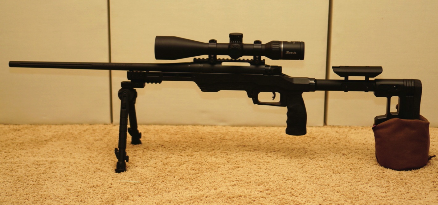

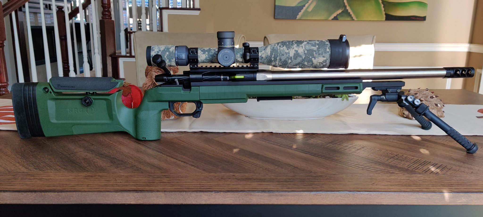

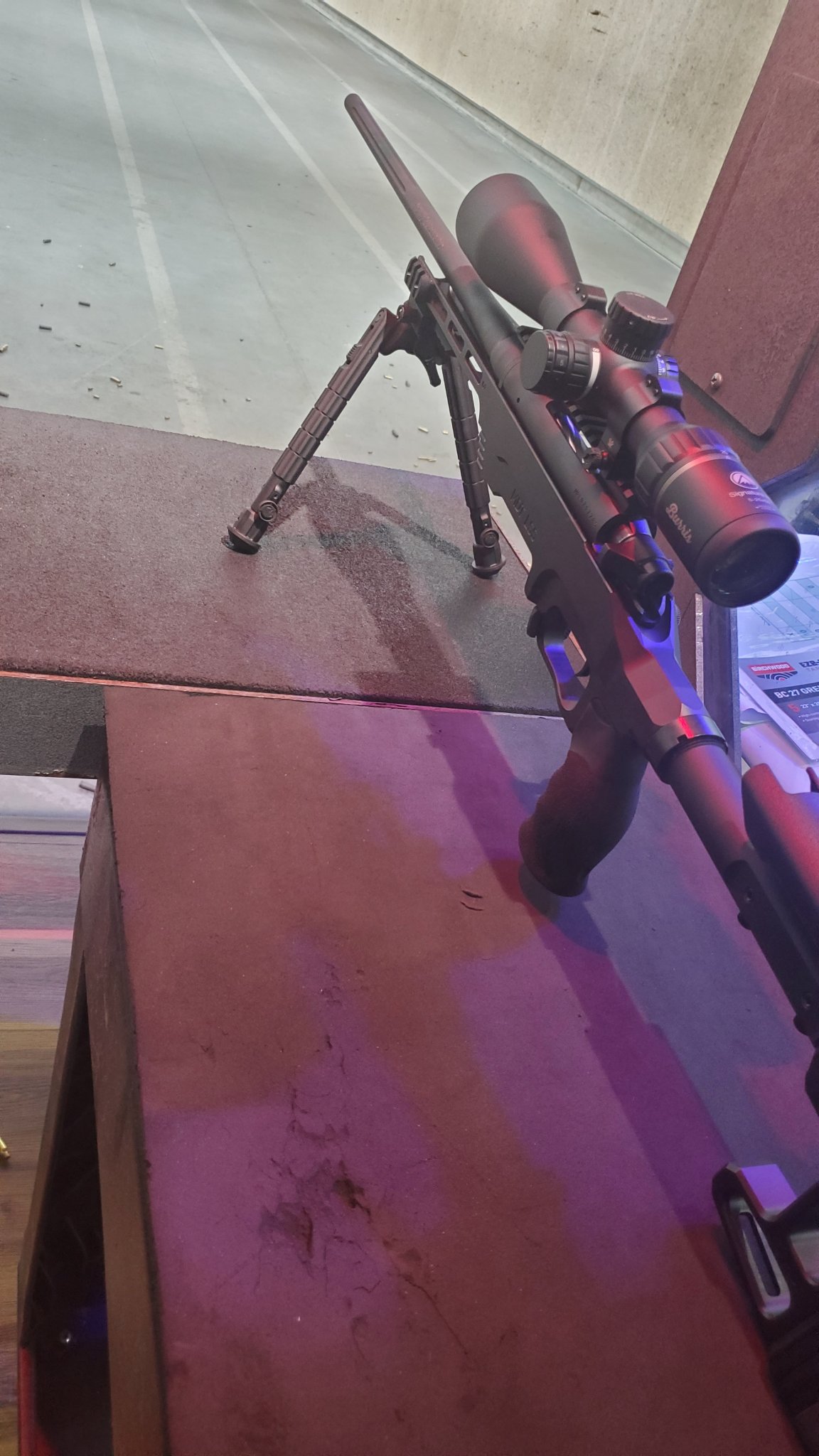

Howdy. I went down the rabbit hole of finding a cheap rifle then upgrading it. I have a Mossberg Patriot in 6.5 creedmoor that I've put into an MDT LSS Gen2 chassis. I am going to replace the barrel as I feel it's the real weak spot. I'm shooting >0.75MOA for the first 6-8 rounds or so then the rifle becomes pretty inconsistent opening up to 1.5-2MOA. If I let it cool the groups tighten back up. This rifle has a 20" light sporter barrel. Intended use is target, plinking, maybe hunting, and building an accurate urban sniper style rifle useful out to 700yds or so. A sort of heavy Sig Sauer Cross that doesn't have trigger problems. My initial thought was to go with a 24" straight barrel similar to a Savage Bull but I'm rethinking that, I may want something a little lighter. The media I've seen on 16.5" 6.5 creedmoor barrels has piqued my interest. I'm now thinking about an 18" straight or MTU/M40 contour that I will run braked or suppressed depending on the situation.
All thoughts, comments, and insight welcome.

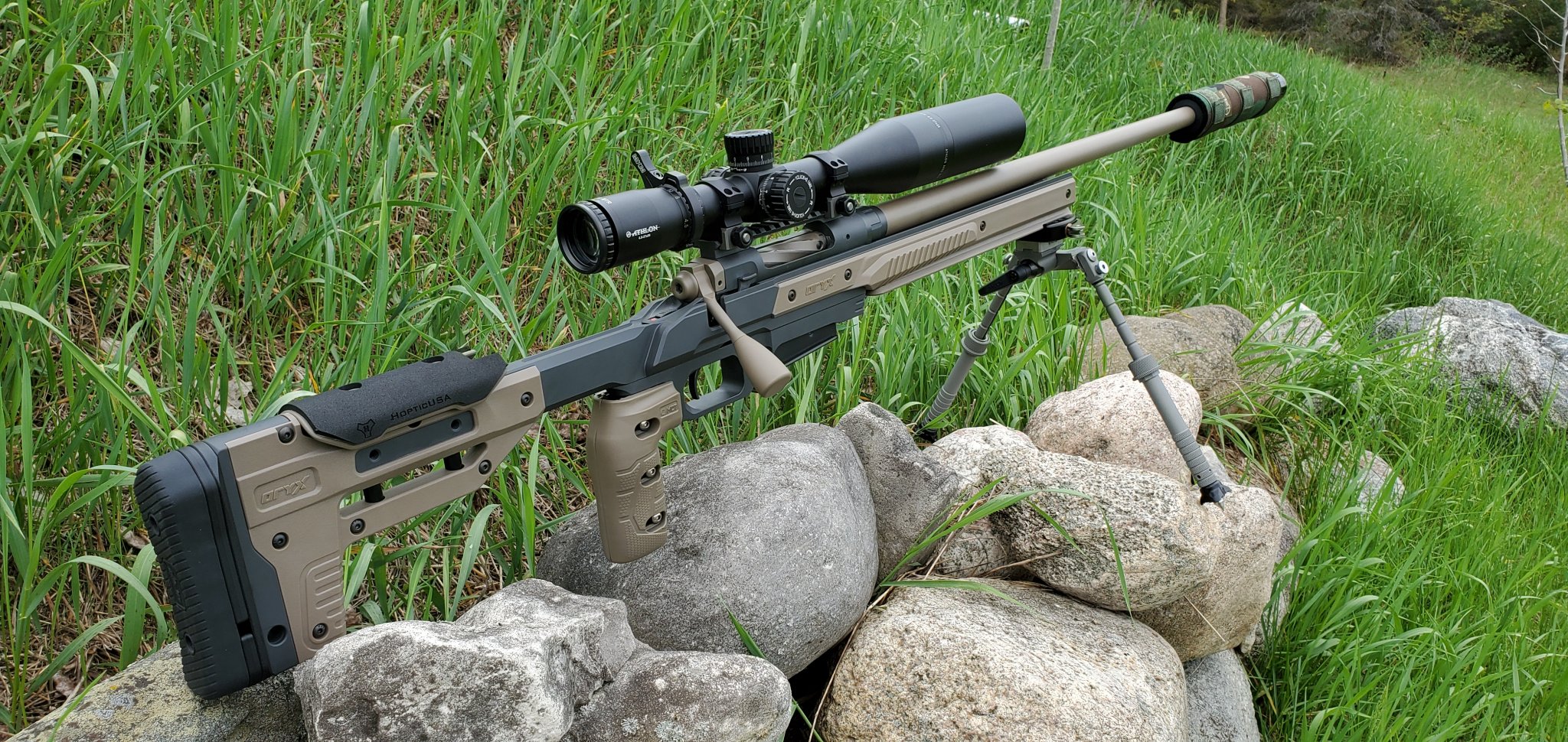

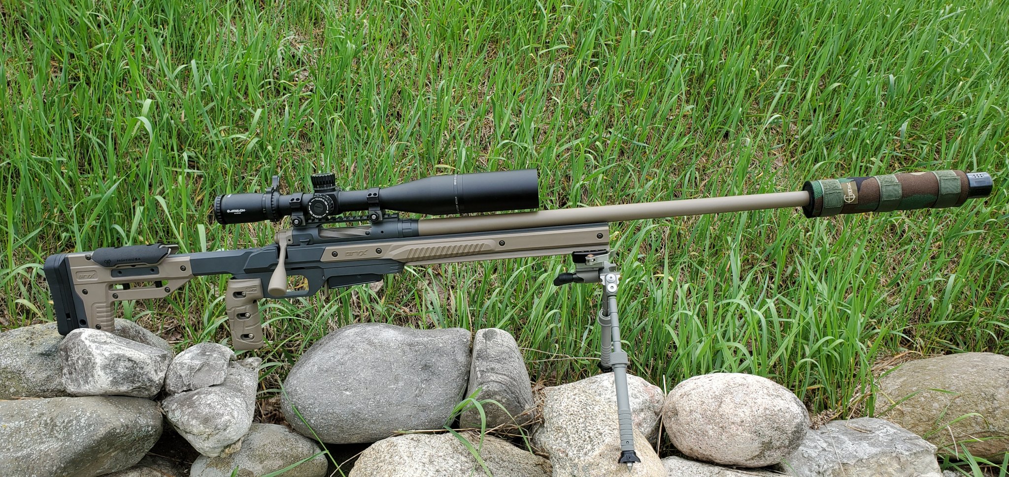

I would go with the Savage Varmint you mentioned. I'll weigh it when I get the chance tonight, won't be till late.
24" 300WSM, Oryx, Savage action.
Not the most pleasant thing to sling anywhere. But, not bad.
