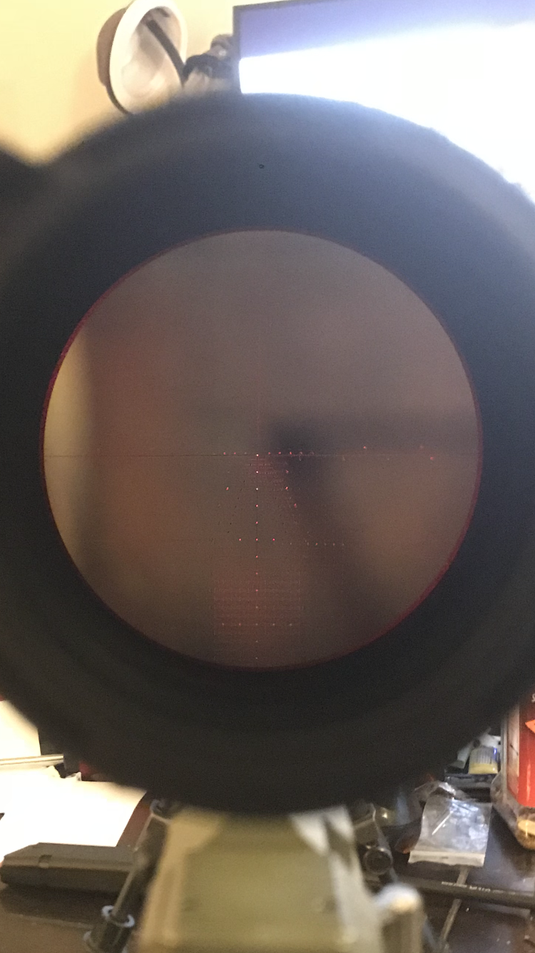

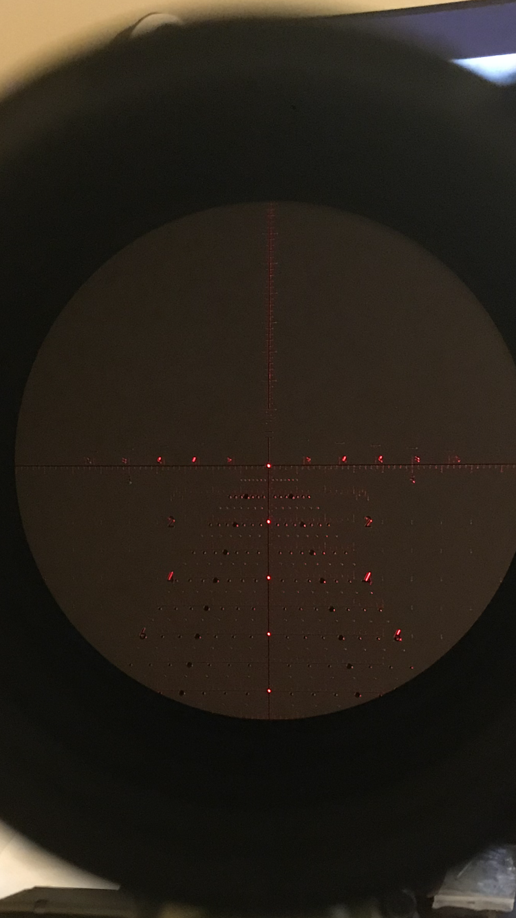

Red only, at least in the Nightforce and Leupold implementations I have for the T3.
Many more than a couple of dots.
I use the T3 in all conditions, day and night.
at 12x
at 22x
The only plus for me, for illumination is avoidance of inversion for thermal clipon in rare cases. Both my T3s are illuminated because I was not sure. But if I get another one, I will not pay extra for the illumination if that is an option.

As to the T3 grid being illuminated. It is and it isn't. When I turn on the red illumination for the 7-35x T3, the red dots shown in the reticle diagram above are very red. The rest of the reticle is faint red. I'm not sure if it is supposed to be that way? But, the T3 reticle in my L&S mk6 3-18x looks exactly the same way. Let's call it "full" illumination for the dots and "faint" illumination for the rest of the reticle.
Now that is for RED.
For green on the BF 7-35x, I only see the dots with the "full" illumination. No "faint" illumination for the rest of the reticle on GREEN.
Ravenyz-r6 can you confirm?
In the NF I've seen with a T3, only the dots had actual illumination. If the brightness was turned up, the splash made it look like more was lit, though.
I tend to believe that spec sheet that only indicates that the dots are intended to illuminate.
I’ll check when I get home, but memory wants me to say the red was full illumination and green looked more like just the dots. My H59 S&B was only dots on the illumination, which is very nice when you have a reticle with a floating dot center. I’ll try and remember to update later.
... the splash made it look like more was lit ...
That could be it ... but unless the illum brightness is different for the green than for the red, this "splash" phenom seems to only apply to the red, not the green.
And again, exactly this same "splash" affect, happens in the L&S mk6 3-18x T3 implementation as well. it isn't just a NF "glitch".

Here are some crappy pics of the reticle illuminated. Looks like either crappy illumination or crappy bleed over. I’m leaning towards bleed over as posted earlier as only the dots appear concise.
Green I feel is the same, but since it isn’t as strong as the red it appears not to be as bad. Kinda disappointing in either case. Feel like my PST has better illumination.

Here are my attempts ... first the RED ... I think this is max brightness for the illum. Click on the pics for the largest image. Turn off the lights in your room also, especially for the green one.
And GREEN ... again I think this is max brightness for the Illum.
So Rev is correct, the "bleed over" exists in the GREEN illumination as well, but is more faint.
Now one question is, is this good or bad ?
One reason I didn't know this stuff, is I never turned on the illumination except a couple of times in the house to see if it worked. I don't use it in the field. Don't need it with NV ... could potentially use it with thermal, to avoid inversions, but haven't done that in the field yet.
So, I can live without it, but is the perhaps unintended "splash" useful ?
it might be for me. I will have to try it with the thermal clipon.
I don't see how this is a problem: Either I see it as a bonus that helps me be aware of more of the reticle, or I turn the reticle to a lower level.
The Horus spec is clearly intended to be just the dots. If I turn the brightness to a level where that's all I see, it's working as intended.
