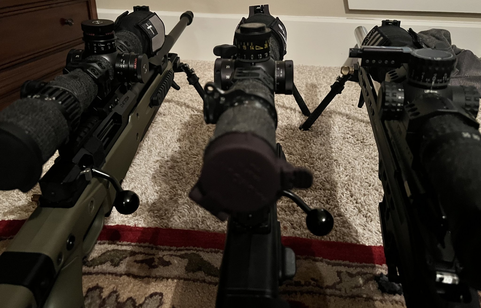

I have all three. All are great. I have a slight preference for the view through the Schmidt. Of the two atacrs, I have a slight preference for the 7-35. Parallax is less finicky on the Schmidt.
your list contains no bad choices. If money was no object, I’d personally do the Schmidt.
