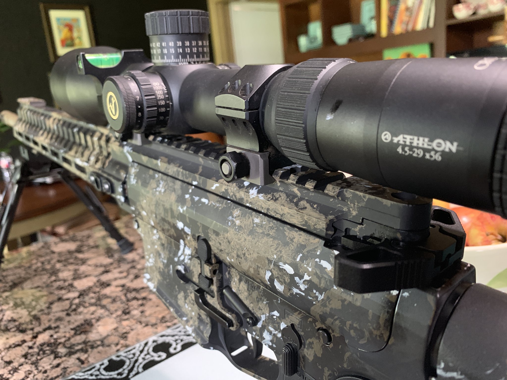

I just got an Athlon Chronus 4.5-29 (paid $650 w/NF ultralight rings and vortex level, all used, but the glass is AMAZING)

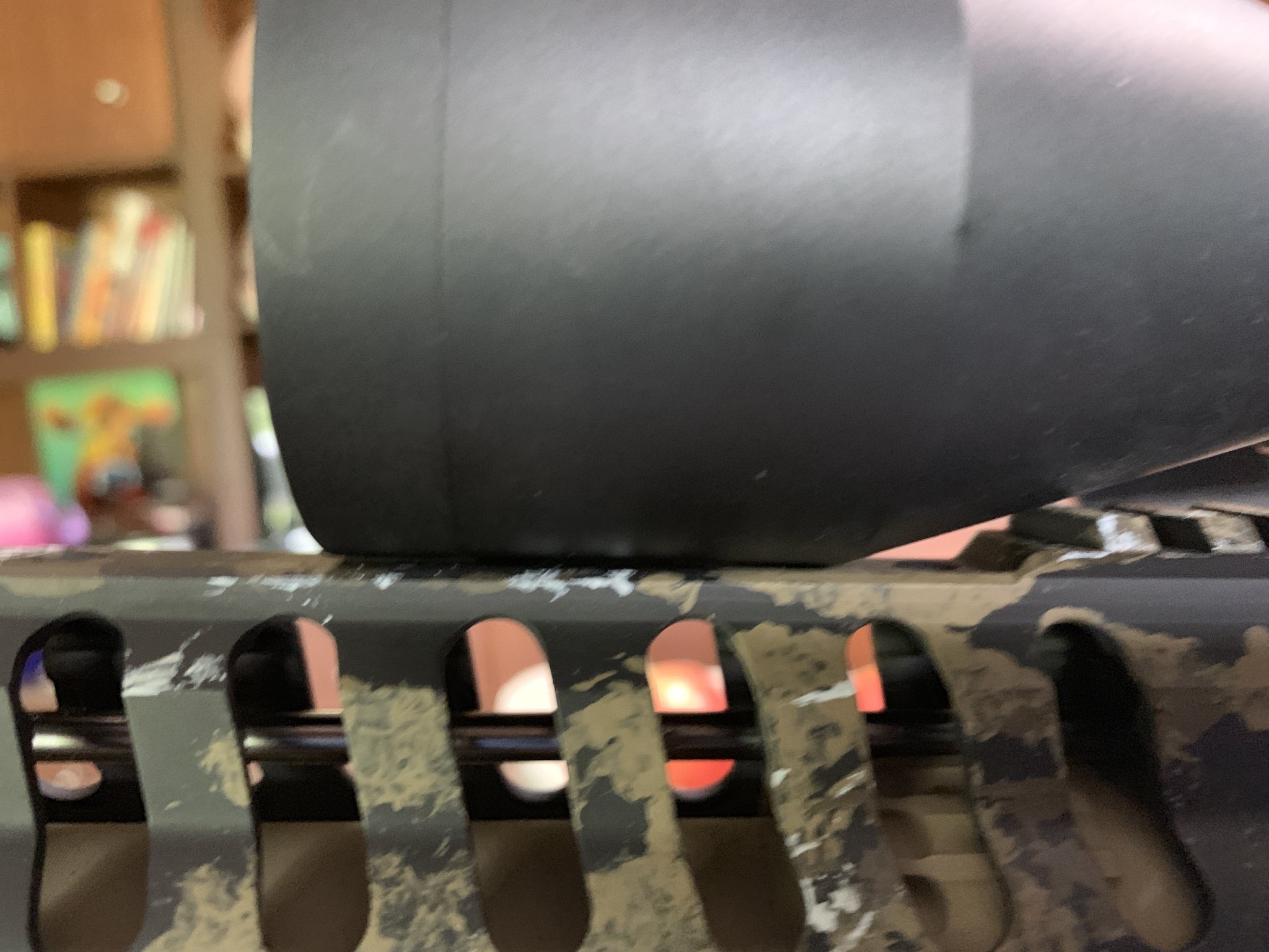

It's going on a POF 6.5CM 20" AR10...the NF rings are 1" and the front of the scope is hard on the rail, so I have to get something different.
My local range goes to 500, but within about an hours drive, I can shoot out to 1200 yards or so. Eventually, I plan on participating in at least a few PRS gas gun matches with it.
So do I need 20 moa or 0? If I do need 20 MOA, does that change the ring/mount height I'll need?
If ya'll say 0 moa, I'm planning on ordering these rings or ARCs in the 1.25" height, if you say 20 moa, then I really have no idea as there are SO many good options.

For any AR platform, I would go normally ~1.5" height, but the top rail on your rifle is taller than standard, so 1.25" will probably be fine. You're probably going to be fine with a 0MOA mount, but honestly there's no reason I can think of to NOT get a 20MOA mount. I'd look at Badger or Seekins for a one piece 20MOA mount.
Reactions: rmantoo
As the cronus has lots of adjustment range, like has been said, youll probably do just fine with either the 0 degree mount but 20 wont hurt anything, only help. I wouldnt fret going with either.
