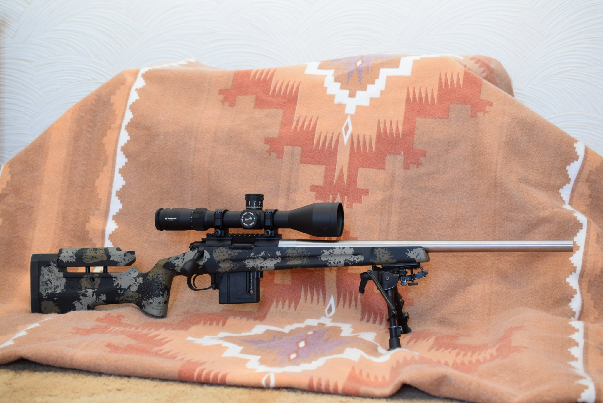

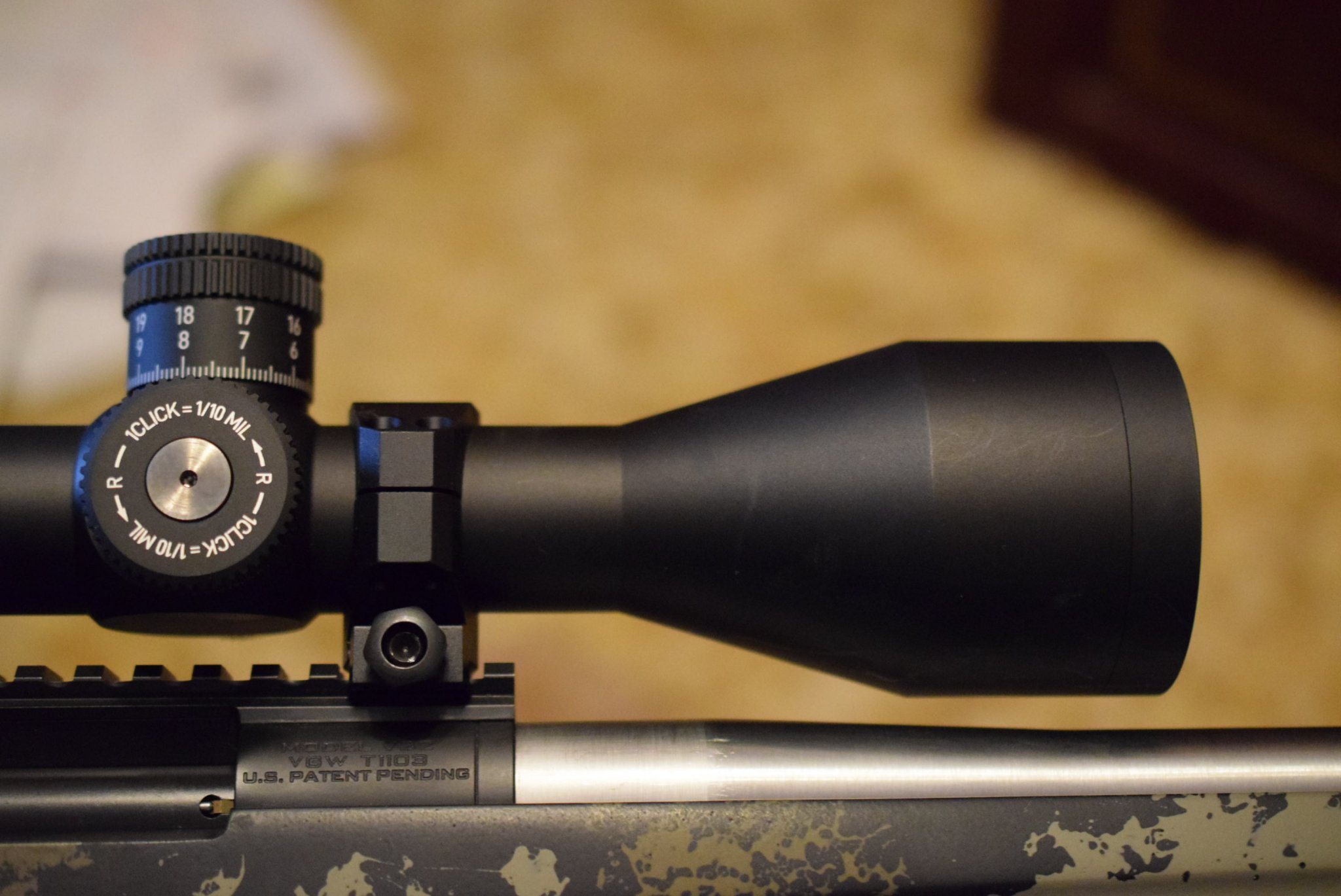

I recently finished barreling my new Three-60 action/30 MOA rail, with a Krieger sendero contour bbl blank, and installed the same Athlon Cronus as you're using, going with Athlon Precision medium height rings, which are listed on their website as having 1.069" height. Their low 34s have a listed height of .944", or 1/8" lower. Judging by setting a digital caliper at .125", and looking at it from the side of my rifle, it appears that the low rings would still allow the objective bell to clear the bbl - but just barely. Since I put the Three-60 into a Manners PRS1T stock with adjustable cheekpiece, there was no reason for me to go with the lower rings. I have used these 30 & 34mm Precision rings on three rifles, and like them just fine.

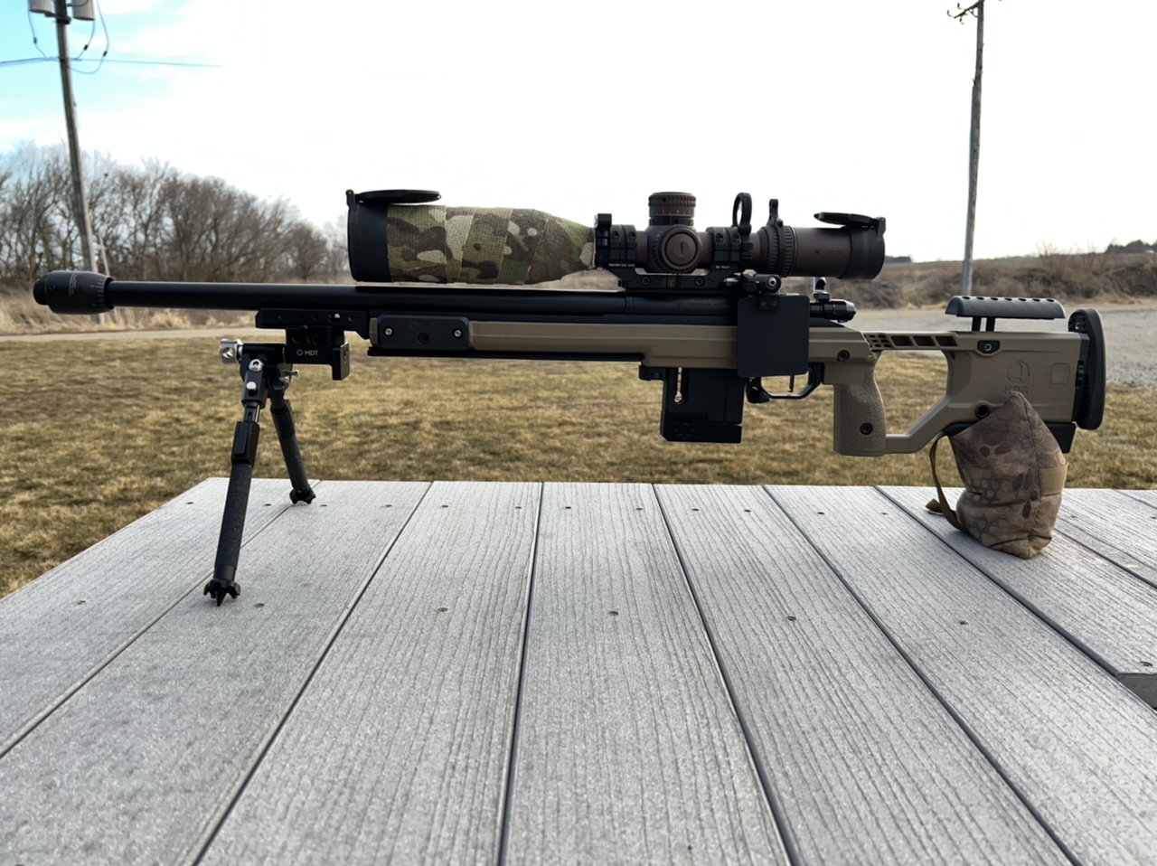

Here is a V22 Gen 1 in a MDT LSS gen 2 chassis.
The rings are UTG PRO. They are 37mm from the top of the pic rail mount to the center line of the scope.
That provides for about half an inch of clearance to the barrel. I don't recall what MOA rail that is but it would not matter.
The mounting screws are flat head hex drive and that makes them snag free. The flat hear screw also allows you to
mount them with the screw on either side. Some mounts have a half inch hex nut that hits the bolt unless you put
the nut on the left hand side of the gun.
Don't forget to factor in the rail MOA and the sun shade and any scope caps. The caps on my Trijcons add about
.156" to the radii. I had one rifle that cleared the barrel by about .010"when all of that stuff was attached.
