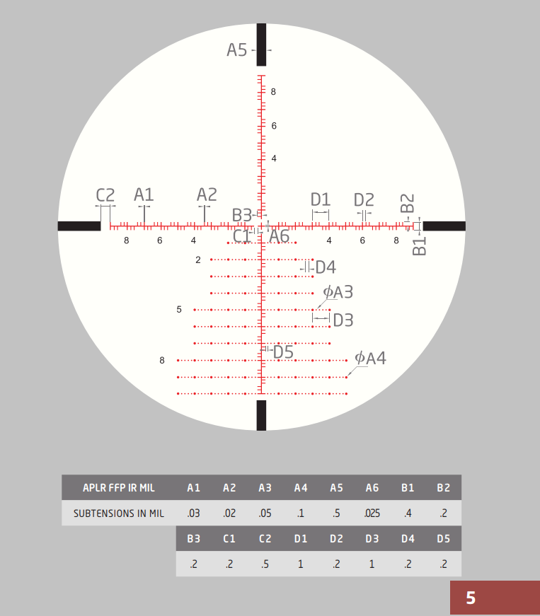

The original cronus had this APLR reticle

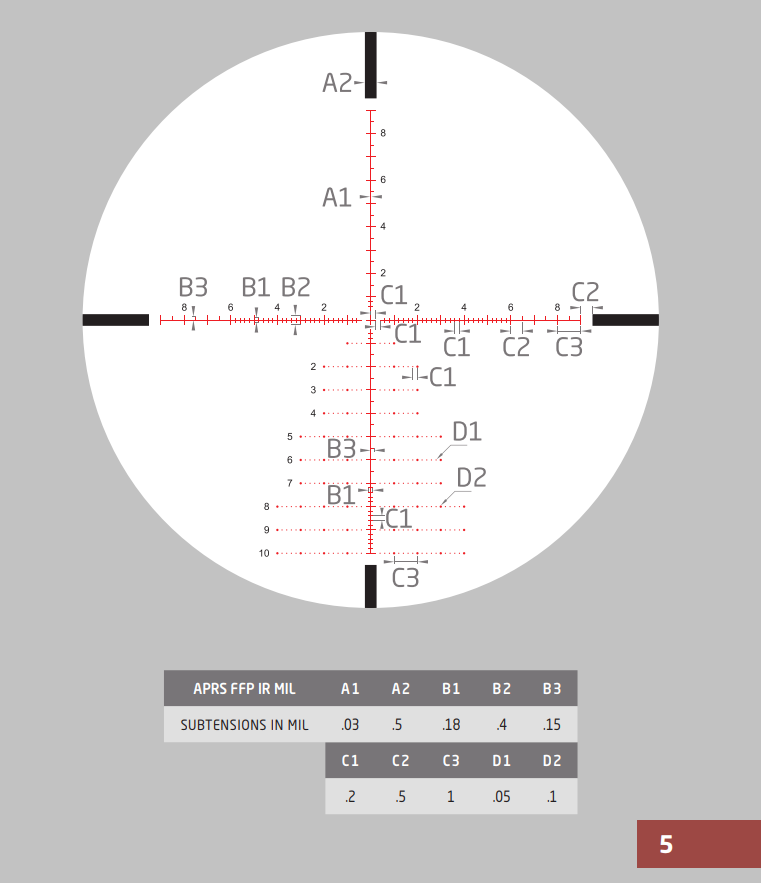

The Cronus BTR has the APRS
Reactions: Formosan
I'd shot quite a few 22RF PR matches with the original Cronus APLR reticle on my 40X & V-22 bolt repeaters before selling the original Cronus off the V-22 & replacing it with a BTR. I never felt that the APLR reticle was too thick or in any way hindered my ability to hit some rather small targets in those matches, but after only one match with the new BTR, I'm liking it very much so far. If the thinner ret makes it too hard to see on a target that's in cluttered surroundings, you can always dial in some illumination...if you've got time.

Looking at the reticle diagrams and pictures, it seems like the reason that the APRS seems thinner is because it is somewhat less cluttered, and more symmetrical in regard to the hash marks on the crosshairs.
As a first-gen Cronus user, I have to admit that the newer reticle is more appealing to me... but for my purposes (this scope is on my primary prairie dog rig), the APLR (older) reticle works very well.
