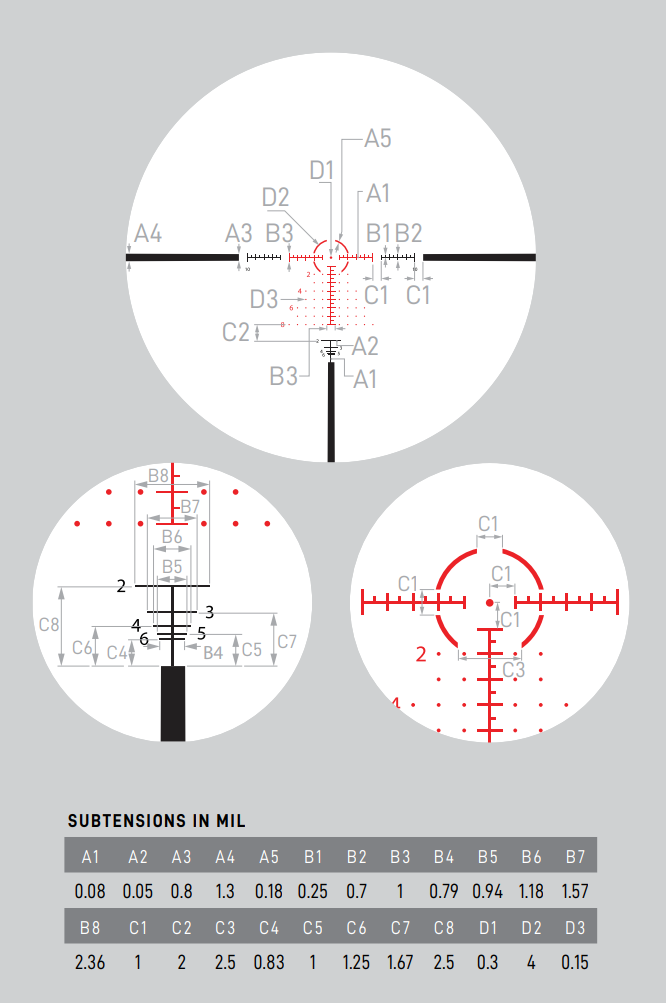

Interesting. The reticle is servicable:

It's a cool reticle, reminiscent of the new ATACR 1-8 design.
I do wish they had extended the horizontal stadia to provide a half mil reference from center
I would agree for sure. Starting at 1 mil is a bit far, but, it's one of the only donut/Christmas tree style reticles I've seen in a budget optic.
