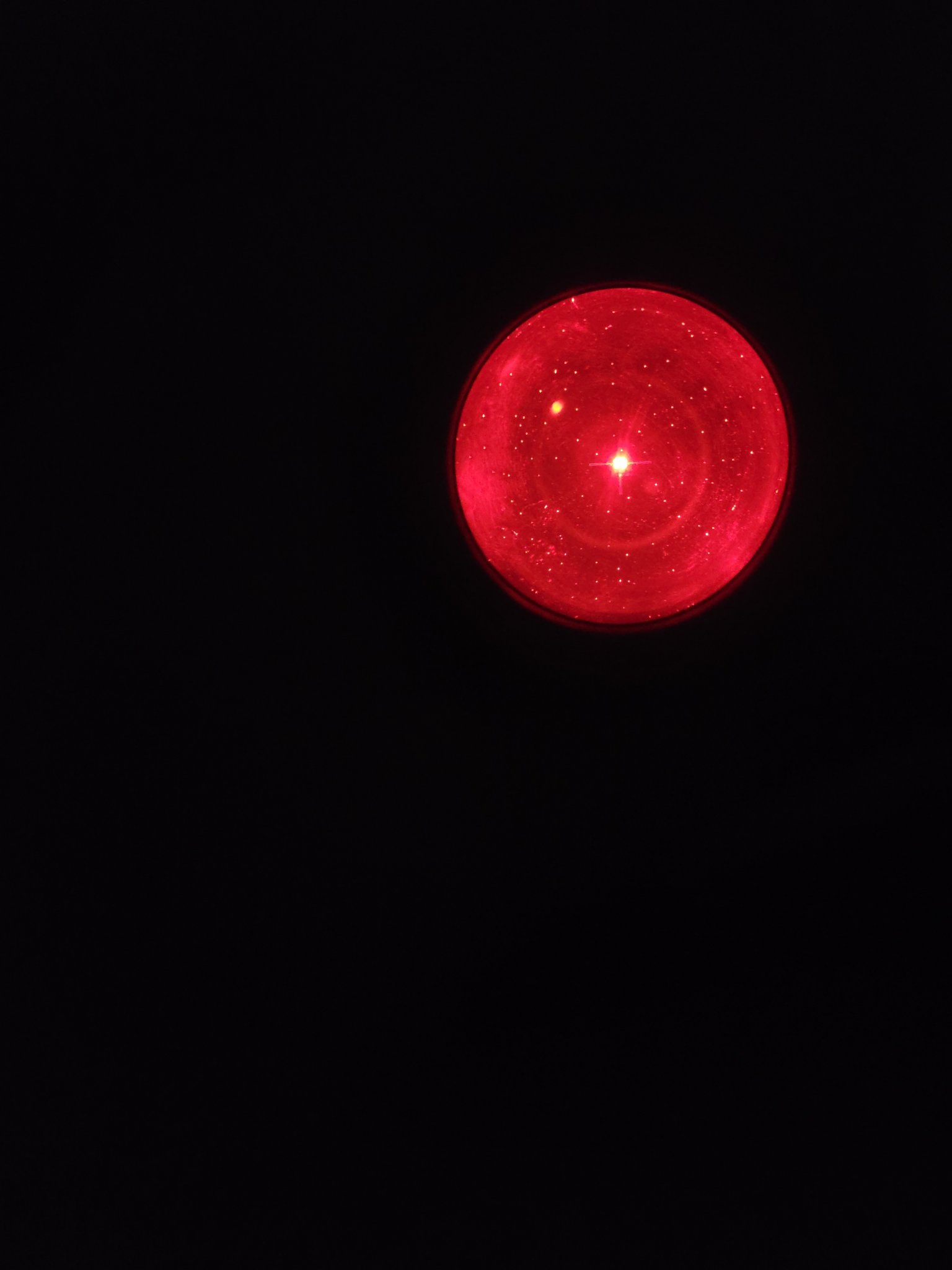

    I have 2 Athlon Ares ETR 1-10 scopes and I really like them. Until I turned on the illumination.
    It looks like this.
    The general red glare is because my hand is over the front of the scope, but those spots are all over the inside of the scope.
    What the hell causes this?

    I got the replacement scopes back from Athlon today. One was just as bad as before. The other was far worse. I specifically asked them to please check before they sent out the scopes as they told me that they had poorly polished glass in the ones I sent in. Apparently this is the type of service you can expect from Athlon.
    Here is a pic I just took in a dark closet through the REPLACEMENT scope I got today. These imperfections are CLEARLY visible in daylight conditions, too.
    You can see all the spot imperfections in the glass.

    I sent two of the 1-10x scopes back due to the reticle wobbling while the mag ring was turned. They said it was acceptable. 🤷🏼‍♂️
    Thanks guys. I spoke to the warranty manager today and he said they may have sent out bad scopes instead of the proper replacement ones. He sent me a label so it goes straight to him this time. We'll see how it goes.
    That doesn't exactly inspire any more confidence in Athlon. How the fuck do you send customers defective scopes a second time? One would think they would pull the bad scopes so there is no chance of them getting in customer's hands again :confused:
    Hate to hear that. I've been loving my Athlon scopes, I did have an issue with one, turn around was slow but got it sorted but all warranty issues are slow up here in Canuck land (aside from MDT)
    Yeah, once some folks with a level of responsibility at Athlon got wind of what happened they actually went way out of their way to make it right.
    It seems that they really got screwed by their glass supplier for the 1-10. They had to look through 20 "good" scopes to find one with no issues. They just got a new shipment in that passed initial inspection and they are doing a deep dive into the new batch to make sure the issue got resolved. They probably don't want me to say that but I'll be straight up with you guys here.
    Bottom line: They got royally fucked by a glass supplier and didn't catch it. They are now aware of it and made it right by me after a small mistake. So overall, I am pretty happy. If you go to buy a Athlon 1-10, just adjust the diopter, turn the illumination on and cover the obj lens with your hand and you will see if it is good to go.

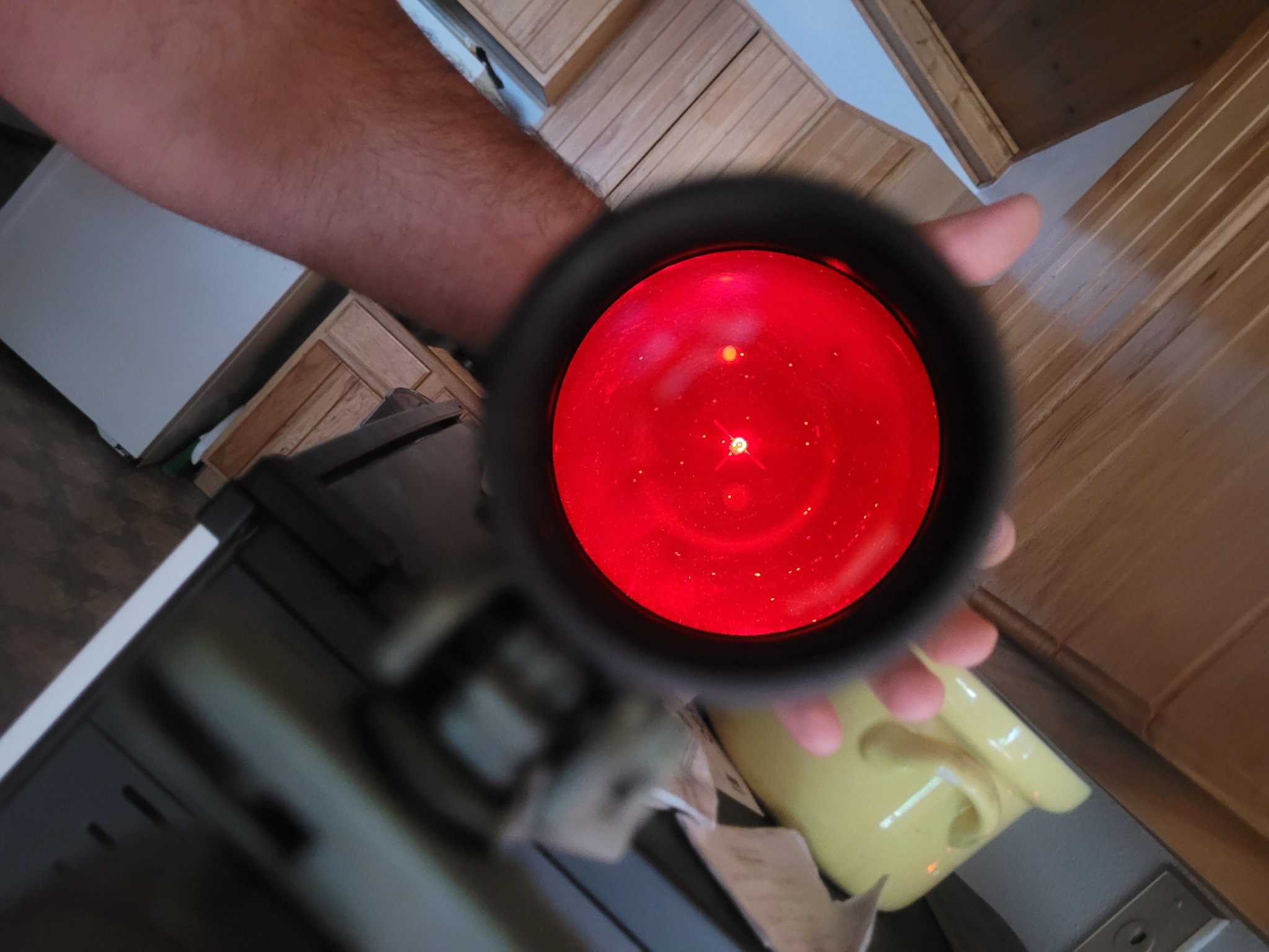

    Got the second scope out and put a battery in. Adjusted the diopter and turned the illumination on. It has glass imperfections that show up as little red dots throughout the FOV of the scope just like in the 1-10.
    AT THIS POINT, CONSIDER ALL ATHLON GLASS AS SHIT AND AVOID ACCORDINGLY.

    When you get yours, adjust the diopter to your eye, put a battery in, crank the illumination up, and go in a dark ish room and look through it. I bet you will see glowing red pixie dust in your FOV.
    I have only seen 2 out of 8 scopes that didn't have it, and one of those two has a center dot that wasn't etched round and the turret mil lines didn't match up with the indicator line but were half way off.

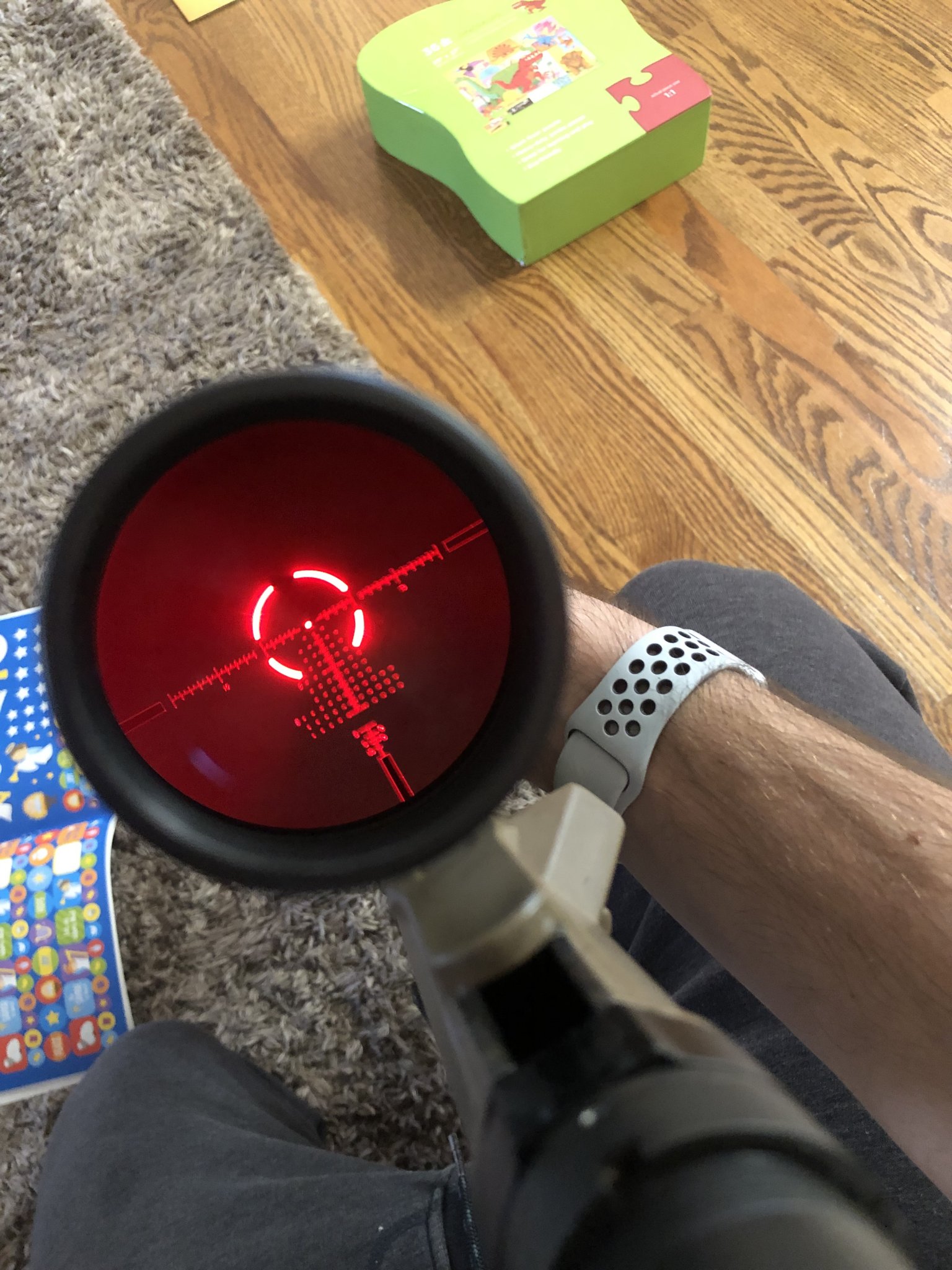

    I had to go home and check mine. I’ve got 4 different Athlon at home and none of them have this issue. I will admit I have had some other problems that they rectified.

    Here’s my Ares 1-10, this was a new one sitting on eBay for $750. I also checked my 6-24 Helos and 2-12 Helos and saw a couple “irrelevant” specks that have previously not been seen in 2 years of match shooting. I had returned a Tango4 twice because there were visible specks without illumination, and my Helos specks are NOT visible on low illumination. You will never be on max illumination in pitch black, which is the only time the Helos specks were visible. If this is the case for others’ Ares ETR specks, it’s annoying but not an issue in reality.
    Other than that, this is my first “UHD” semi premium scope so I’ll be comparing it to cheaper LPVOs I’ve owned (PST, PA, Burris, Sig, etc). What I immediately notice is that a near target comfortable diopter adjustment is also proper for far target focus. Cheap LPVOs are super finicky and need separate settings marked. Also there is a certain radius from the center of the FOV that is “perfect” flat image on 1x, where maybe the outer 20% is distorted. On cheaper scopes it was 50% or more outer radius distorted. Vortex if I recall was nearly 0%.
