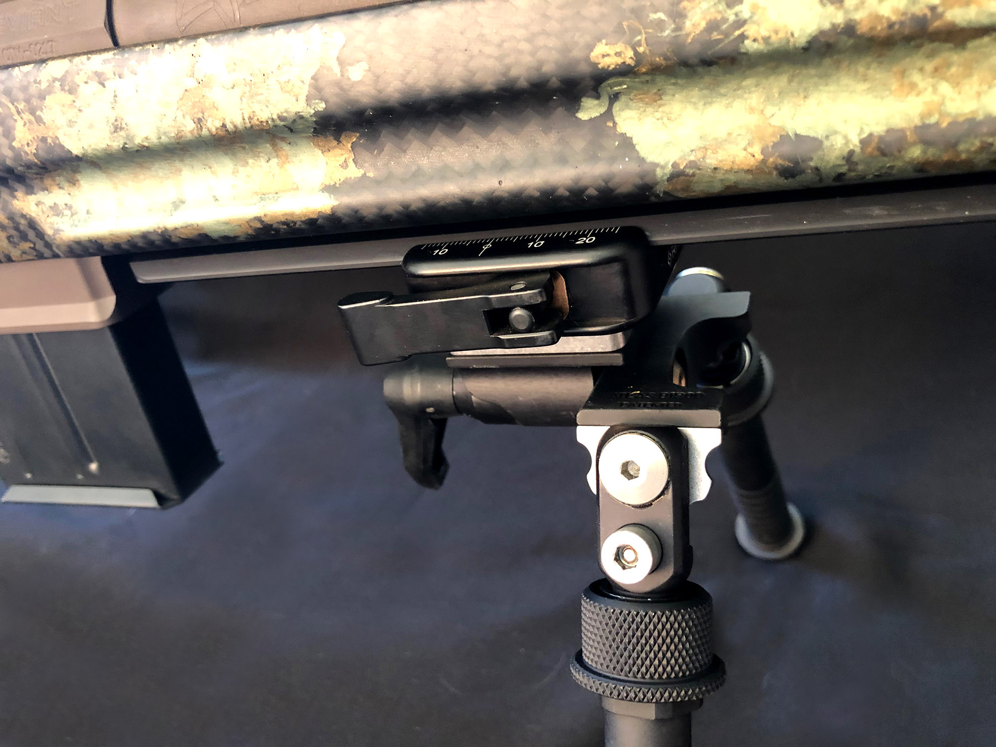

Decide what type of rail you want - a Picatinny rail or Arca would be my recommendation. The difference between the two is that the Pic rail has indents that allow you to move the bipod forward and back by placing its head/adapter in one of them. The Arca rail is a slide, which allows you to... well... slide your bipod to any position along its length.
I have a Pic rail on my 300 PRC and an Arca on my 6mm. I prefer the Arca. Below is a pic of the Arca. In either case, if you've only got a single stud, you will likely need to drill a second hole to mount the rail.

ARCA. The ability to quickly and easily slide the bipod back&forth several inches is very very useful in competition where one shoots from all kinds of props. With a pic rail, the bipod or whatever has to be completely removed. No way that's happening on the clock.
