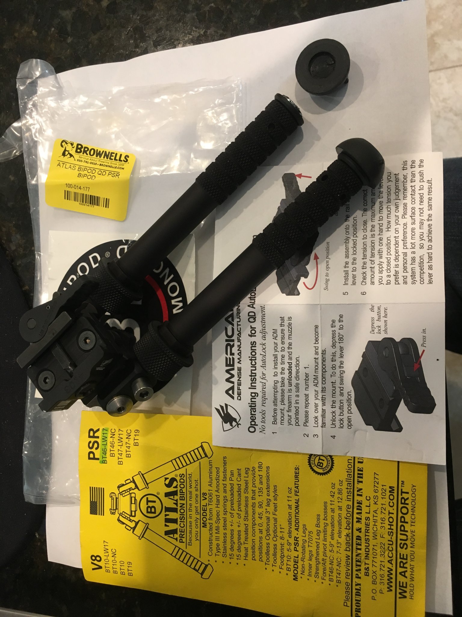

    I have not tried the TBAC, but I've played with Harris, Ckye, Atlas PSR, and Atlas CAL. I now only have the CAL and have upgraded them to gen 2. They're extremely solid. Plus, turnaround time from me shipping out to be upgraded, to receiving them from B&T was ~10 days.
    Bipod is here and man..it is very nice. It will lock up tight or loosen to wherever you like. The legs work extremely smoothly and it just exudes quality.
