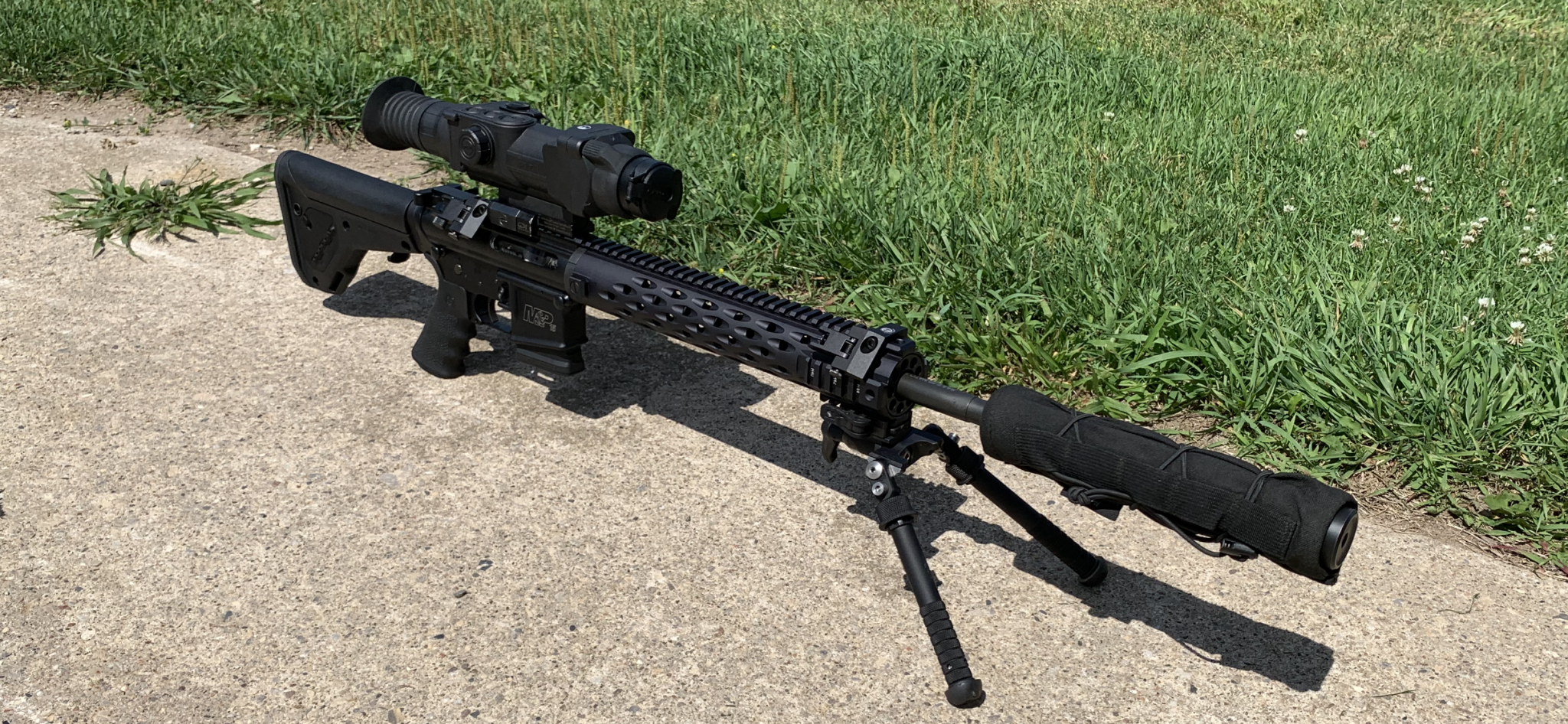

Been using my Harris for many years now. Recently this year purchased an Atlas Cal Gen 2 based on recommendations from other SH members. Here is my take on the two.
run mostly on bolt guns but some on AR15/10 platforms
-The mounting system on the Atlas BT65 LW17 is superior to the Harris and way quicker to add or remove the bipod. It doesn’t loosen like the Harris does under recoil
I wasn’t entirely sold on the feet on the Atlas. When using in the field the feet tend to slide, especially on damp grass. I put spiked feet on my Harris years ago because it had the same issue. However I added the hawk Hill feet to the atlas and the Atlas stays firmly planted. I like the quick change on the Atlas feet if I want to shoot from something that I don’t want scratched I can swap in the field if needed. Harris has cotter pins in it so I can do the same if needed.
I haven’t noticed any negatives about the speed of deployment for what I use the Bipods for. I definitely think the Harris can be deployed a bit faster tho. As far as extending the legs go the Harris extends faster from the spring loaded position unless it hits grass etc before extending to needed height. At that point I have to Extended the Harris to proper height similar to the atlas, pressing the button and manually pulling the leg out. With the atlas I just tilt the rifle with one hand and press the collar on the legs down until the leg hits the ground and let the weight of the rifle snap the collar back into place.
My biggest like about the Atlas compared to the Harris is the legs don’t fold when pulling the gun back or turning the rifle on the ground. The Harris would catch grass then either fold or let the grass go and spring back into place. The Atlas just rips through whatever is in its way and stays with the opposing leg
I use both, like both, but the Atlas is my go to if I have a picatinny rail to mount it to. Just for a few of the reasons noted above. The height/canting feature etc to me is a wash between the two. Also had my first leg bolt come out of the Harris this year. After 15 years of use/abuse I’m impressed how long it lasted before any hiccups arose. Was able to fix in the field and continued using
These Bipods primarily get used for crop damage/eradication in farm fields and see many hours of use in damp/dirty conditions. I don’t compete in prs which is probably why the speed of deployment doesn’t bother me as much as others
My main suggestion would be to buy One Quality bipod to share across all your rifles.
View attachment 7171324View attachment 7171325
Revealing my ignorance here, but I notice in your pic, and others, the Atlas legs extended forward like that. How does that work when it comes to "loading the bipod" ... thanks.
In complete honesty it’s to low for me to use in that configuration. Has its place but I don’t use it like that. Makes nice pic tho lol. Someone else will be able to chime in with an answer I’m sure. I shoot prone with it in the fully folded out position
I’d guess not well as the feet would drive into the ground and there’s really no flex in that configuration
I appreciate your honesty, thanks.
It works the same as the load you place doesn’t need to be overwhelming, just enough to take the slop out. I would shoot my OBR with them forward like that off of a bench (was the perfect height) and didn’t have a loading issue. Did the same in the prone with the wife’s system at that angle.
