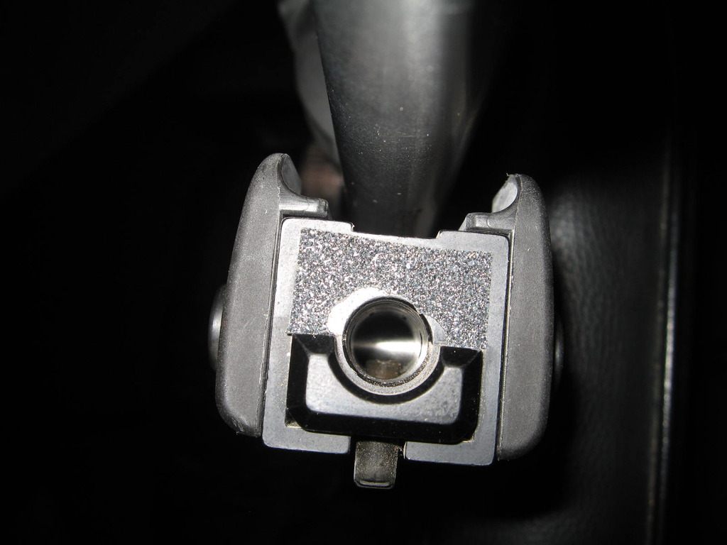

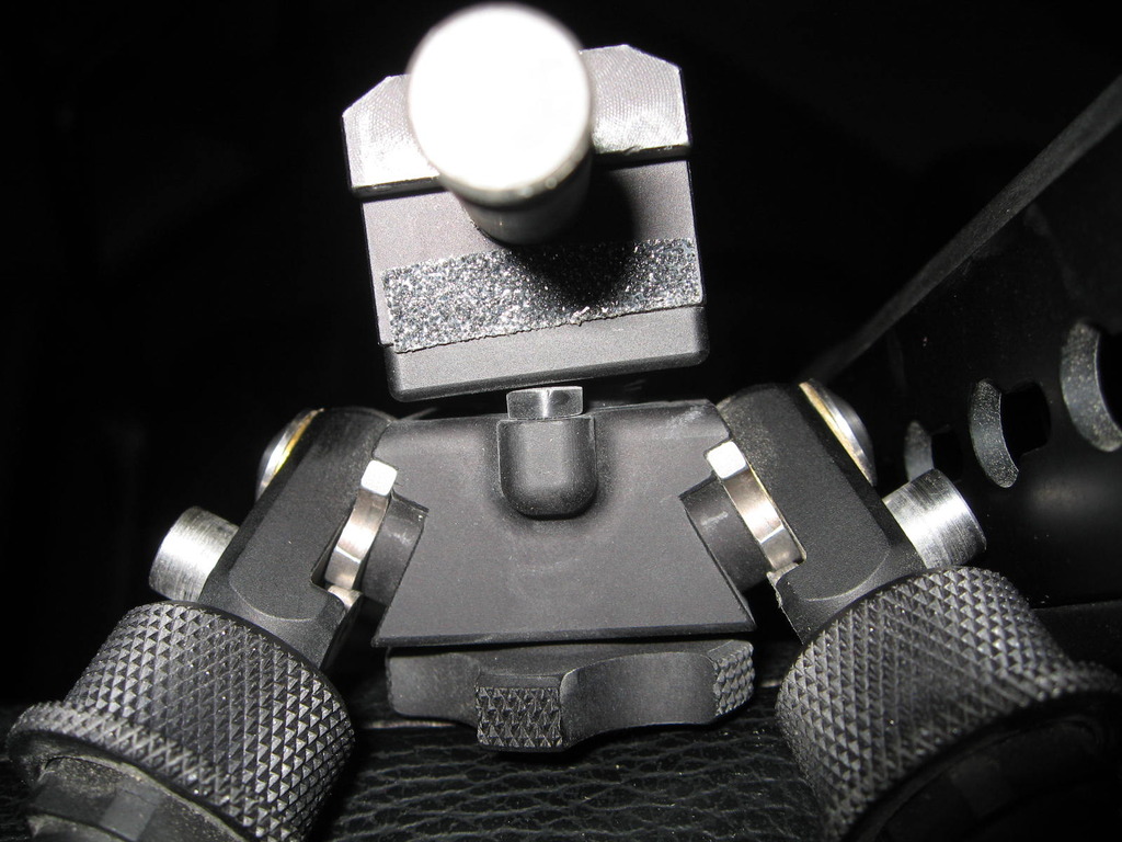

Skate board abrasive tape. Costs nothing. Takes the slack out. When it wears out, you replace. You can buy a roll that will last the rest of your life for < $10
Reactions: DOA
Thanks. I have some skateboard tape and some emory cloth at home. I'll give that a shot before I get the anarchyoutdoors mount.
Reactions: Nik H
Yup. This is aggravating but the grip tape mod does work.

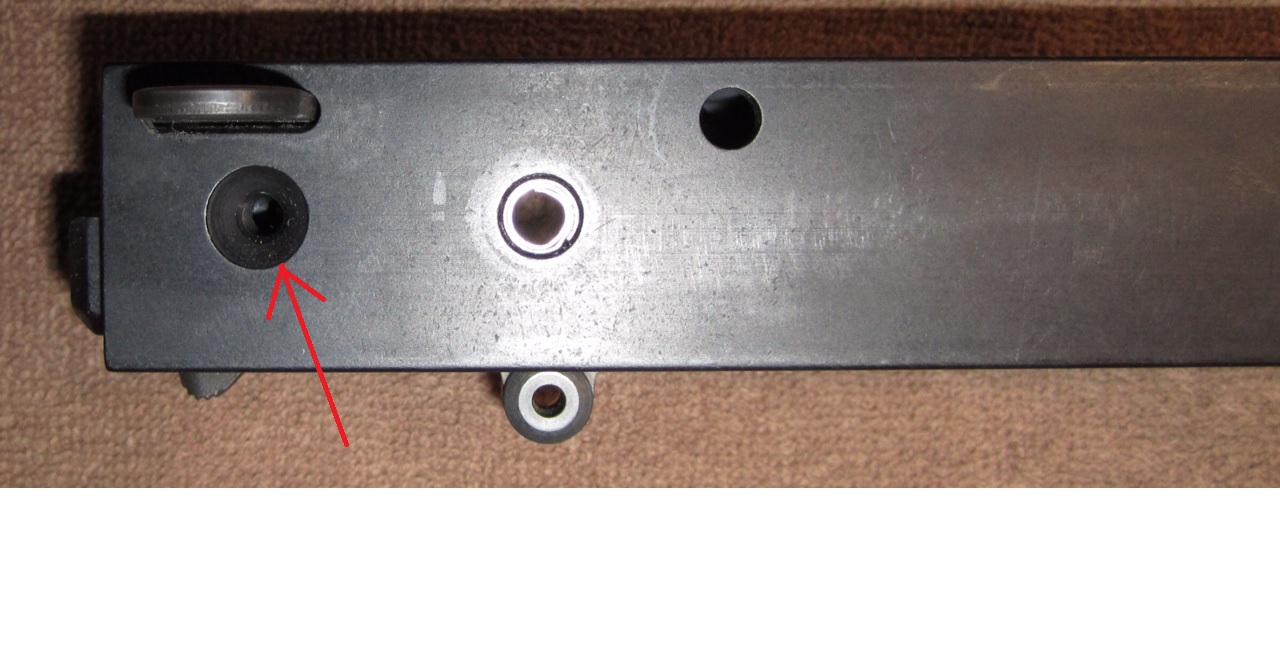

I have an MKII though, I read somewhere that I would have to counter bore the existing hole to work with the anarchy outdoors spigot? Is this accurate? Can I just use a washer and a fastener with a lower profile head?
Hehe man. I've been watching since of your engineering efforts and its fantastic!.
Thanks!
I think there's some confusion on this. The legacy rifles and R700 chassis (AE, AW, AICS) which utilize the HK hook sling mounts have a specific mount for them, called the "AE Picatinny" and "AE Arca Swiss" on the Anarchy page HERE.
As long as the chassis has the front countersink hole, no modifications are needed. If it's an older gen1 chassis which doesn't have the front hole, then a few minutes with a mill or at a gunsmith is all that's needed. I've had guys with old AW's and even AW50's do this modification with no issues. I've attached some pictures and the machining print for reference.
For users that want to use QD flush cups on their legacy chassis instead of the HK hooks, you can purchase a pair of QD mounts from AI (or Mile High) and then install same as you would with an AT rifle during assembly. That would require drilling or dremeling holes in the skins for the QD cups to protrude from.
Hope this helps,
Sam
