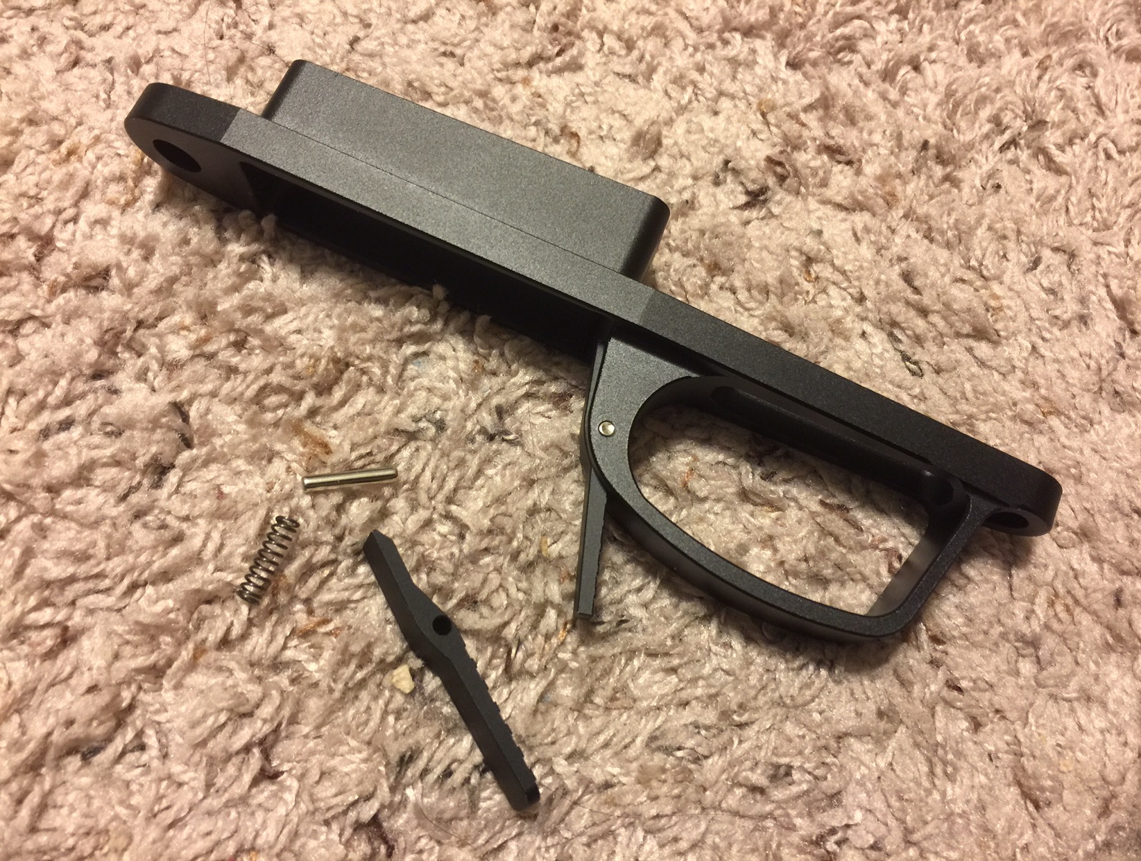

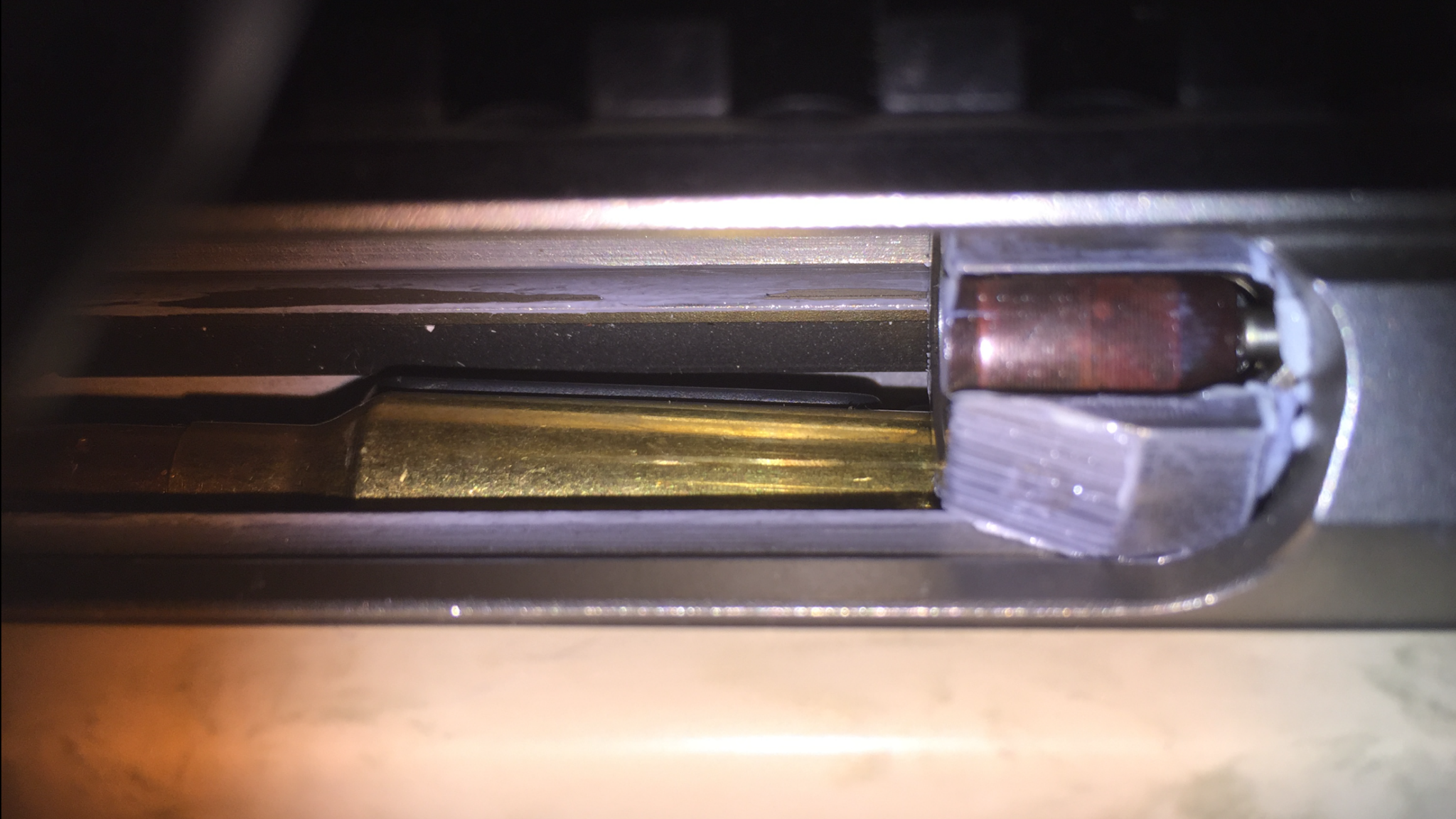

Have any of you tried replacing the magazine release with the other one included in the package that seats the magazine ~ 2mm higher?
The "bottom metal" is already not as flush as one would like.
Here's what's going on...

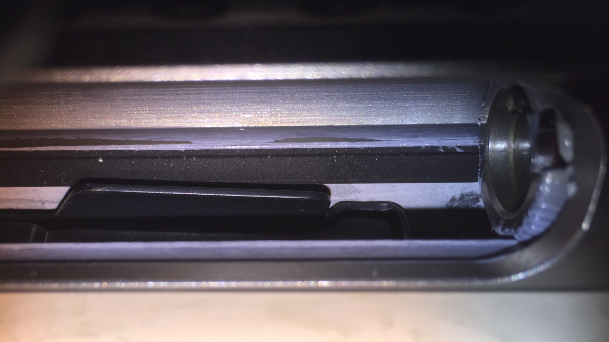

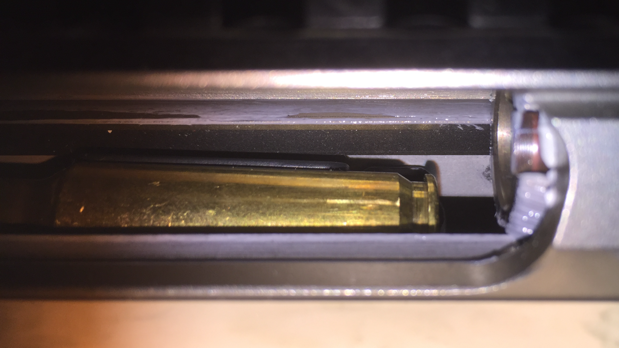

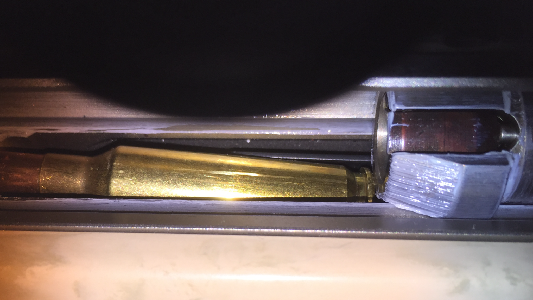

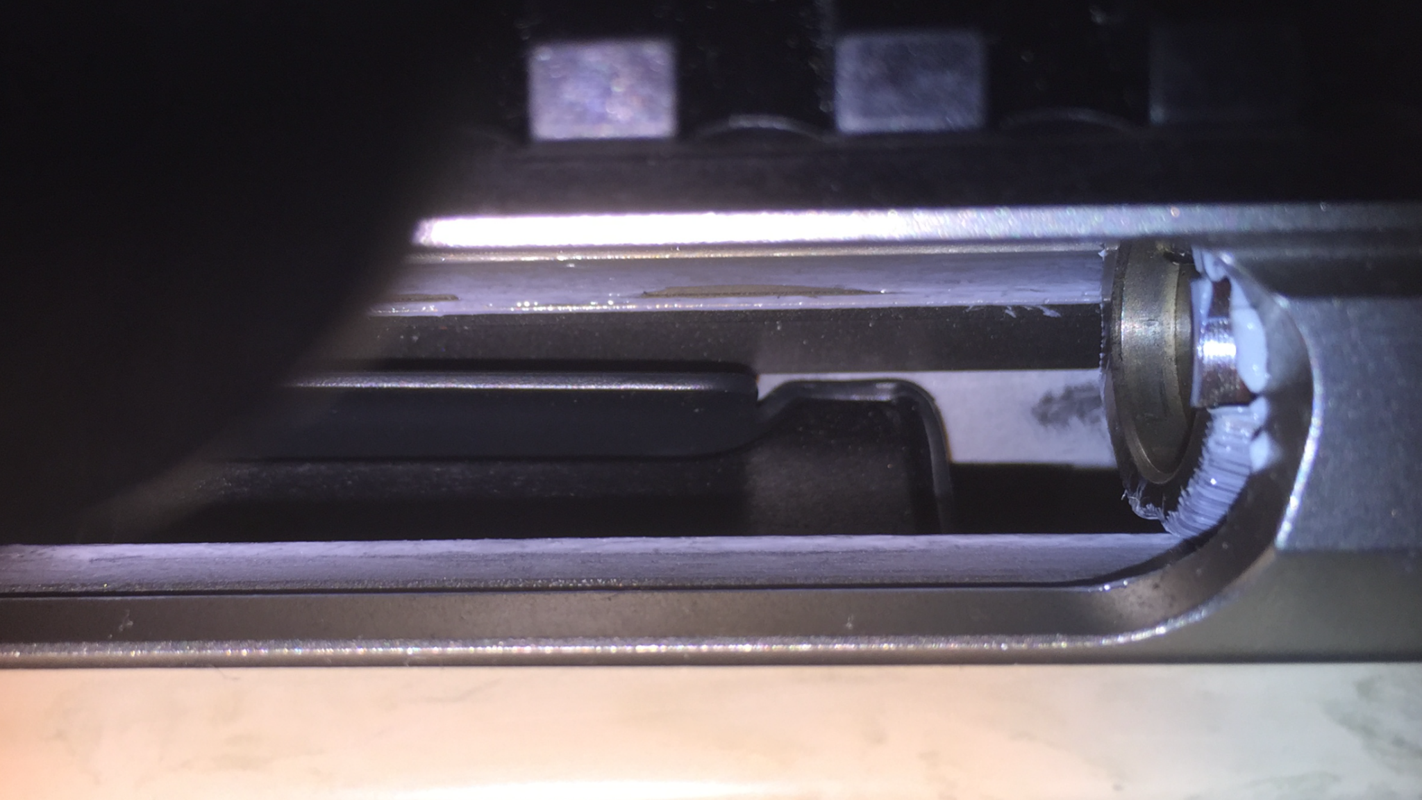

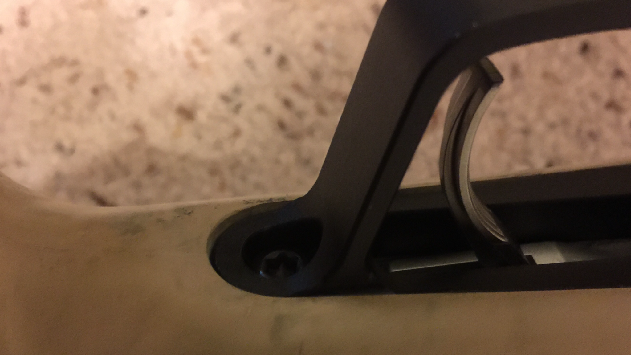

The rear of the magazine (see bolt, right) is ~ 2mm low.
The bolt just slides over the case head.
Raise the magazine by ~ 2mm...
...and rounds feed just nicely.
I tried driving the (shiny) pin out gently from either side, it won't budge. There's a concave (dimpled) side on the left, and a convex side on the right - not sure if this implies anything.
I'm somewhat hesitant to apply brute force, if there's really a proper way of doing it.
Has anybody had any experience swapping out the magazine release?
Make a hole in a wooden block a little larger than the pin so the punched pin can fall thru once removed. Properly support the bottom metal on the area around the hole on a wooden block, so it’s stable. Line up hole and pin. Now with the dimpled portion pointing upward tap with a punch. The pin should come out. Make sure you’re hitting in line with the pin and not at an angle. Use a starter punch to begin install of the new pin. Flush new pin to bottom metal.
Thanks.
I just got it out.

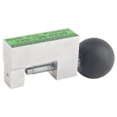

I ended up using this tool to assist - the pin was just much tighter than I expected, compared to others I’ve done.
