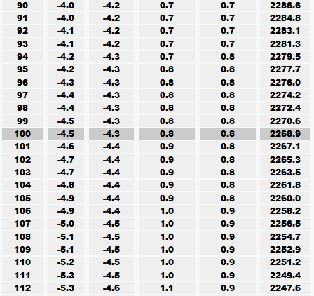

As an example using JBM's default environmental settings and a Sierra .308 168gr MatchKing at 2400 fps:

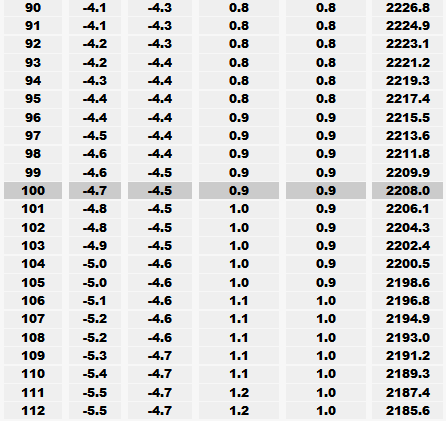

Same projectile at 109 ' F and 1 fps per degree increase (2450 fps)
It isn't even 1 click on most scopes.
