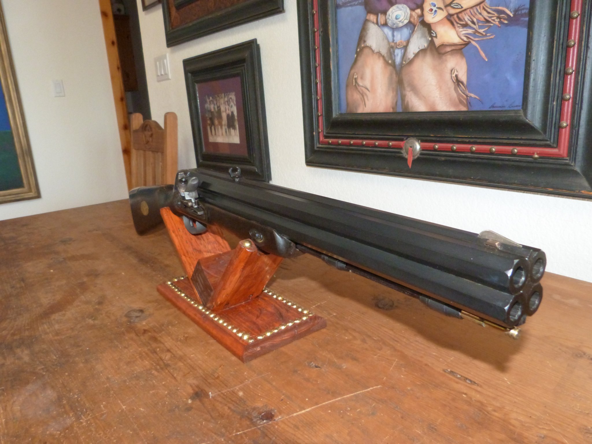

    BW... as always, your hand-work is amazing. That Volley Gun you made is incredibly difficult.
    I've thought that it would be fun to make a bridge volley gun. Needs about $3,000 worth of barrels, though. Just to start!

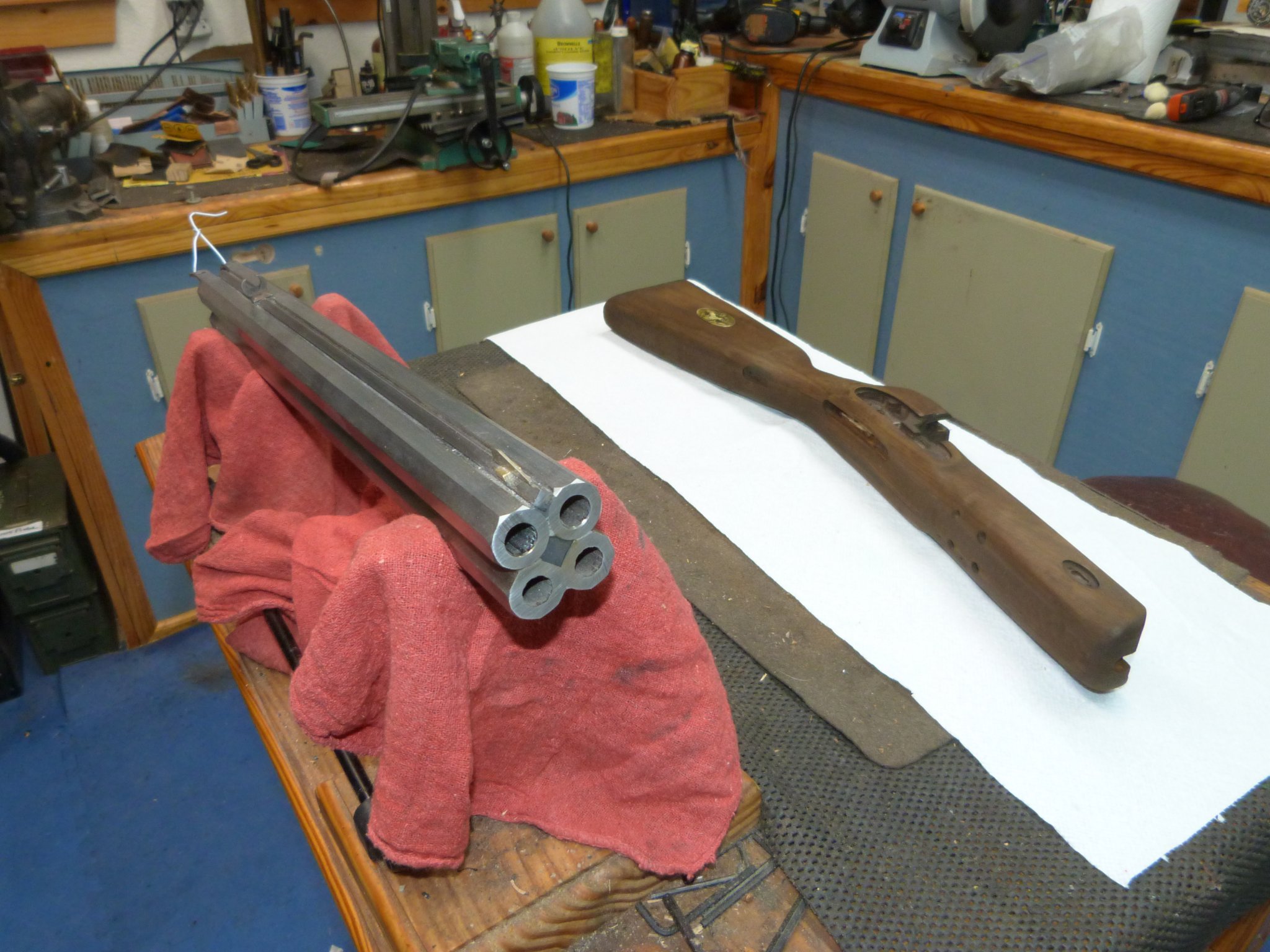

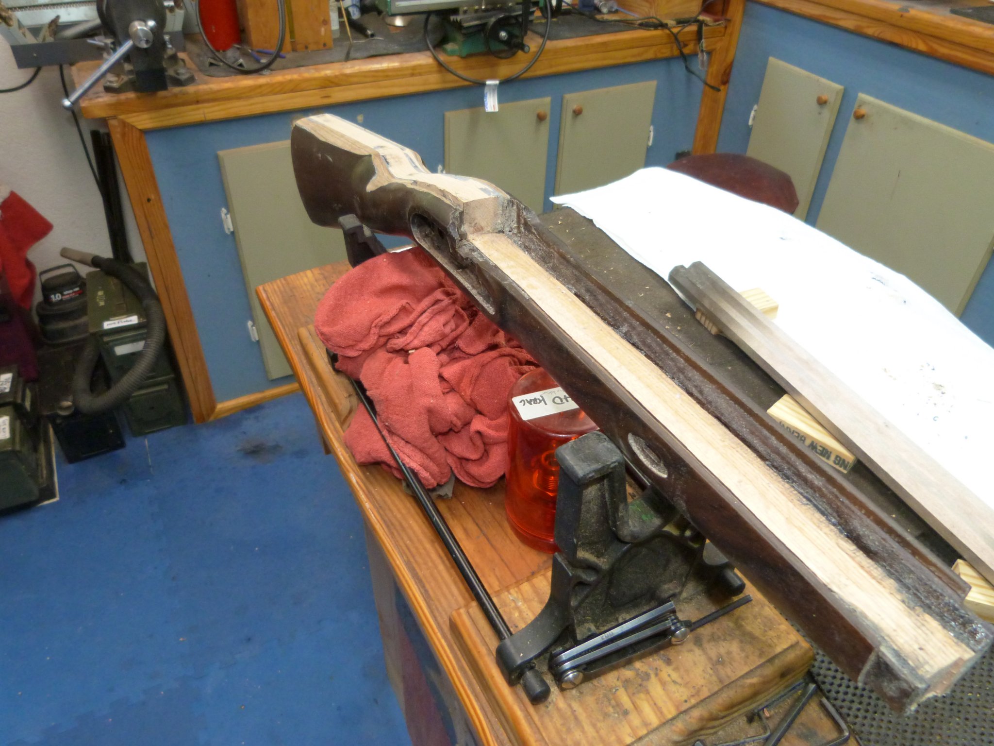

    Unfortunately, one of my most spectacular failures. I test fired it with reduced charges and all went well. The barrels were silver soldered together. When I went to a full charge...these were .54 caliber...the torque from the barrels firing one after another in a circular pattern resulted in a catastrophic, albeit spectacular, failure. All barrels separated and went flying and the stock was ripped into splinters. All caught on video, since destroyed. I gathered all the pieces and rebuilt it with metal bands securing the barrels. Same result. If I ever try again, the barrels will be welded.

    Paracord? My life experience has been such that test firing a new weapon doesn't even register on my "danger" scale. I was shooting from my shoulder at a target and my wife was a few feet away videoing. My only concern afterward was for my wife as those barrels separated and flew to both sides. She was fine and I was ok, a few scratches on my hand. But seriously, I have test fired weapons using cord tied to the trigger. I had already test fired this with moderate loads with no problem. When I rebuilt it, and test fired it, I did use a cord to pull the trigger.
