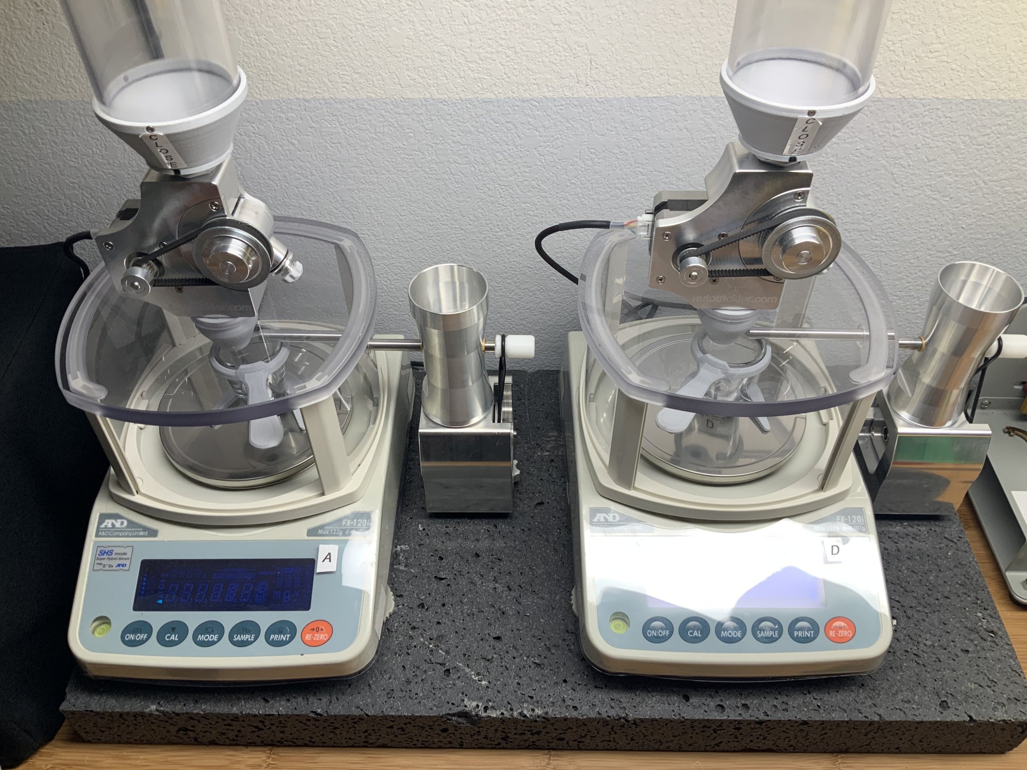

What size surface plates are the best fit for the autotrickler v3? I’ve researched and it appears a 9x12x2” will work. Pics of your setups would be appreciated.
I have that size and it works well for a smaller work area. I'd probably get a 12" X 12" if I had more room. I'll post pictures later.

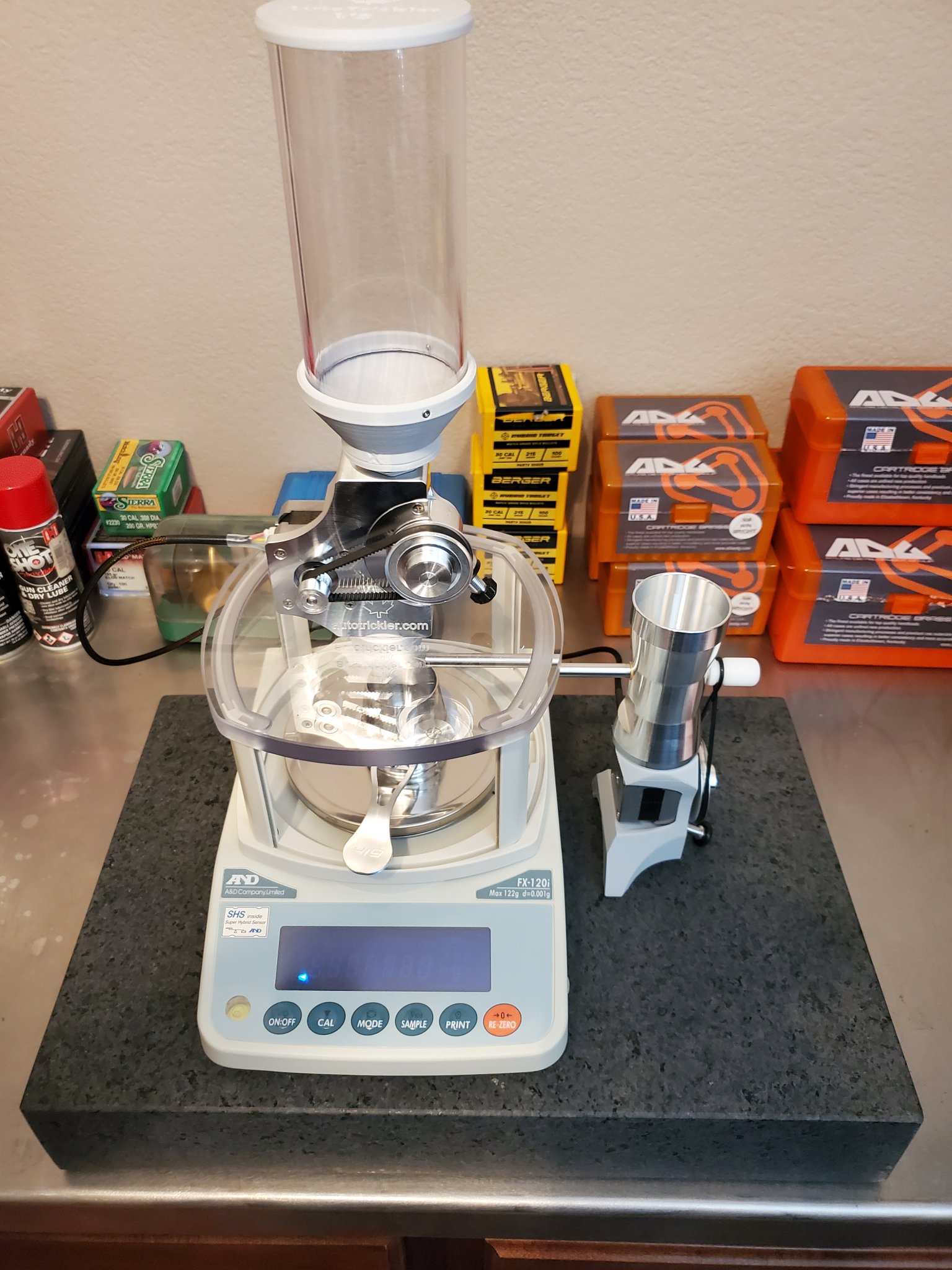

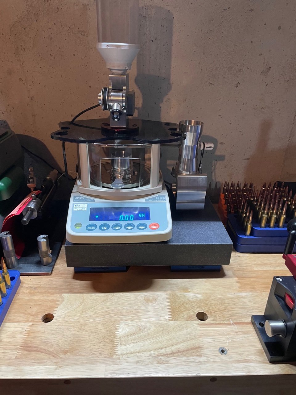

The Autotrickler V3 on a 12" X 9" slab.
