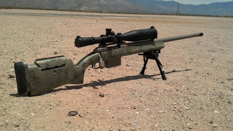

I'll be damned. I thought my recent semi custom Savington 260 was going to be way too heavy to use in such competitions, at 15.6 pounds - everything but ammo in the magazine. Guess not!
-don't compete (in prs at least)
-Modified savage fcp-k action, modified bolt/handle/extractor cam
-modified hs precision tactical stock
-Krieger 5r 8.5tw heavy target, 26", apa little Jimmy brake, chambered 260rem
-mk4 m5 TMR reticle (6.5-20)
-15.6lbs

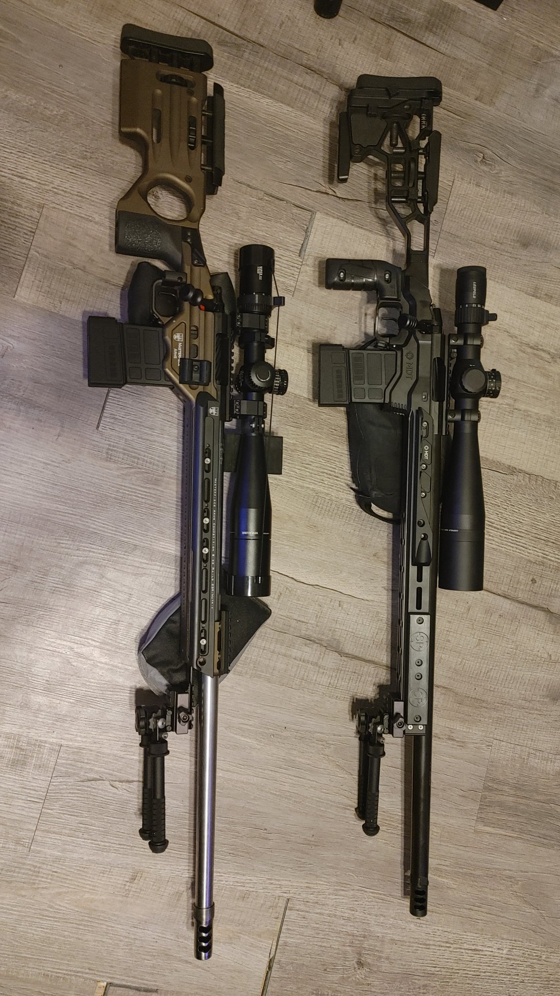

Kinda wild how PRS has changed so drastically since 2013 in what people run. Thought it would be cool to post my builds compared to the builds listed in this thread.
My rifles
Main:
Impact Precision 737r
Bartlein A Team Contour 6XC 1-7.5
Leupold Mark5XHD 7-35x56
Leupold Rings
MDT ACC
TT Diamond
APA Lil Bastard Brake
Rear Weight, Steel Rider, Baker Wings, SP Double Weights, Internal MDT Weights
Weight: 25-27lbs
Back up:
Defiance Ruckus Tactical
Bartlein Heavy Varmint 6BRA 1-8
Vortex Viper PST Gen II 5-25x50
Vortex Pro Rings
MPA Matrix
TT Diamond
Hellfire Brake
Internal weights, rear weights, and side rails
Weight: 23-24lbs
