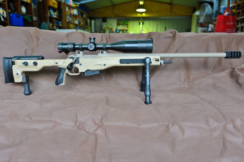

This is a bit of a blast from the past. I lost my old login with the changes on the forum but that was me. Yes, I got the rifle finished using the AW mags, it took a bit of work changing the shape of the mag lips so it fed spot on but it came up really well:

thank you for your answer,nice build!
