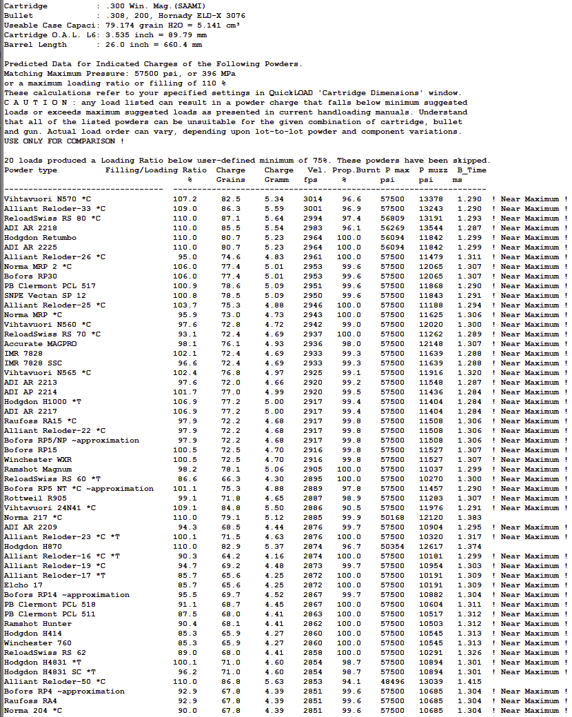

Wish I had noticed earlier, but I need the COAL to the bullet tip, not to the ogive.
Also just realized my version of QL doesn't have the 195 ELDM, but I can use the 200 ELDX which should be very close for a sanity check.
My bad bro, 2.535
My bad bro, 2.535
I'm going to guess you meant 3.535...
Anyways, here's a charge increment table using a 200 ELDX and the Ba of the powder trued to your lot of H4831 as a rough estimate what's going on. Again, a tight chamber, short throat, tight bore, carbon ring, etc, can all cause pressure to be higher than this.
And here's a table of velocities of various powders if you loaded to a 57.5ksi target pressure or a max fill of 110% (whichever is hit first) to see how different powders would perform.
As you can see H4831 isn't ideal for your case/bullet combo. N560, N570, RL33, RL25, RL26, Retumbo, H1000, and quite a few others would provide a lot more velocity at the same pressure.
Hope that helps.
