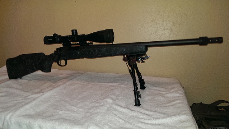

I just received my Bell & Carlson M40 stock by the big brown truck from Red Hawk Rifles in Colorado. It's going on a m700 .308 AAC-SD. I got it switched out during my lunch break and it looks break. Stock fit the action great, and barrell is completely free floating (paper test). MUCH better IMO than the Hogue stock that it came with! Just need to get out and shoot it to really test it out.
BTW this stock was only $257 including shipping from RHR. Ordered it Friday and it showed up today before lunch! GREAT customer service also.
Great looking RIG. Hope mine turns out that good. Although I got the "hook" 2956 in olive green with black webbing. I'm going to be PISSED if my barrel isn't floated. That's the whole problem I got with the houge. That and no bedding

Got it put on and I must say DAMN!! THIS THING FEELS GOOD!! It feels a lot better than my 5r or my Police HS stocks to me. Very impressed.... Dropped right in.... Barrel is totally floated .... Ready to test it out !
