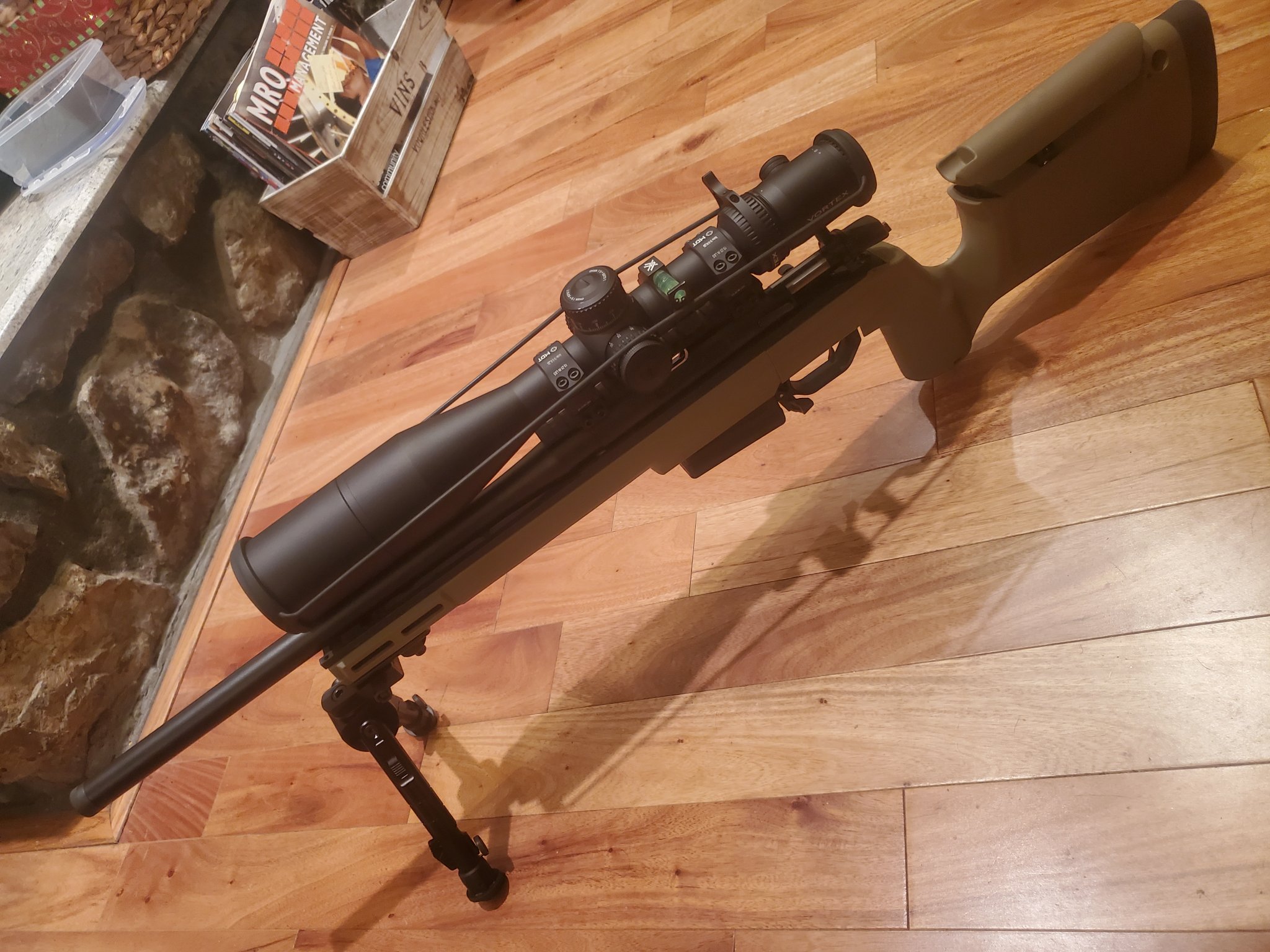

So i had a krg bravo stock on my 700 and wanted a better 22lr bolt gun. Got a bergara b14r ordered in and went to order another bravo so i could have one for my 700 and one for the b14r and saw krg says the magazine fitment wont be right. Well, its true. When the bergara action is in the krg stock the bullets dont tend to be lined up perfect and you have to tap the front of the mag up into the gun each round. Works fine on the 700 with 308 but not the 22lr. Has anyone been able to make a b14r work in a bravo?
Thinking about looking for a bergara b14 hmr stock/mini chassis take off so that the action/mag/stock are all the same and play nice. Are people having any issues with all bergara guns?
I regret getting the barrelled action at this point and should have just got the complete gun but a copy/trainer of my bigger gun sounded fun.

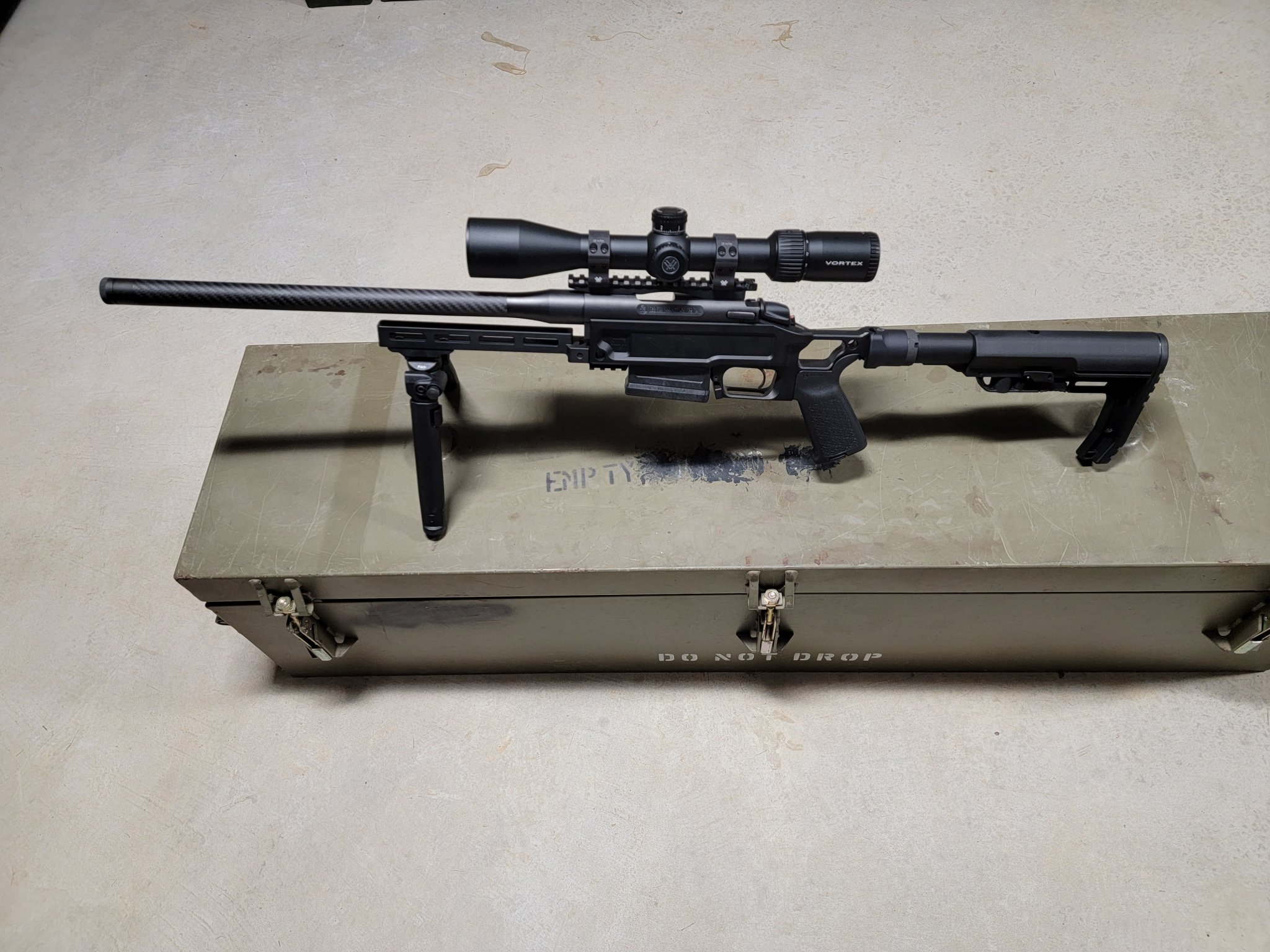

I am surprised you are having issues mate. I've got my B14R in a KRG Xray chassis and never had a problem. I don't think the front end of the bravo and the xray are any different.
Have you tried a different magazine?

I use a KRG with the B14R and had feeding issues at first. The trigger guard needs to be adjusted until you get it solved. In my case my mags are really tight in the magwell. I haven't had any feeding issues since I adjusted it. Ran it all year without issues.
One or 2 washers between the chassis main frame and the trigger guard ?

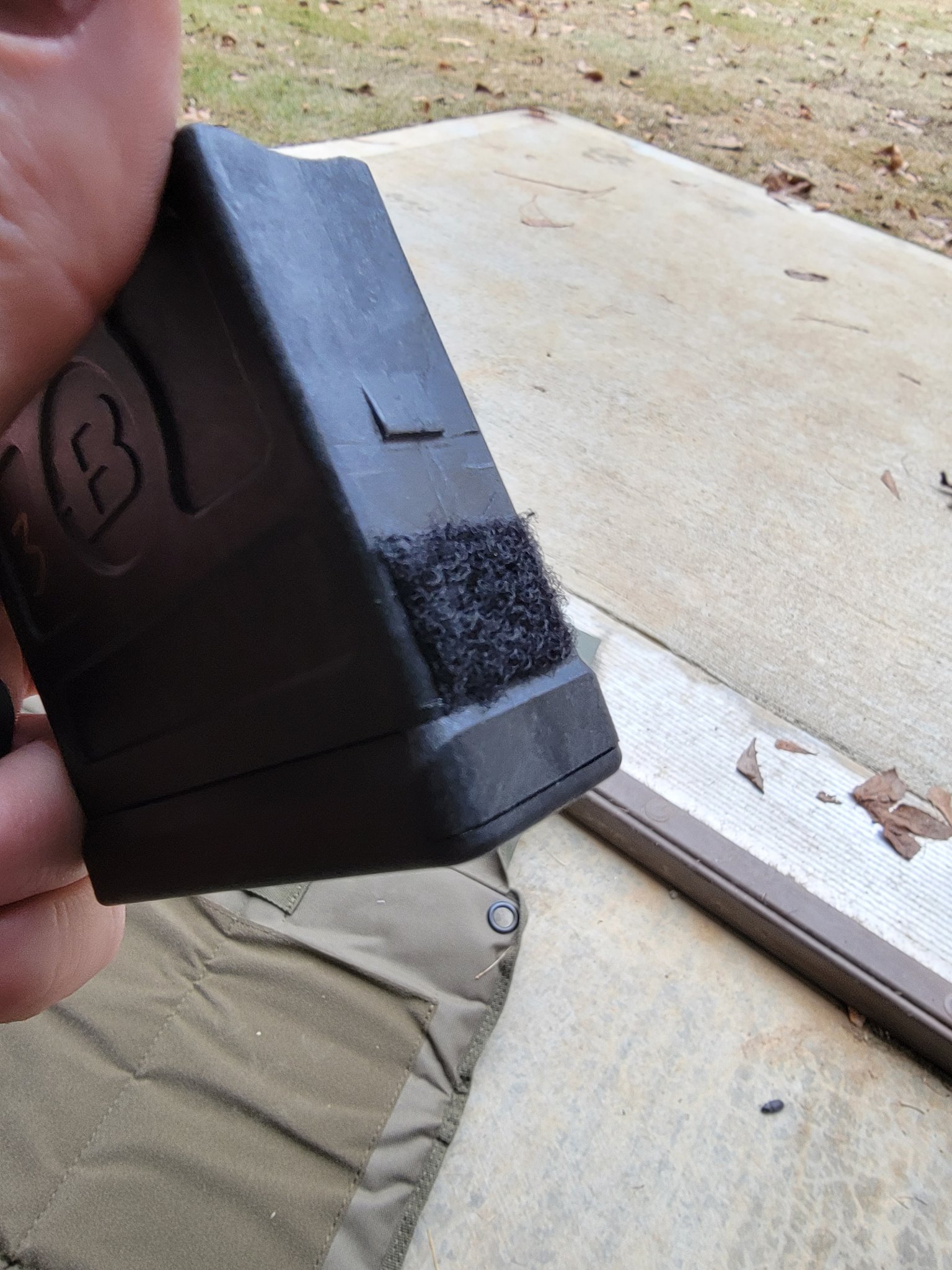

Currently running the b14r barreled action on a pork sword chasis. I was having the same issues with the magazine. A small piece of stick down velcro to the back of the mag and problem solved. I still have some minor velcro adjustments to make to get them to work 100%, but sitting around 90%-95% accuracy right now. Found this valuable fix on the site.
