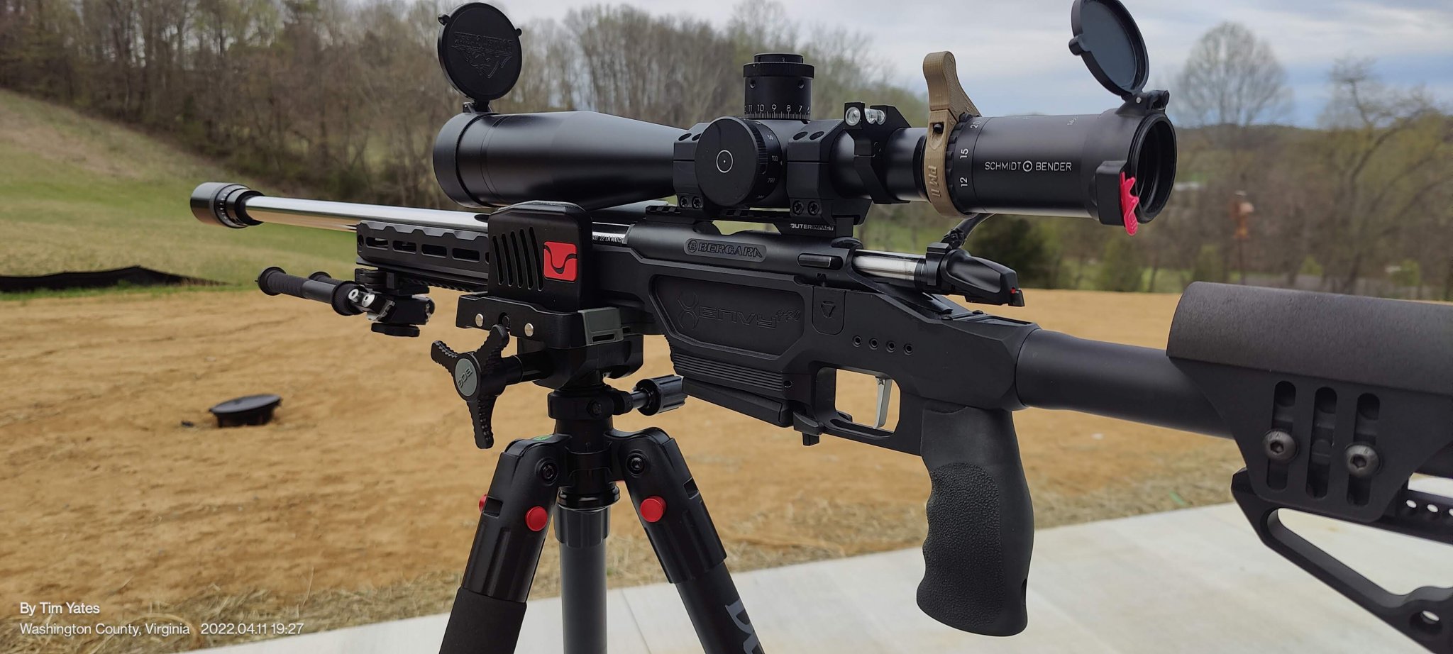

Looking at dipping my toe into the NRL22 world. Have a Bergara B14R carbon and can use some advice setting it up. Planning on keeping it in the factory stock for now. Have a Trigger Tech Diamond trigger coming in. Looking at a Seekins 20 MOA base. I think I'm going to put a Razor Gen III 6-36 on it. I know it's too much scope, but I haven't mounted that on anything yet so it's the easiest for now. Any advice on ring height? I've had good luck with Seekins on my other rifles and would prefer to stay with that brand. Any other suggestions on how to get going? I've already scheduled a lesson with someone who shoots in the series.

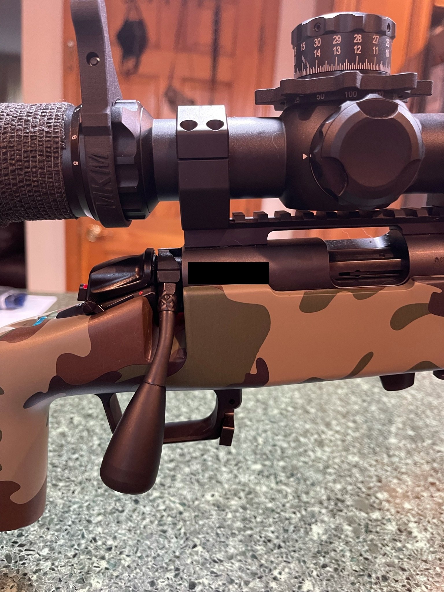

I'm using Seekins High Rings with an Outer Limits 20 MOA base for this S&B 12-50x56 PMII and have plenty of clearance. Good luck with the TT Diamond, I had one and it didn't work good in my B-14R, I ended up going with a Bix TacSport Pro as shown.

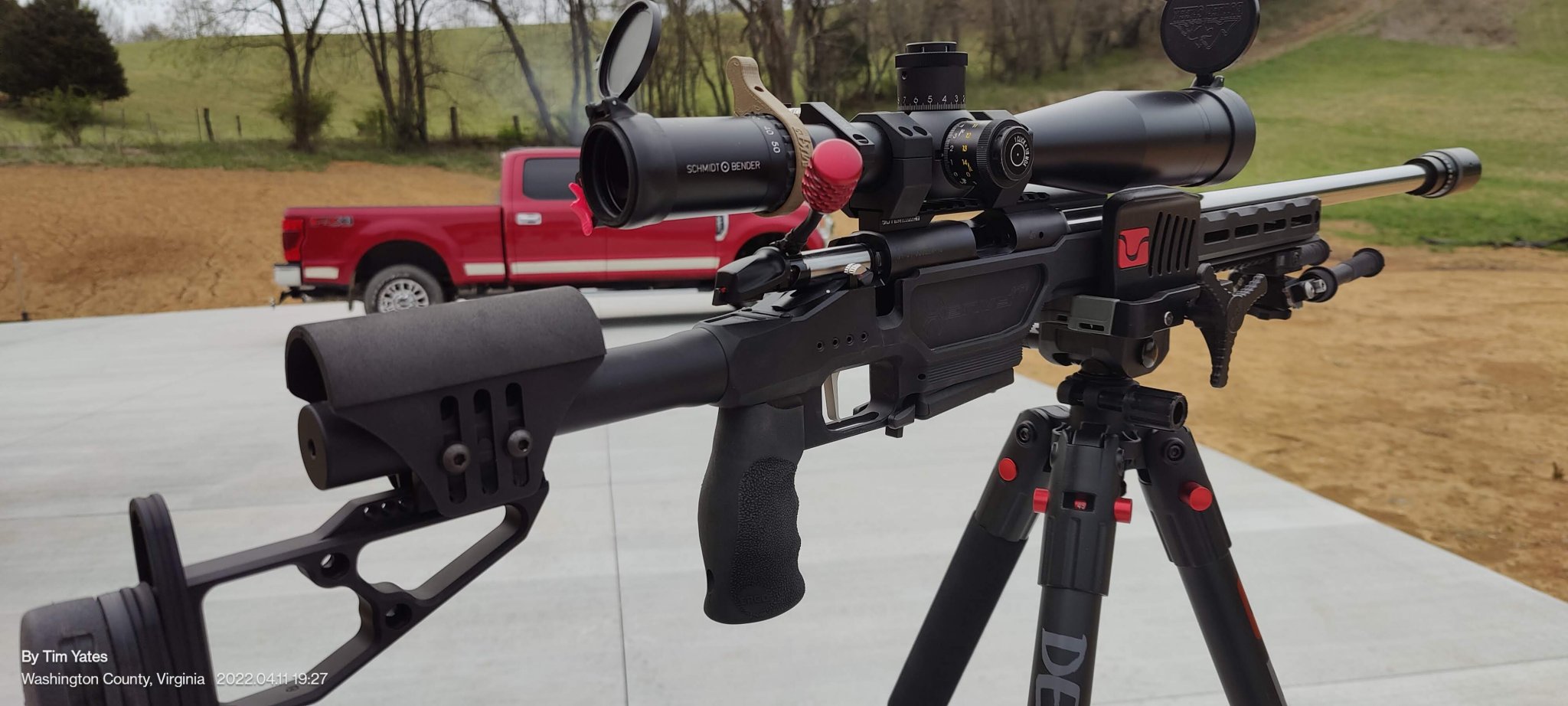

Rings to fit the chassis from the .308 that was in it "TPS highs". The taller the better with this chassis set up. Cut down PRI 20 MOA N.V. rail for a scope base.
This set up worked great for my daughter to shoot locally. Being able to adjust everything on the fly to fit her and then me was a perfect.

I have 2 B14R in factory stock, with TT Diamond. set up with 20 moa base, Burris XTR Signature rings with 30 moa in the inserts. Vortex Strike Eagle 5 X 25 with this set up I can dial from 25 yds to 500yds. There is no limit, on scopes with a rimfire, just the money you can spend. you can use 1" to 1.24" XTR.

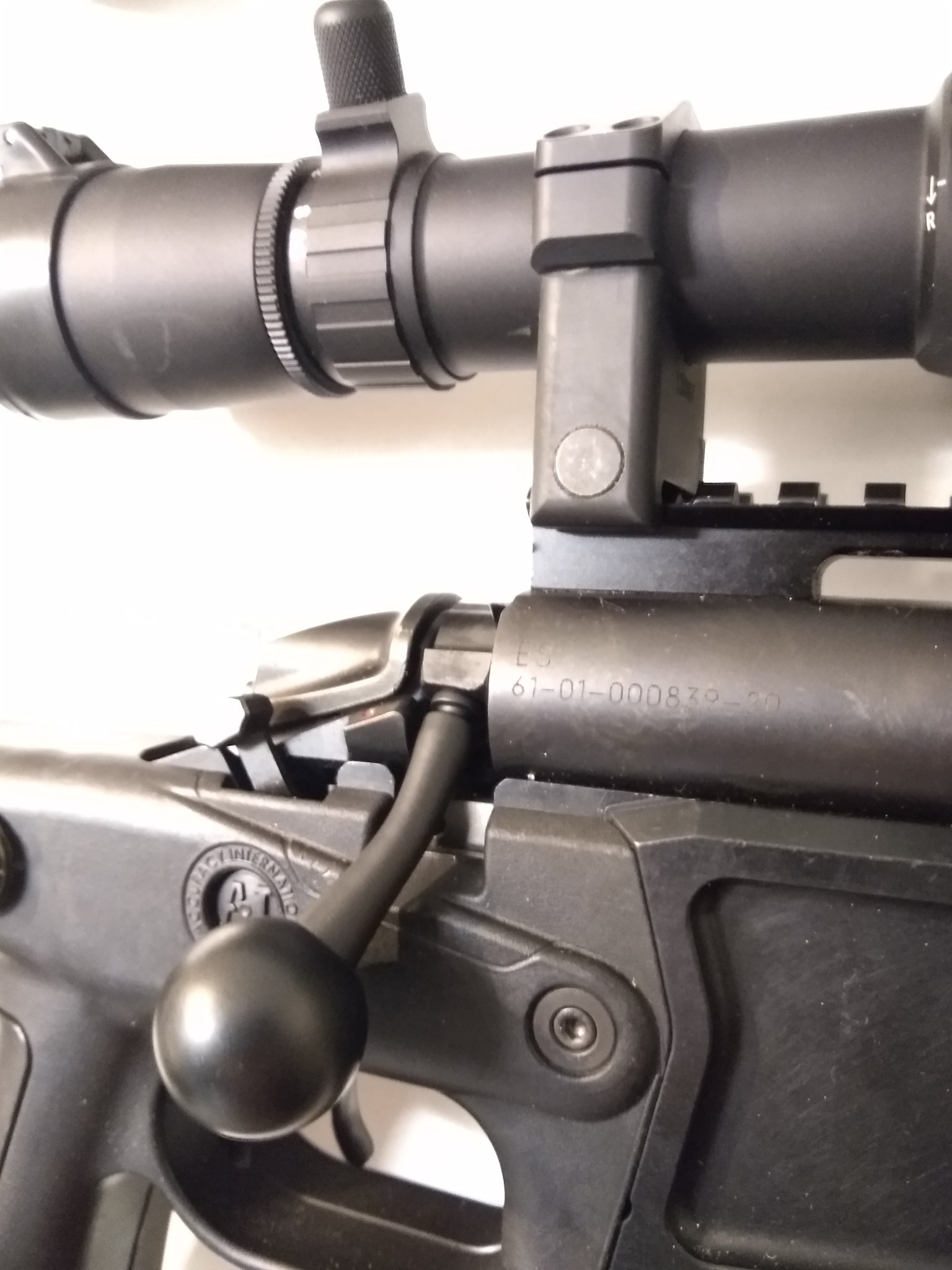

I have Seekins .92" on my B14r with EGW 20MOA rail and a Kahles 5-25x56. It clears with a Tenebraex cap or a DFAT on the objective bell.

With this set up I can dial from 25 yds to 500yds.
How can I figure out how far my adjustment can take me? 36.1 MRADs of total elevation, 120 MOA on the scope.

The strike eagle has 31 mils. If you use moa in the rings inserts, you should be good to 500yds. I have 2 mils to go down and 29 to go up.

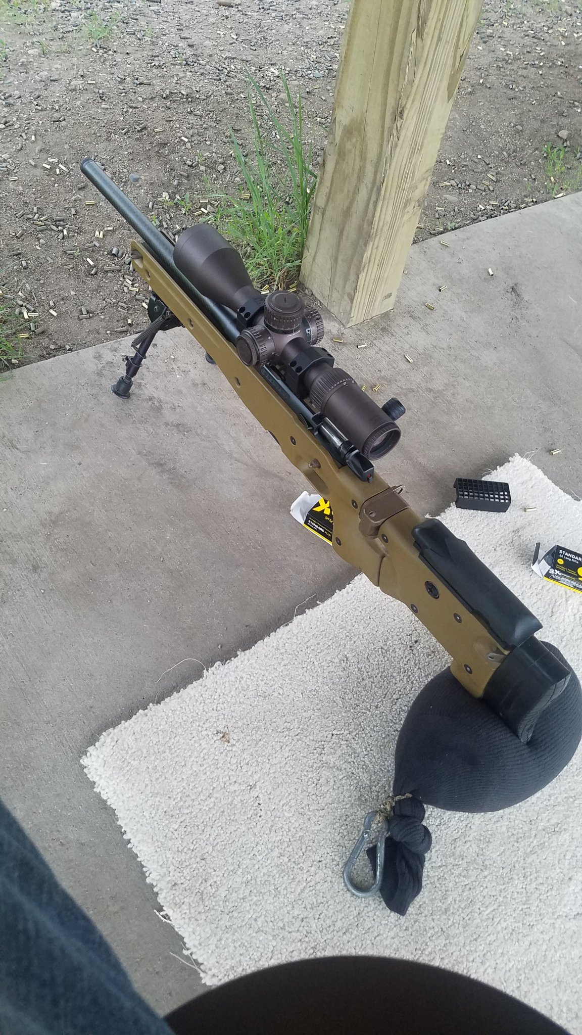

You might wanna find a arca rail for your gun to give your factory stock a wider footprint for barricade work. Or consider swapping out the stock.

I’m running that same scope on my b14r in Seekins 1.26” Extra Height rings on an EGW 20MOA rail. Could probably go a little lower on the rings. I’m also running a TriggerTech Diamond 2 stage with no issues at all.

I was concerned about clearance with the 56mm objective and barrel and also wasn’t sure if the night vision bridge on the chassis would be an issue if I went too low. Probably unfounded as there’s a good size gap there. The height under the scope tube is just enough to get my data card holder onto the pic rail so not sure lower rings would allow me to do that.
I went with the two stage out of habit…tens of thousands of rounds of 3pos smallbore on Anshutz model 54 actions with two stage triggers back in the day. This is a different sport but old habits die hard 😉
