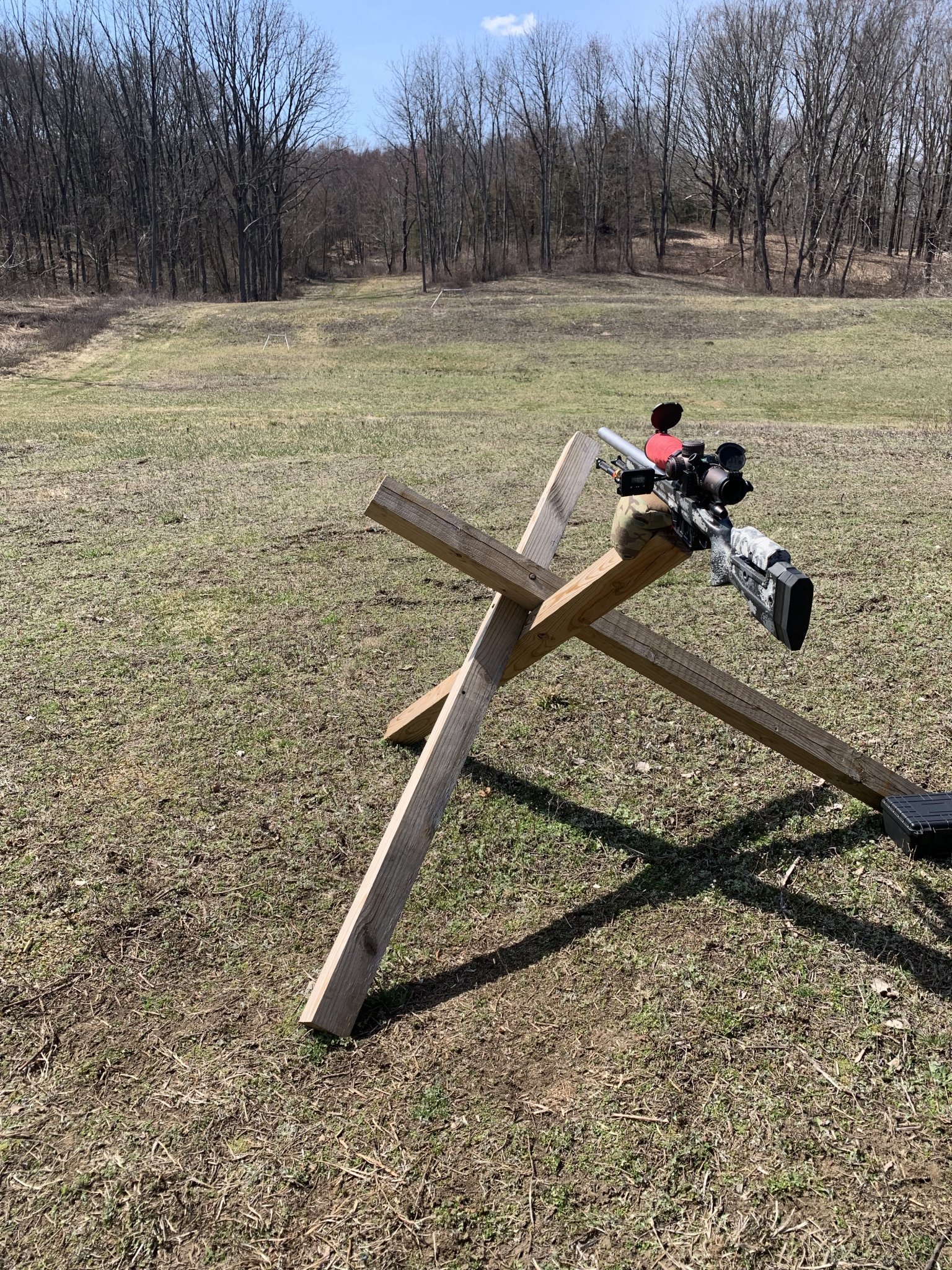

Great info. I've got an MDT ACC chassis with Ckyepod and barricade stop on my main rifle, so I can "borrow" some stuff from that for the B14r. Plus I have a GroundPod with ARCA now that I think of it.
I’ve got mine in a KRG Bravo to match my backup match rig, and I don’t have any issues others then the occasional mag issue but that’s just because I haven’t spent the time getting them dialed.
A 20 moa base should do you right but a 30 would be a little better, with the strike eagle you can probably get away with even more.
This was before the swap to the bravo to free in the manners for my rimx

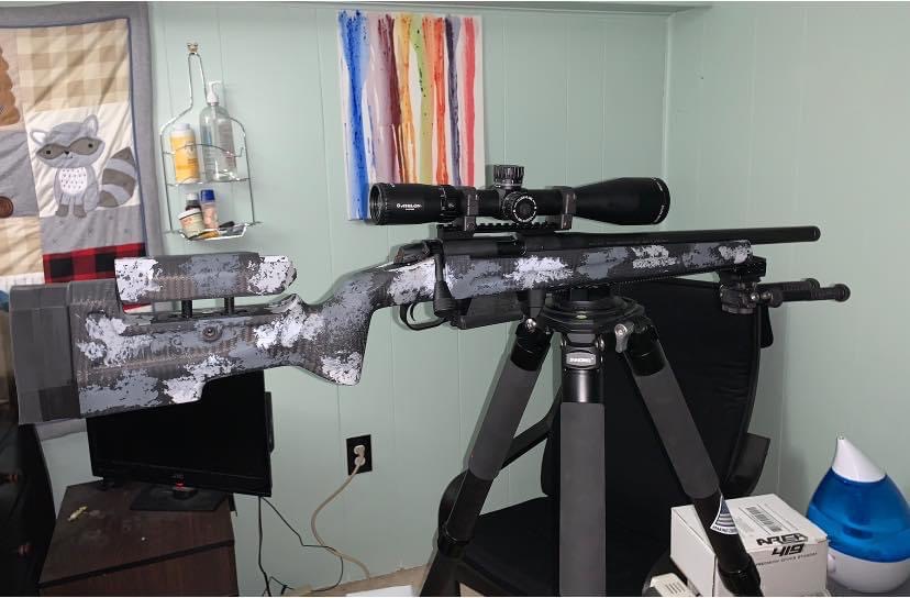

I see you did a budget build on this.
Yeah, I was bored during the Covid break. I built it up as if I wouldn't like the Bergara and swapped it out for a Vudoo or RimX...that never happened. I don't even want to talk about the current CZ/Manners build I'm in the middle of.

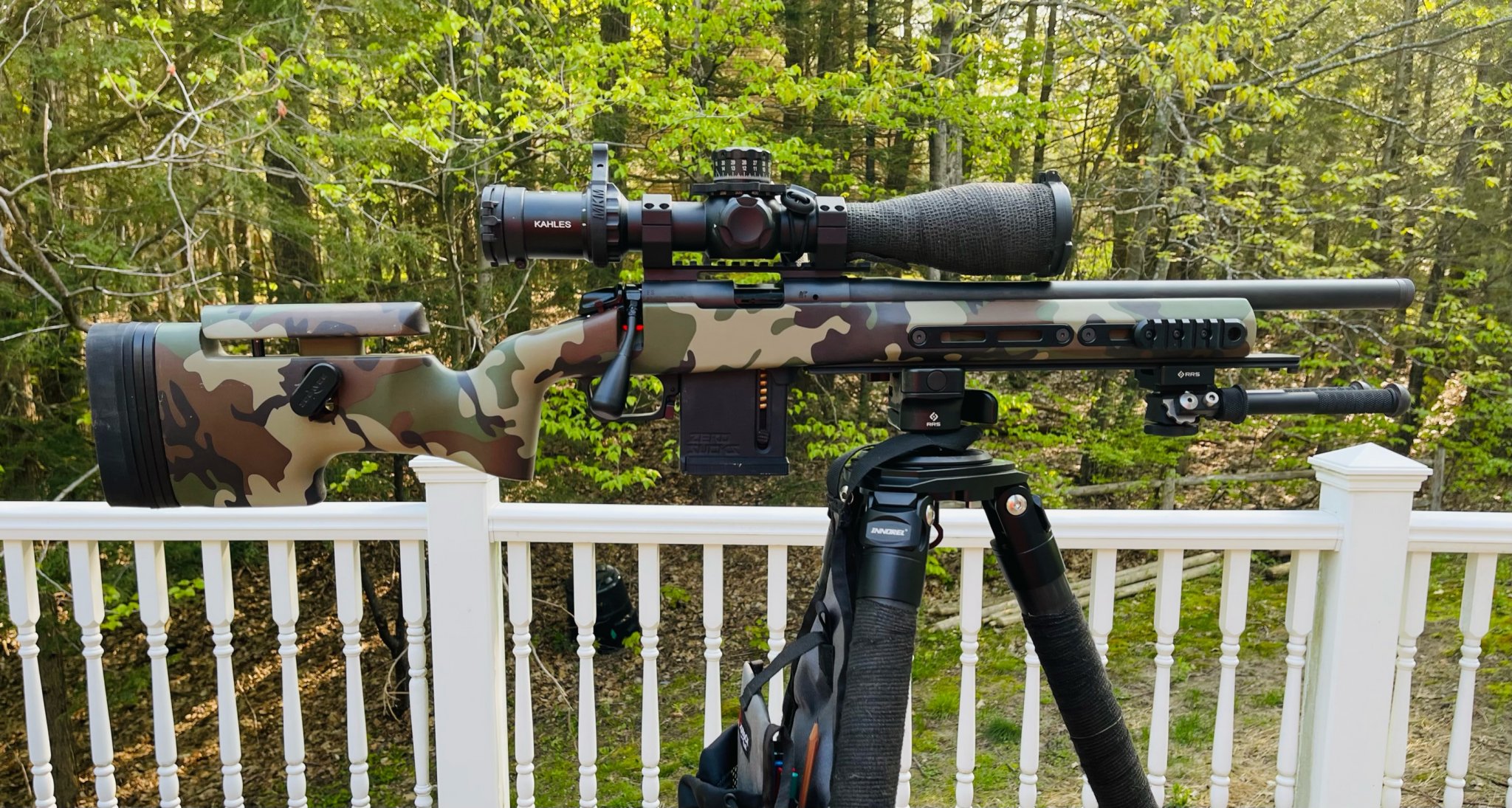

My B14r (factory stock) has 30moa rail, 5-25x Strike Eagle, TT 2 stage trigger, Harris bi-pod, and makes for a formidable PRS/NRL rifle. I also use mine for rimfire F-class. Nobody I have ever talked to said they dropped points because the needed a more expensive bi-pod over their Harris. To each their own.
Mike

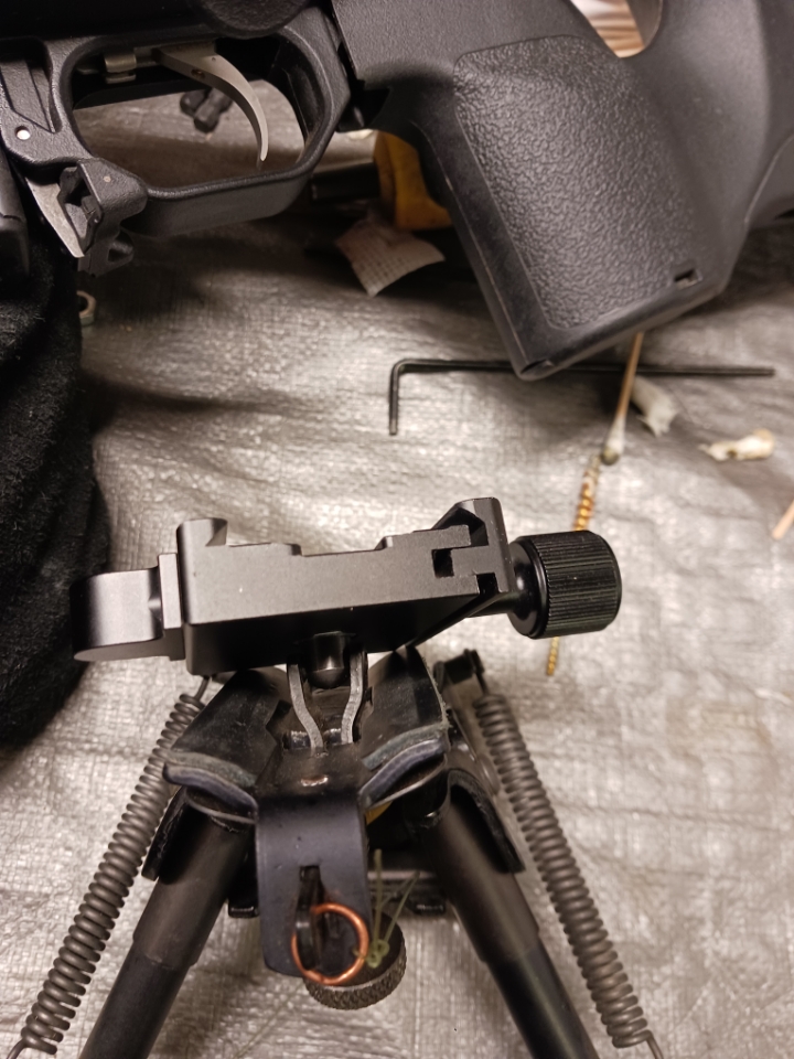

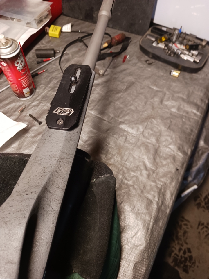

I like it so far, it's pretty solid. I added an arca rail and an adaptor to the bi-pod. I went the arca route to share some of my son's stuff at shoots. Otherwise I was pretty happy the way I had mine setup.
Mike

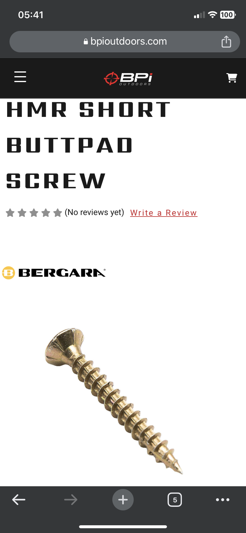

Tried to remove a few of the pieces to shorten the length of pull. Evidently you need shorter screws and Bergara is out of them at the moment.
Anyone know what screws match the pitch of the screws in the stock?
If I remember correctly they are essentially just deck screw meant to composite materials.

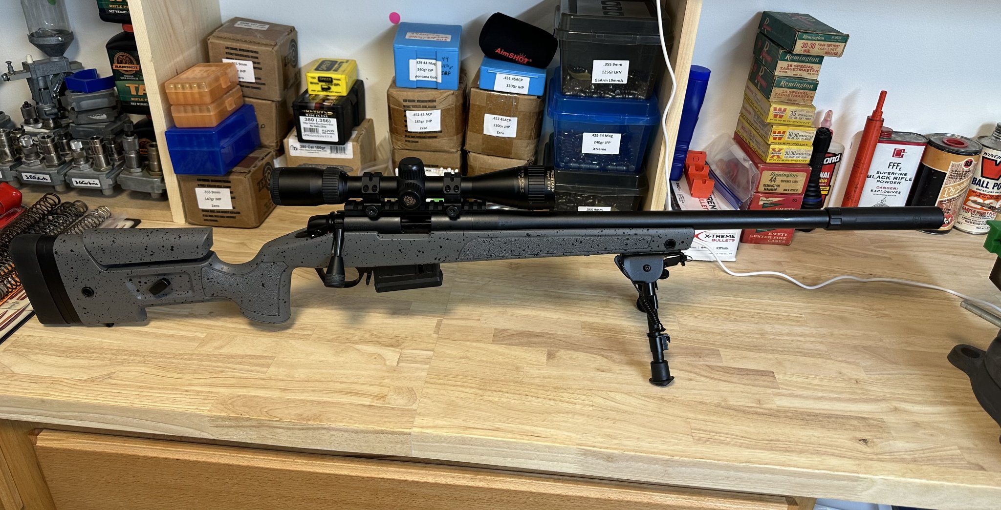

This is my B14-R
Currently has a 40MOA steel NightForce rail, and zero MOA unitized rings. I’m not running a zero stop, and have well over 25MOA of waste (downwards adjustment below zero). Personally if I had my druthers I’d be running a steel 55-60MOA rail to fully utilize the scope’s adjustment range (and since the rifle doesn’t give up any accuracy at distance).

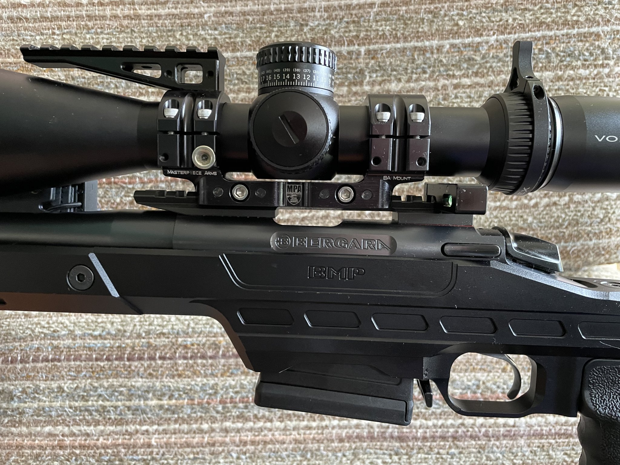

I am a current USPSA shooter who is trying out PRS for the first time. I just bought a B14R (which is something like my 9th or 10th rimfire rifle...but whatever, I have so many the wife doesn't even notice when something else 'shows up' in the gun safe), and I am following this discussion with interest. I have the scope, rings, and rail all ordered based on advise from a local guy who works our matches, and I currently have the bi-pod that came with my Ruger Charger installed on the rifle.
I have looked at the various websites, and there are several items available under 'ARCA' and 'Harris' and other manufacturer mentioned. May I ask if the people involved in this discussion would mind including links or part numbers on the devices they recommend? The bi-pod I have is attached with the crappy sling mount adapter that comes with the Ruger. It's going to work for my first couple of matches because, well, it's what I have. But I would like to see exactly what others are recommending, and I am not familiar with the devices being recommended. Any help with identifying the specific part number would be a great help to me.
Thanks to all.
Thanks to all.
Mount any Arca rail to your B14r, an Area 419 4.25" for $45 will work starting out on the two sling studs,you can buy Area 419 and RRS stuff to convert Harris to Arca.I make mine.I buy multiple Arca plates and Arca clamps from Amazon ,cheap.For $12,clamp and $1.50 for 10-32 sling stud,Amazon,I red loctite the 3/8" -1/4" bushing and the 1/4" screw,tighten ,Using a #21 bit ,drill through the hex key hole,through the bolt,tap hole to 10-32,trim sling stud,loctite the sling stud in.I do mine on a mill,I make the 3/8" to 10-32 bushings by drill and taping 3/8 bolt to 10-32 on a lathe,parting as I need them.
Reactions: davidsaidwhat
Arca rail on Sp with swivel stud
I prefer a full length rail so that I can slide my bipod up close for props like barrel tops. More options is better.
My point was to show folks like David arca choices,some folks,like my 73 year old gunsmith never seen or used one.I run one full length.......,made out of SS,36" for a stop on a cut off and band saw.

So I got a Burris 25MOA rail to install tonight, and a set of basic rings to put a Nikon 3-9 rimfire EFR scope on it till I can get a Vortex Strike Eagle 5-25x. Loctite the base to the rifle? I have purple loctite that I use on a lot of moto stuff, it's not a full on thread locker, but much better than nothing (good for vibration). Or just suck it up and use Blue 242? I just get nervous around tiny bolts and loctite. :)
And I did remove and disassemble the bolt and cleaned the gook out of it and used a better lube (ALG 0000). It's much smoother now and also put a few rounds of better ammo thru it seemed to be smoother as well.
Also will be on the hunt for the correct screws to shorten the LOP on the stock. Bergara is out of them and need to remove the plates to shorten the stock for my daughter. I don't suppose anyone knows the thread or a screw that is correct? I heard they are a screw from composite decking? I'll take one out and take it to the my local Ace and see what they have tomorrow.
As to your shorter screw problem, I have a ton of screws around the shop and found some square drive screws that were the same diameter but shorter. These are not machine screws, but closer to your basic drywall screw. Just use something the same diameter, and you will be fine.

Current setup: B14r rifle, Harris bipod, Timney blue two stage, Burris 25MOA rail, cheap rings, Nikon EFR 3-9x rimfire scope, and my Dead Air Mask.
Next up get Vortex Strike Eagle 5-25. Have a set of vortex pro series rings on the way. Then Area 419 arca rail and I’m done. Really. I can stop any time. Right?
Yeah, you can totally stop at anytime you want but do you really want to
