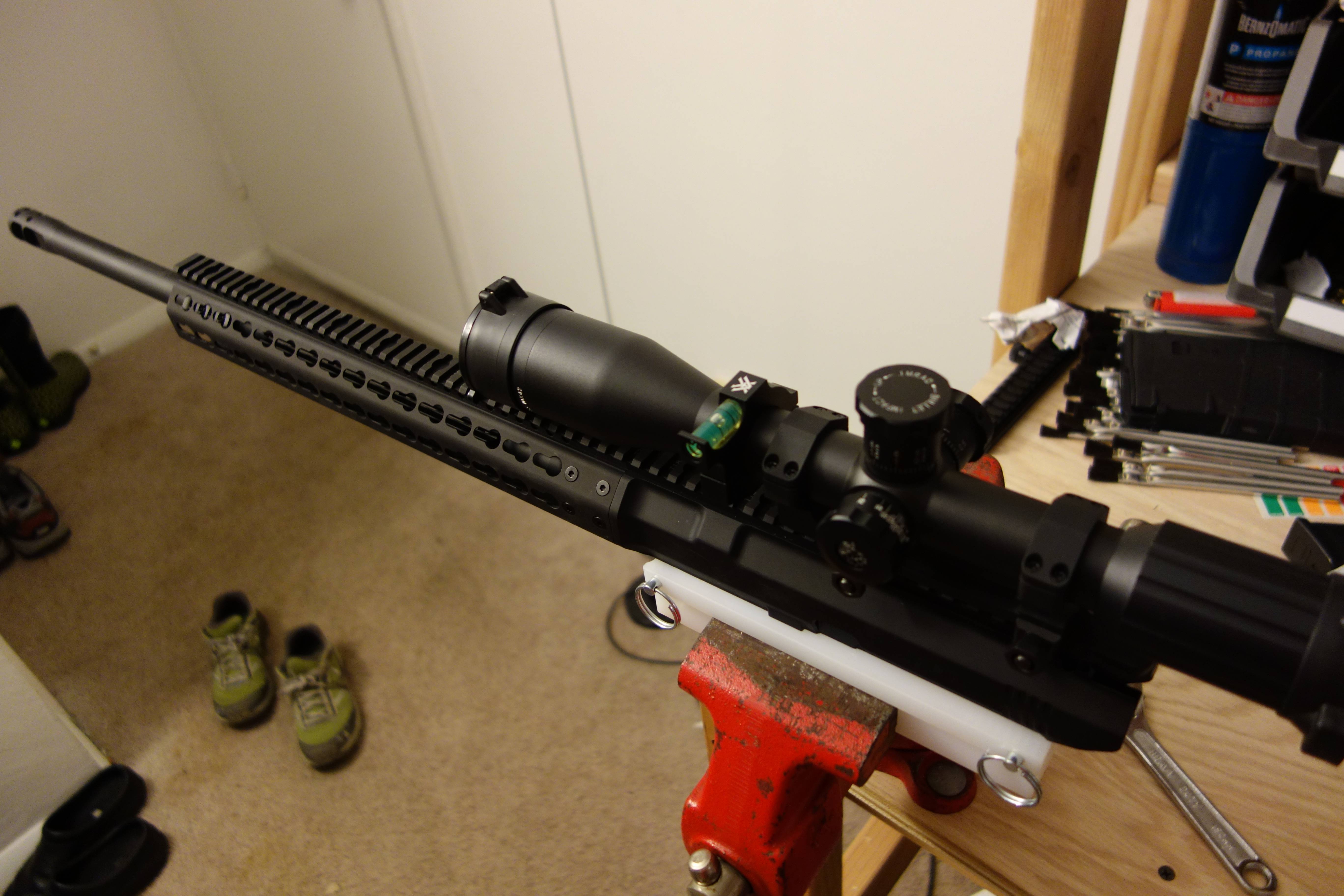

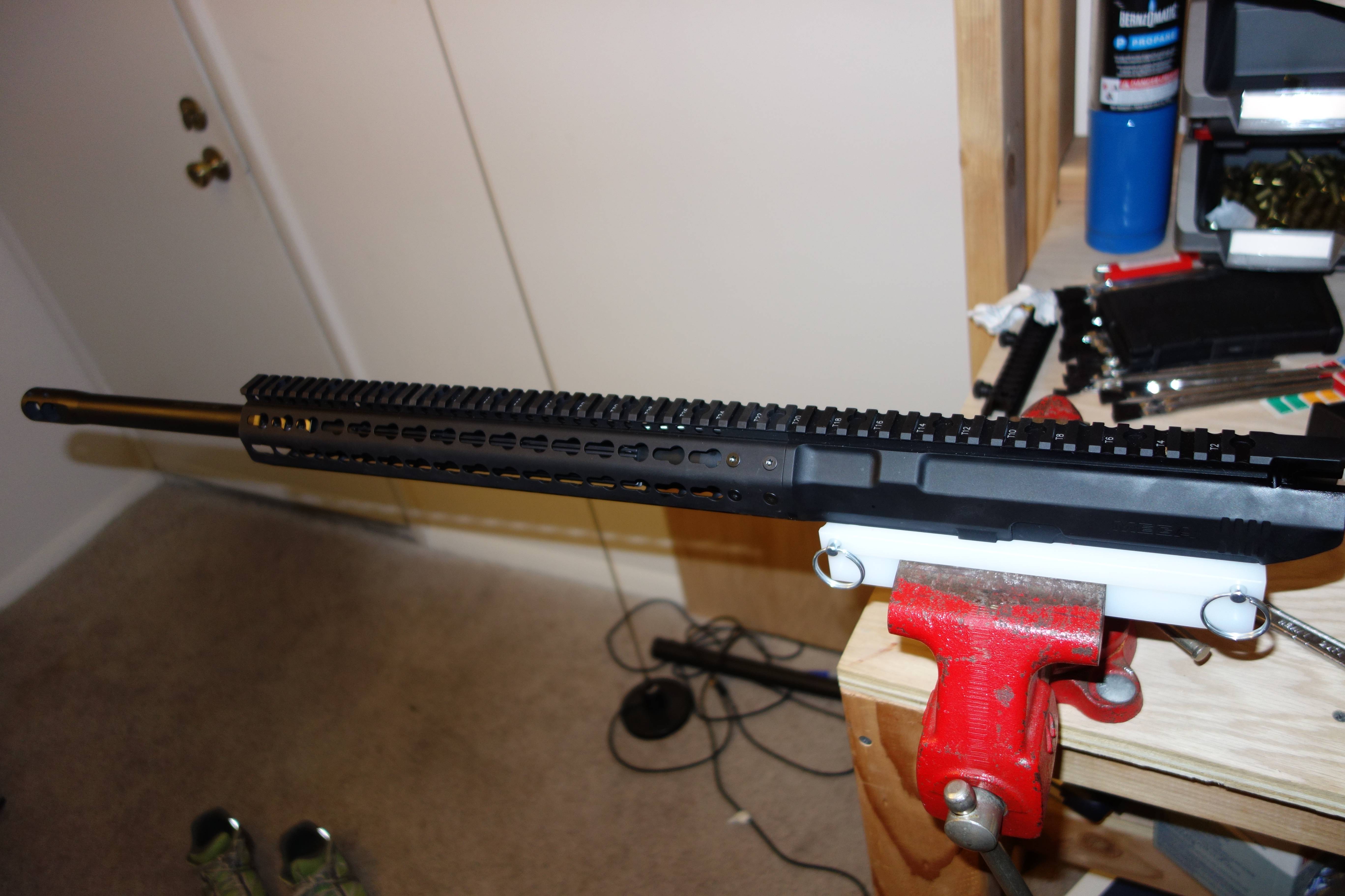

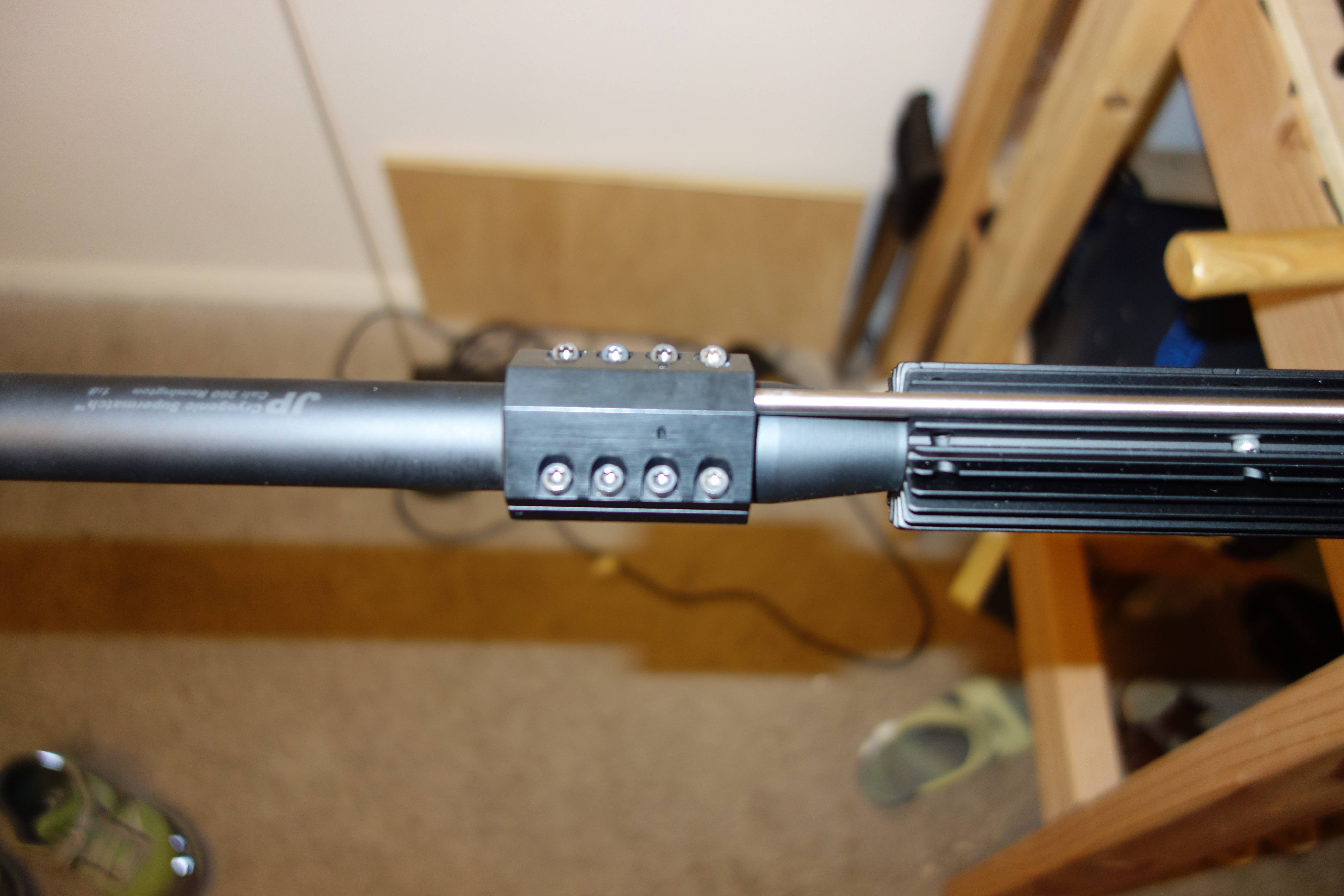

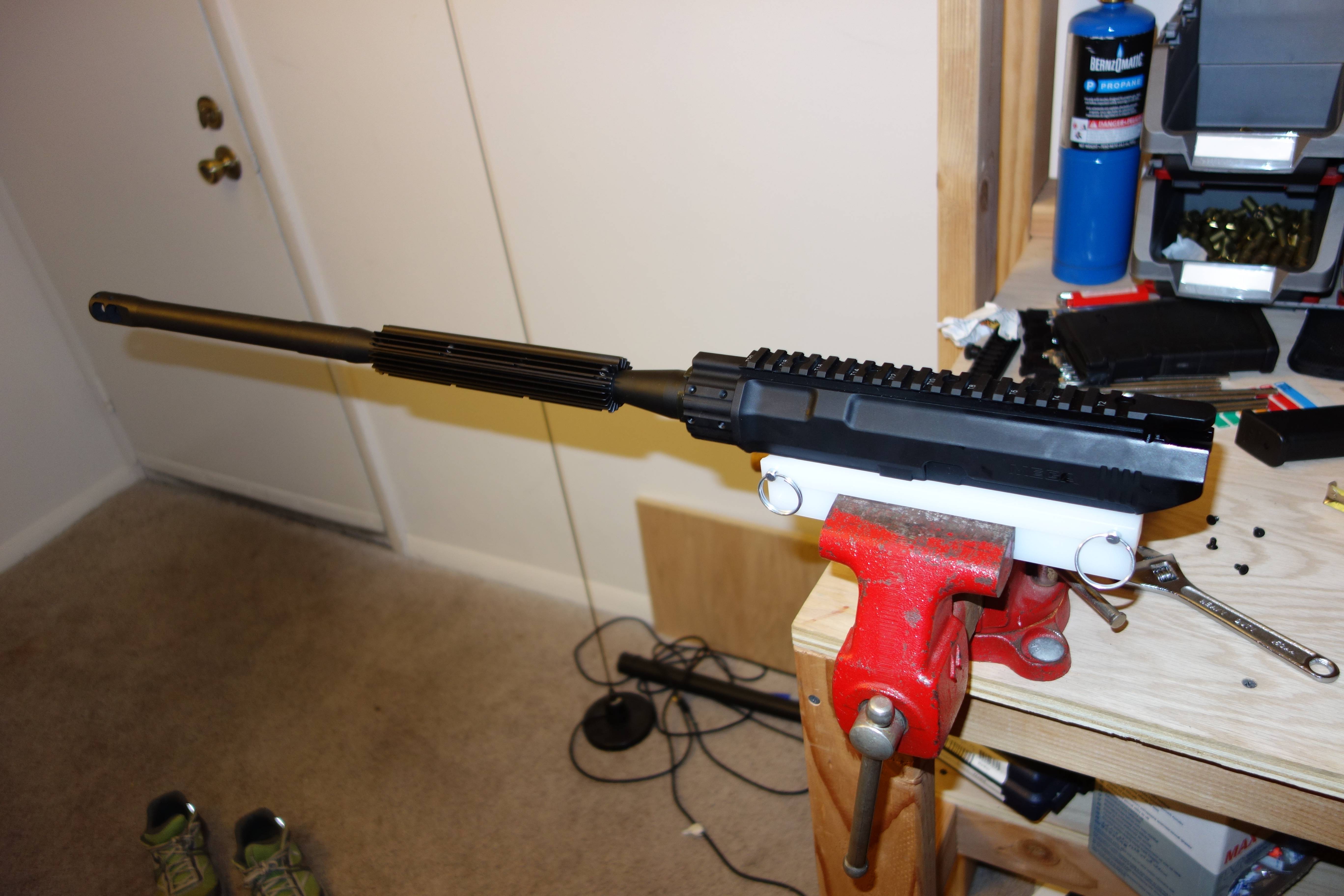

Just finished putting together my first AR build! Basically a JP 260 barrel on a MKM MATEN. Here are some pics of the build:

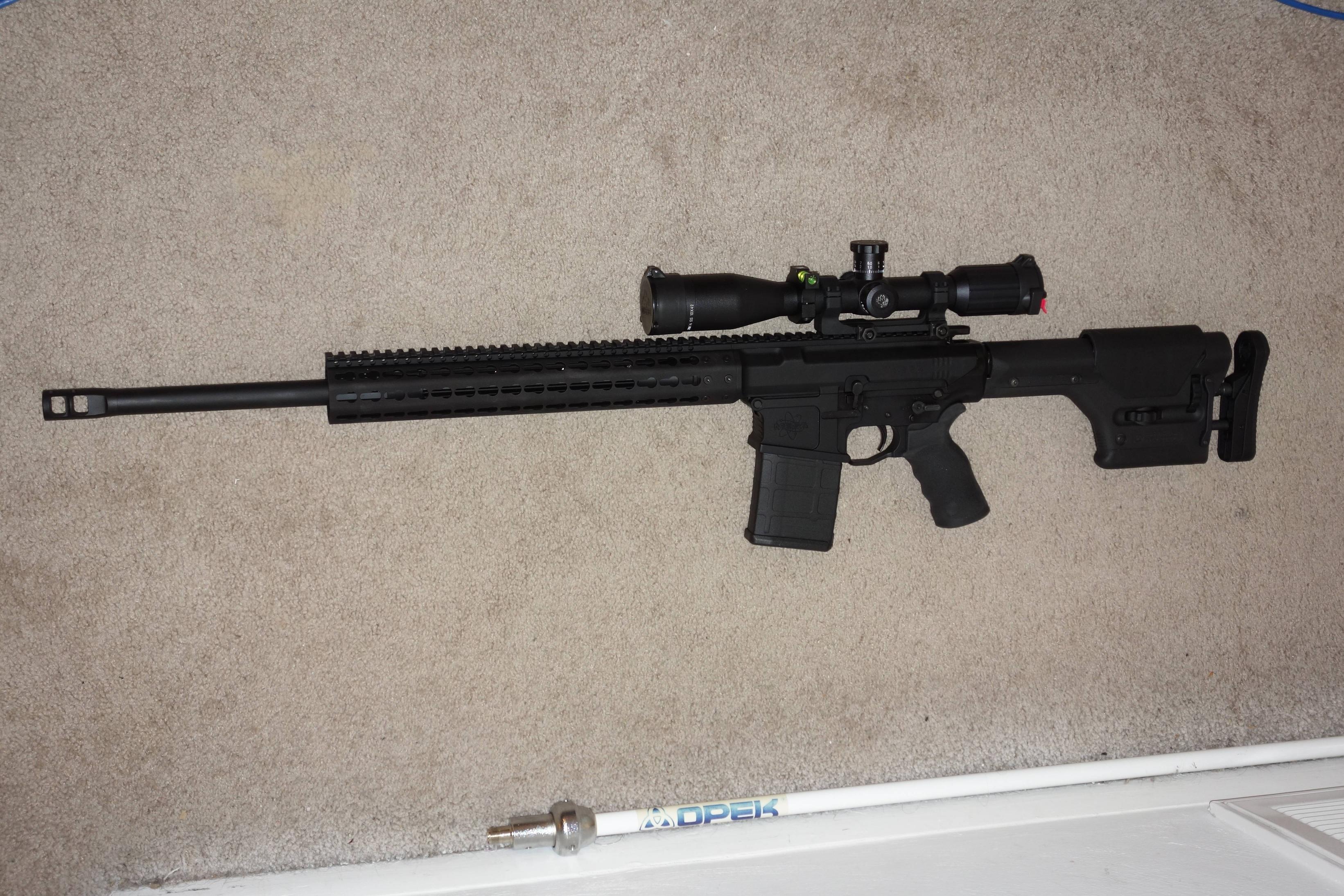

And here is a really crappy picture of the finished product. Bipod mount is still in the mail, and its dark it my apartment.
I'd like to thank all the great guys on the forum, I couldn't have done it without you guys! Special thanks to ORD and BusterB for helping keep picking some of the components. Unfortunately, this is a really busy two weeks for me so I don't think I'll be able to get out and shoot it until nearer the end of March.
Edit: figured I'd add it weights 13.4 lbs with scope and empty mag.
Very slick build. That Mega MKM is a clean, excellent evolution of upper receiver and handguard interface for the Stoner system.
What charge handle are you thinking about? BCM large latch or a Raptor should go well with this fire stick. Do you have brass, bullets, powder, and dies? Any loads planned for it?
.260 Rem is a great cartridge. I like the 130gr going just over 2800fps, VLD's and Norma GT's. Also shoots 139gr Scenars and 142gr SMK's well, but I have a Bartlein barrel.

Thanks, I'm really happy with the way it came out so far. I just ordered the BCM Mod3 for this one. I have one on my AR-15 as well, and like it a lot. With that huge SWFA SS ocular housing, its almost impossible to grip the handle.
As for loads, I'm not sure yet. I got 100 pc of Lapua brass and some 140 gr AMAX's but I have read some people have issues with the heavier bullets in semiautos. Only suitable powder I could find was RL-17. I also have some 123 Scenars on the way. I will probably try some 140s in some once fired brass a friend gave me. I normally try to stay away from the VLD bullets because they like to be crammed into the lands (or close to it). I will probably post on the reloading forum soon about this more specifically.

You may want to put your level to the rear of the paralax knob so that you can see it from behind the rifle...
Had it this way on my 700 and it worked fine. Its actually held above the knob so you can still see it. I like having it far forward because when I shoot with my normal glasses its harder to focus on when its closer.

I finally got to take this beast out today and shoot it! I loaded up 40 rounds with a (light) 40 gr RL-17 and 123 scenars. After getting the gas adjusted and zerod I shot a few 5 shot groups. I'm really pleased with the results so far. I shot a .8" group with horizontal stringing (I had full adrenalin going from the excitement and wasn't doing the best trigger control) and my friend and much more experienced shooter shot a .5" group. We were battling some pretty heavy headwinds which were physically moving the targets making shooting groups hard, but without any load development I'm very pleased! I didn't get to chrono these (again, wind) but my next step will be an OCW. If quickload is right these were somewhere around 2750, which for a 123 is pretty light. Hoping for something more like 2900.
