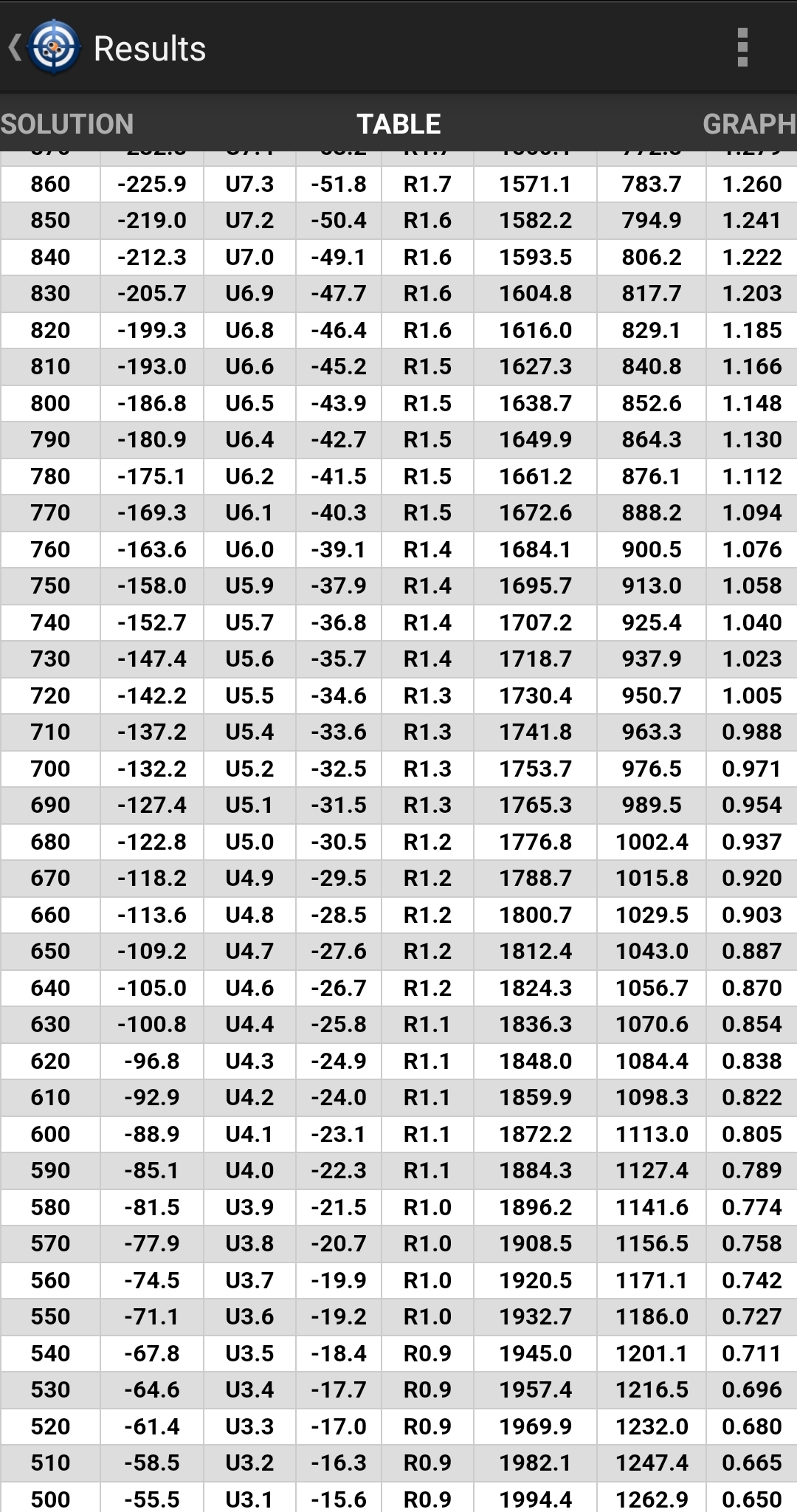

    With handloads and Hornady's reccomended minimum of 1,600fps for the 143ELDx to expand. It puts me at 830yds with my 20" 6.5cm.
    Reactions: Mj30wilson900
    And about 830 ft lbs of energy, right?
    This is the table I use. Seems to hold true to around 1000yds. The furthest I've shot this rifle. It had a 2.5-10x42 scope. So I usually don't grab it for long range plinking.

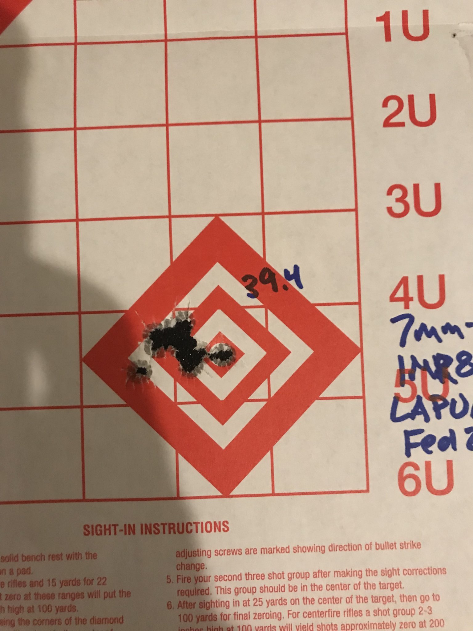

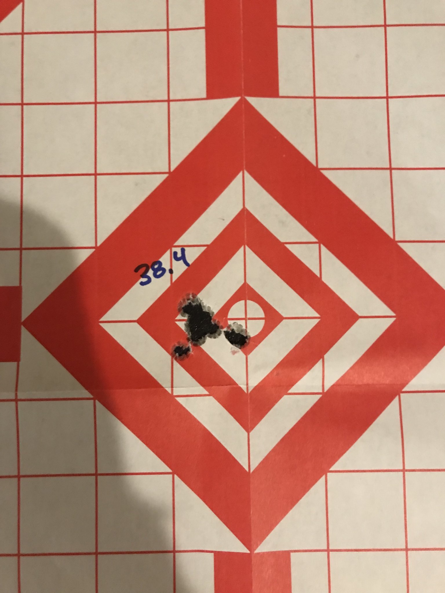

    7-08 and Big Game powder.
    139/145 LRX
    150 ELDX
    150 ABLR
    The 150 eld’s have been very impressive. Jumping them ~0.070” and getting great groups and been one and done on whitetail. Groups attached are 10 shot groups.
