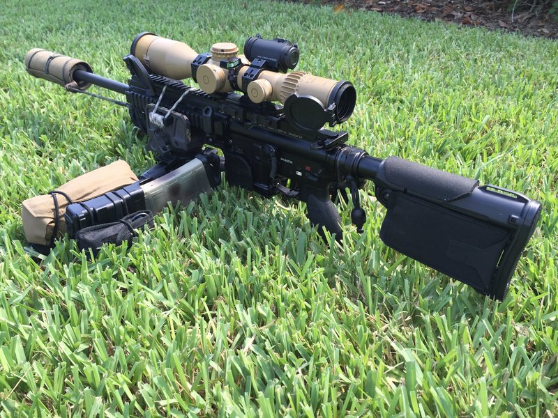

I also run a 20" 6.5 grendel ar15 with a 4-16 Atacr F1 for deer hunting. I have a set of magpul flip up sights, and an AimPoint micro t1 (neither currently mounted on that rifle though)... If I were to go hog hunting, I'd get a 45 degree offset mount for the T1, or mount it on top of my main optic. I ran the 45 offset mount on one of my other ar's and it worked great for close up shots.

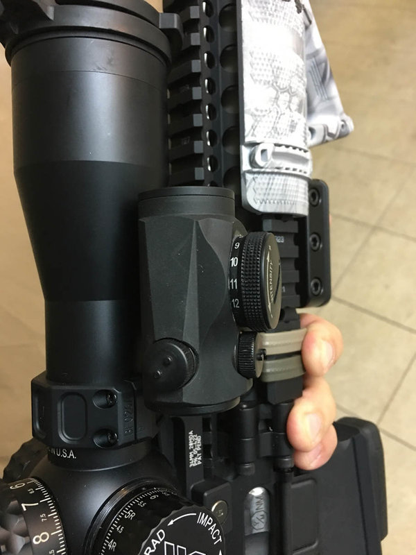

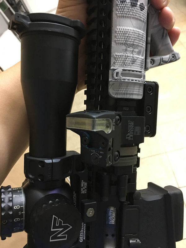

I have one that run an aimpoint micro on a larue offset sight. The other runs a trijicon rmr on a Daniel defense offset sight. They're both very fast. Just twist the rifle and the dot is ready.

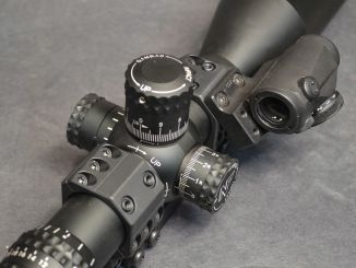

I have a NF 2.5-10x24 with a MRDS mounted at 12 o'clock on my AR-15, and the same setup with my Vortex HD G2 4.5-27 on my DT SRS. The one my SRS is only for faster target acquisition though. Since I now have that setup on my AR, I no longer run BUIS, just excess weight in my opinion. Honestly theres no reason to have BUIS if you do have a MRDS and an optic, especially with the "2 is 1, 1 is none" mentality.
I prefer mounting the MRDS at 12 o'clock versus canted, it was less training for me to adapt to, and less likely to get damaged, since the majority of the rifles Ive seen dropped have been on the side, which the MRDS wouldve taken the majority of the impact. With the ATACR, those turrets are the perfect height, it will put the dot just above the elevation turret. Just a simple movement of your head vertically versus canting the rifle and adjusting your cheek weld.

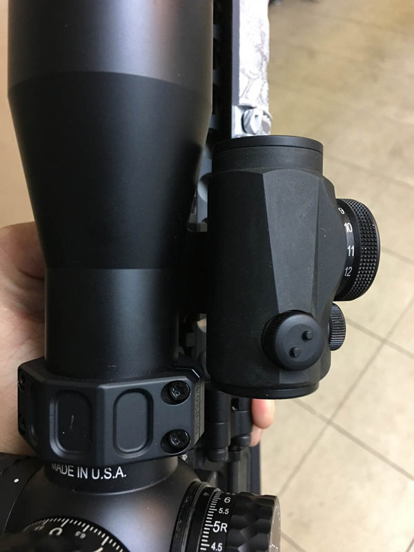

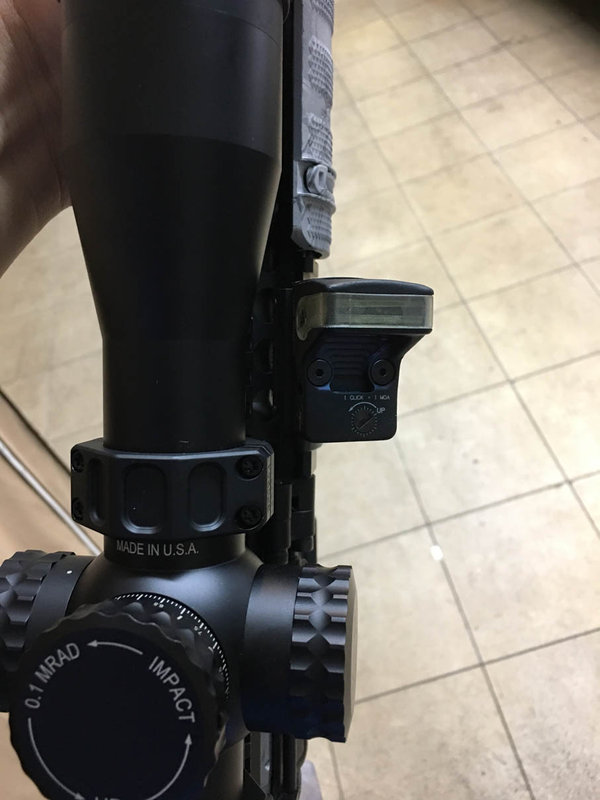

And that Larue side mount fits under your ATACR? That was a big option I was already considering just because I already have a T2
It isn't a perfect solution. It will fit under the ATACR in just the right spot, but you need to remove the windage cap, and only half the T1 window is visible as it is obstructed by the windage knob. But it is enough to see the dot and get on target. One advantage of it though is that it gets really snug next to your magnified optic and doesn't really increase the size of the rifle if you get my meaning. It doesn't really protrude. I still think it's faster than offset iron though even with the obstruction.
The view is actually better on a Daniel Defense offset mount as it pushes it further out but it does protrude more which makes it the focal point of punishment when you run into something. Same thing goes for mounting it on the actual ring/mount above the optic.
Here it is... important to note, you're gonna have to be ok with it blocking half the window on the T1 with the larue offset mount.

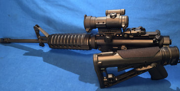

Here are some options I have.

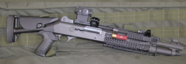

These are the Duecks on a Benelli M4 14" entry as BUIS for a Aimpoint T-1. As mentioned, they don't fold and you can

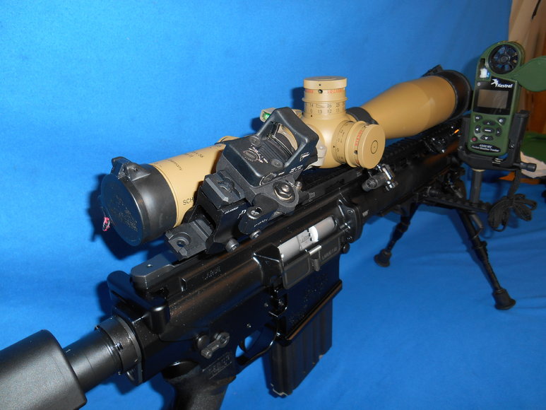

My favorite user friendly combination is this Aimpoint T-2 offset on the main GDI mount. IMG_3547 copy 3.jpg

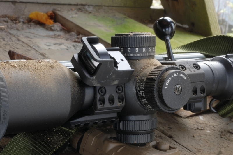

Burris makes a tube mount in 34mm, 30mm, and 1" that can mount anywhere on the tube and at the angle you prefer. you can mount a Fastfire III red dot in 3 or I believe 8 MoA on this mount. It's not ridiculously expensive and I can attest that it works excellent.
This is it on my 6.5 Creedmoor that I set up for the PRS Gas Gun Series.
I was looking at Larue's option for one of those too. Course I'm sure it's more expensive. I like how much closer that one hugs to the bell.
