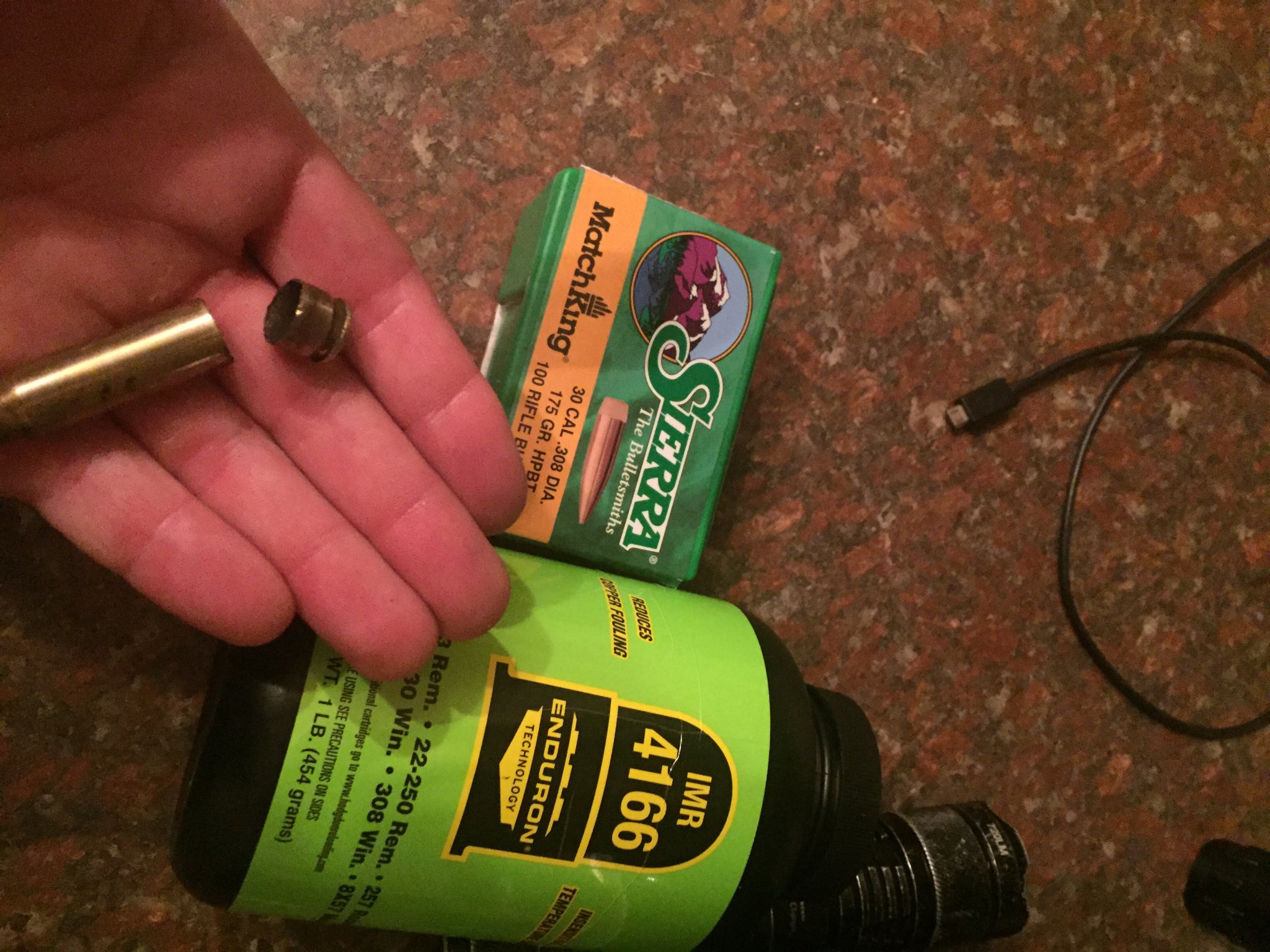

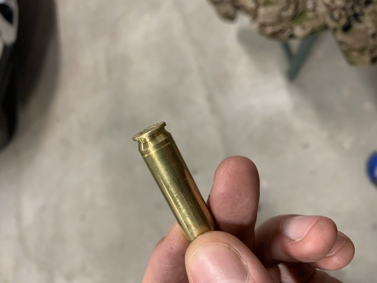

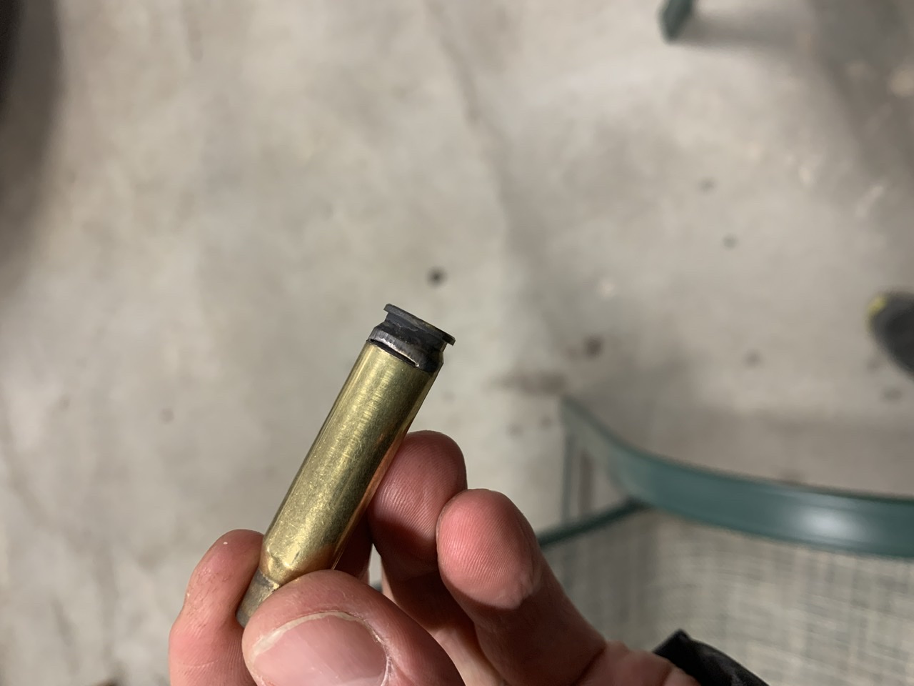

So I’m assuming the hornady brass from my reloads is a bad batch (this is all the second firing of it)
The slightly bulged case is a hornady
The pierced case is a hornady

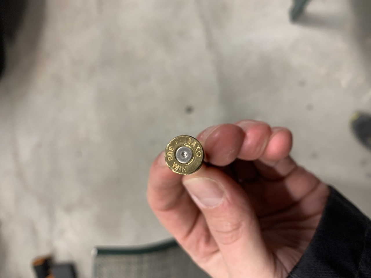

The marked case is a sako
but am I also correct in assuming that my chamber is now cooked?

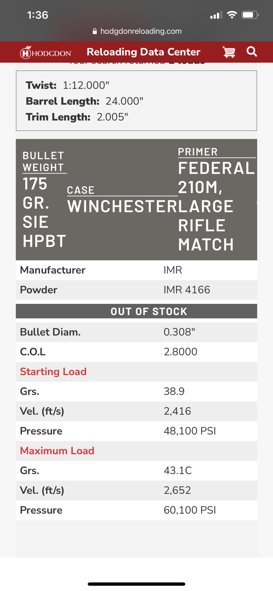

Here’s the chart, I’m at 40.5 which is no where near Max load I don’t get it. I’m thinking it’s gotta be bad brass but I’m worried I may have torched this chamber now

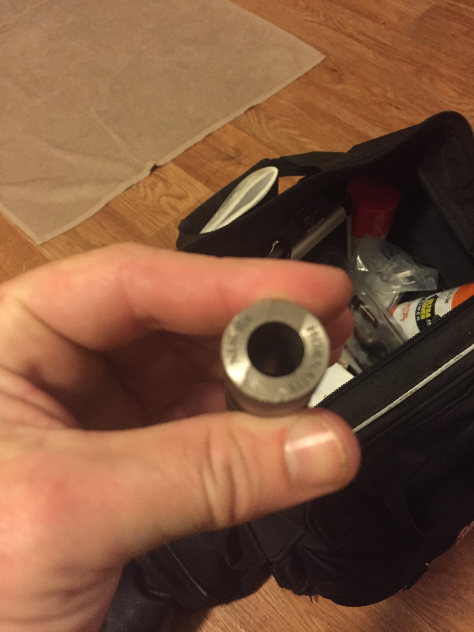

I’m using a hornady resizing die and full length resizing, reason being is some of this ammo was shot through different guns as as I have a couple 308s I don’t want to size the brass specifically to a single gun
How much are you bumping back?
This sounds like the cause of your problems or at the very least, contributing to them. You ALWAYS size brass specifically to a given rifle based on that rifle’s chamber.
I use one sizing die for each rifle i load for as it’s easier vs trying to adjust a single die for multiple rifles chambered for the same cartridge.
When you say “full length sizing,” what does that entail? Are you crushing the brass back down to minimum dimensions with cam over on the press? Adjusting the die such that the ram “kisses” it at full stroke? Adjusting the die such that it pushes the shoulder back to some measurement based on fired brass? All are “full length re-sizing.” You are not telling us what you are doing.

41.5 4166 with a 175 should be okay.

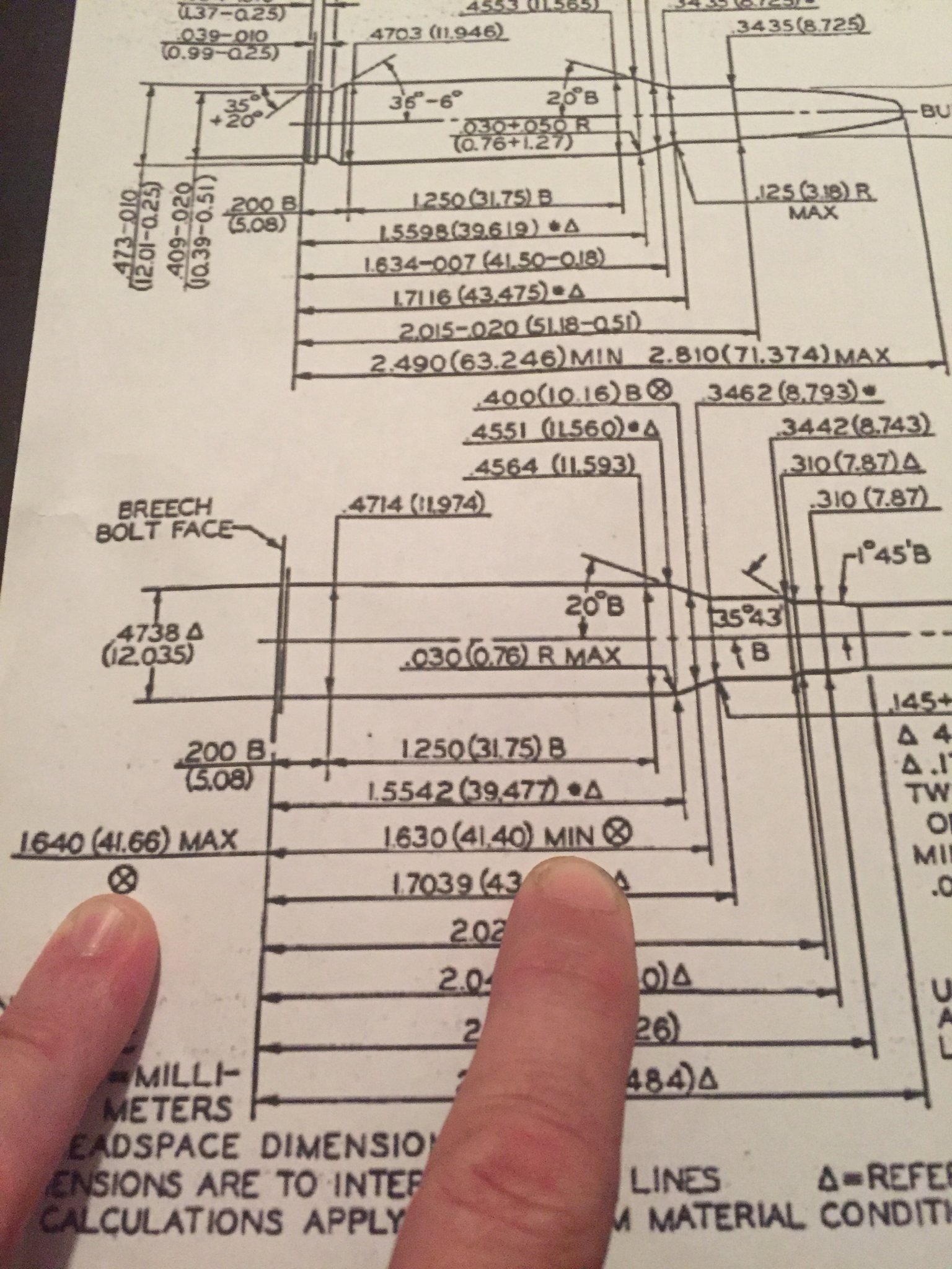

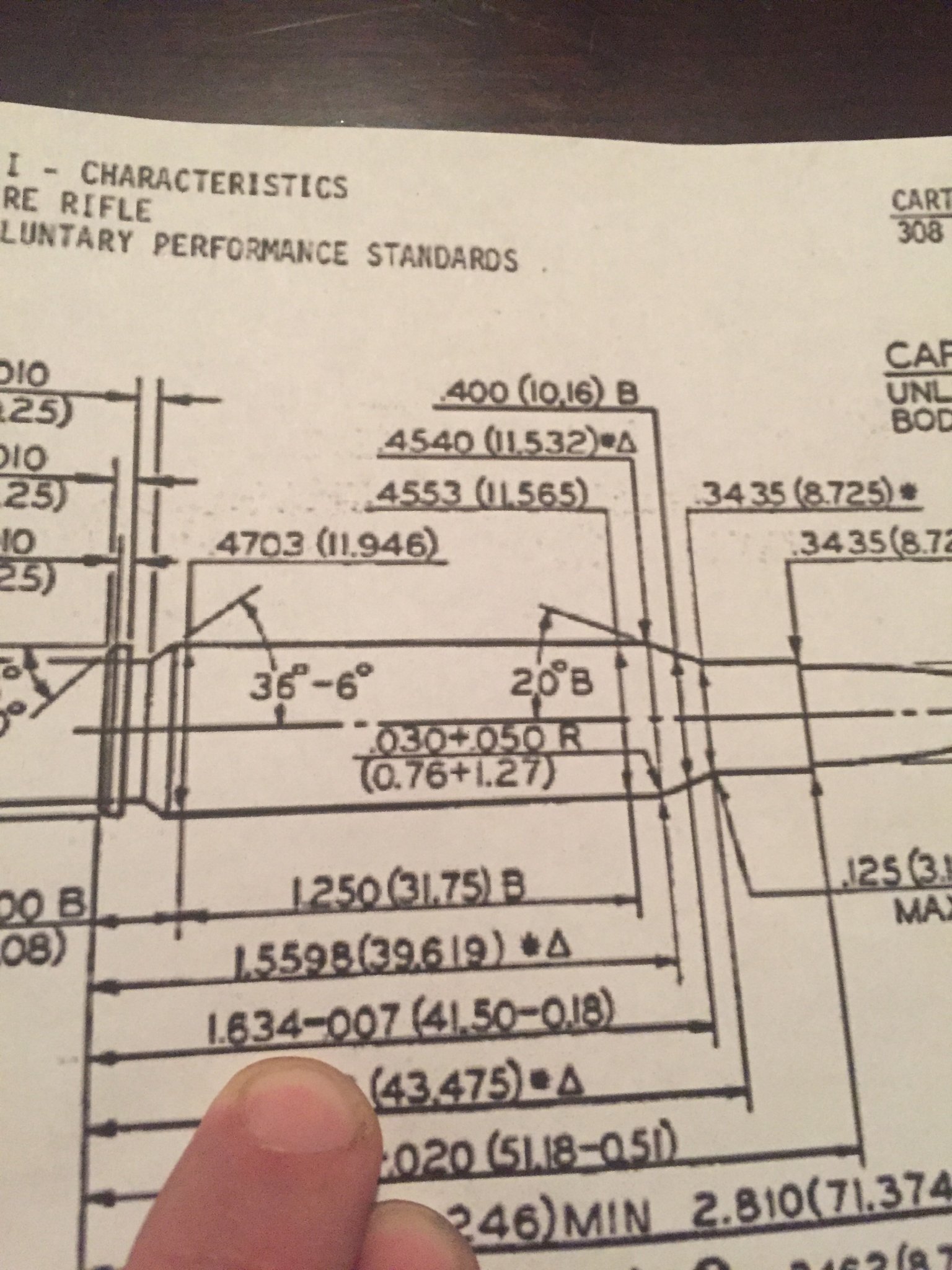

To clarify, 1.630” is minimum saami for .308 Winchester (1.630-1.634). Are you referring to the measurement on your comparator (which is a reference measurement) or the chamber’s actual length?

Ok so I’m pretty sure this chamber is F’d, I just checked it after cleaning with some factory rounds and it’s leaving some pretty good marks
So it’s a new barrel for me.
also when I full length size it’s just barely a touch, I’ve done it this way in every other rifle I reload with magnum or not with multiple firings on each with our issue. I’m definitely going to find a head space gauge and measure for futures sake but in the mean time it’s a new barrel for me

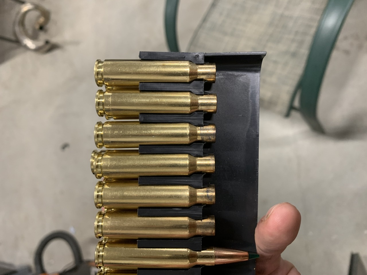

now I started exploring all my brass (the twice fired, once fired and resized once and here is what I found, multiple brass with little bulges at the base in the same location. These are brass that have never even seen this gun. Very disappointing to say the least. One in hornady these are once fired factory that were shot out of a factory AI AT, two in myself for not properly checking all the brass more thoroughly even though it was factory loaded and three that I didn’t cAtch this sooner, coulda saved myself money for a new barrel. I’m still going to check head space, I’m probably going to switch to Peterson brass for this gun as I have some already.

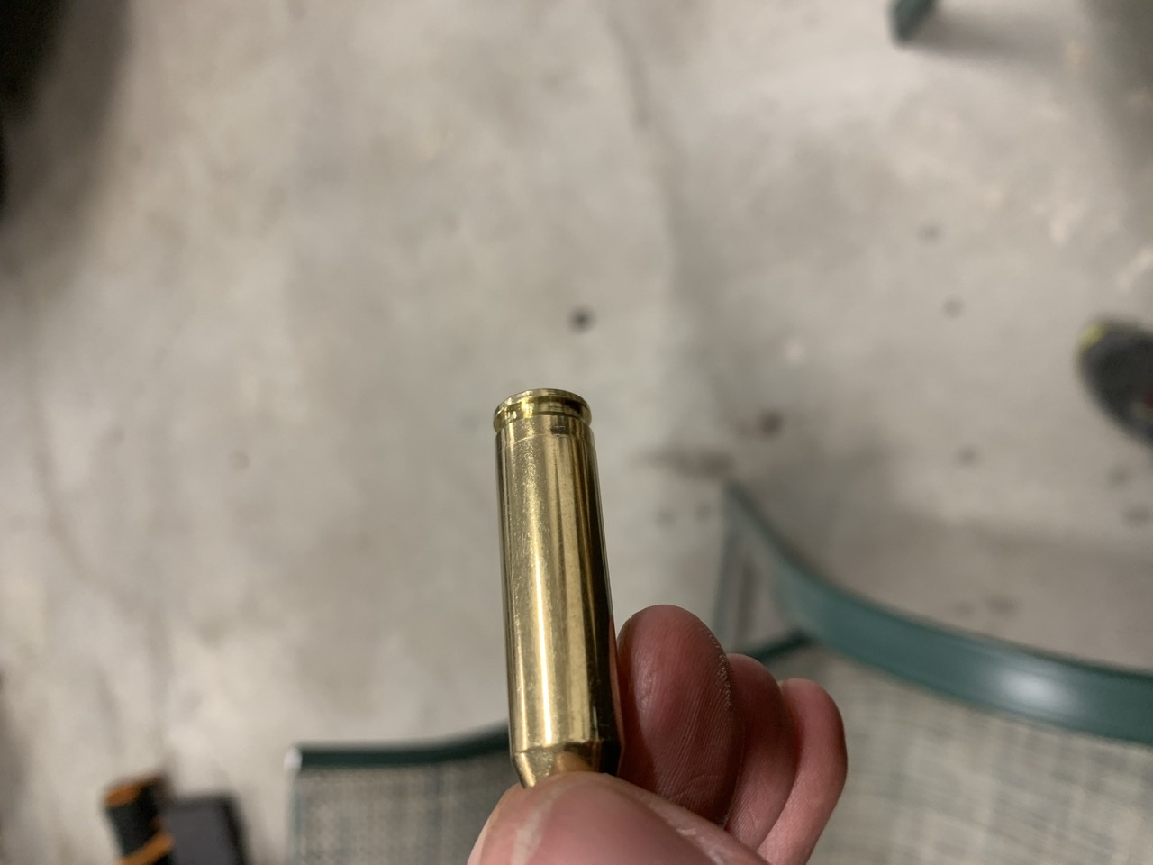

heres some pics the first of the factory sako ammo the ones on the right are pre cleaning the ones on the left are post cleaning and gun reassembly I’ve noticed that the marks are not as bad after cleaning but still not worth the risk
The next is a sized and primed cartridge that has only been loaded at factory
There are several like this. Wow is all I can say.
I was referring to this number, 1.634-.007. Which I referenced off the case size spec. I might be interpreting this wrong.
I sammi chamber spec is 1.630-1.640
So excuse me if I misspoke and welcome a correction.
Setting My headspace longer I haven’t run into a case at separation since. To clarify fired brass comes out of my chamber at 1.640 ish, And I aim for 1.630 when I size. Which is .008-.010 longer(edited) in some cases compared to the case length gauge I was using before I bought the comparator.
Saami chamber spec for .308 is 1.630-1.634. Saami spec for 7.62 Nato is 1.635-1.640. That said, ive seen a variety of chamber lengths over the years within that range irrespective of the stamp on the barrel.

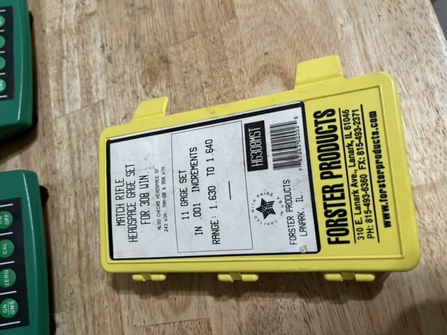

I use Forster’ headspace gauge set to determine a given .308 or 7.62 Nato rifle’s headspace then stick the applicable gauge in my Hornady comparator, zero the comparator then adjust the die until the comparator reads -.002 ( the shoulder is .002” less than the actual gauge that corresponds to my rifle’s chamber length).
If you are bumping .010” after every firing that’s too much IMO. I would not continue to size your brass like that as it will likely shorten brass life(and elevates case head separation risk).
You just need .002-.004 at most.

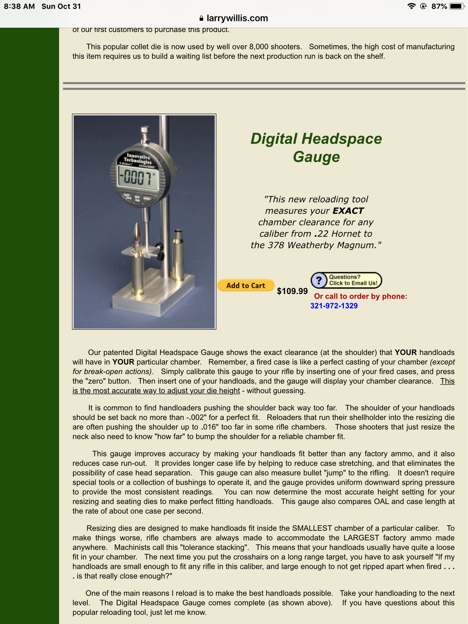

Remove all doubt re headspace with a Whidden gauge. They're available from a few places. With this gauge, you can see the headspace of a fired case and set your size die to bump back .002" with a high degree of confidence. Then, after resizing, you can trim to overall length.
I also have Wilson gages (their spelling) for 9mm and .223. They're great for insuring loaded rounds will chamber in a semi-auto, but, for precise determination of headspace and OAL, the Whidden gauge and a good caliper set the bar.

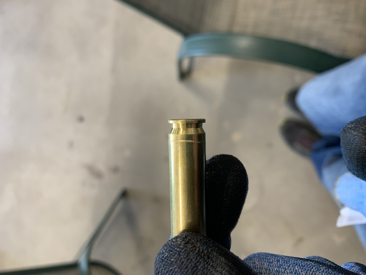

heres some pics the first of the factory sako ammo the ones on the right are pre cleaning the ones on the left are post cleaning and gun reassembly:

Upon further review I checked all my brass
here’s the results:
Five boxes of hornady all with some sort of bulge on the side
this consisted of three boxes of hornady white tail 150 gr, one box of superformance and one box of match.
two boxes of Berger factory with lapua brass no issues
five boxes of federal match premium no issues
two boxes of nosler match no issues
the one box of sako I have fired has no issues and this new box has issues but I would attribute that to the existing chamber damage. All previous factory was fired before any reloads so no issues there
Your die is crushing that brass down. Do you feel resistance when you are resizing your brass? Like on the upstroke do you feel a drag or hard resistance?

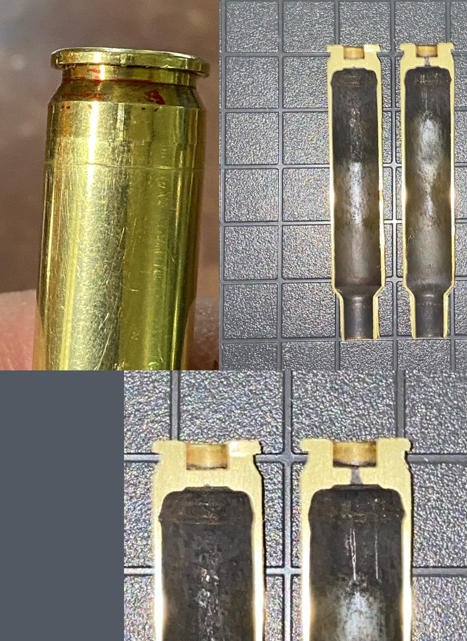

Looks like headspace problems to me. Oversizing? Get a headspace comparator and check your fired brass from the rifle you're loading for vs resized brass. 0.004" is all the clearance you need for reliable feeding. Some people will tell you 0.002" is plenty (and they are probably right).
The brighter rings near the case head could indicate the brass is stretched too thin there. Try the paper clip check that others already mentioned.
If you're getting brass that is stretched thin there on the first firing of a factory load your rifle may have a very long headspace. You will not be able to safely load ammunition for that rifle and a tight chambered rifle with the same die settings. Brass will have to be kept separate for the different guns, if the long headspace rifle is safe to keep firing at all.
When you use the headspace comparator keep in mind that they are not manufactured with particularly tight tolerances (at least mine isn't). They're useful for comparing things that are measured on that same instrument. You can't compare your measurements to SAAMI specs, etc.
Having brass that was fired in different guns makes it harder to diagnose the problem. Maybe it's not a problem with this rifle, but one of the other ones?

Don't take this wrong. Where are you from and is English your primary language? If it's not well all cut you a little more slack. Still though, your thoughts and description is not well presented.
My guess is you have a few issues that will persist if you continue on the current path.
Running multiple small lots of factor or reloaded ammo is a recipe for disaster if you aren't comparing it to as fired size so you resize correctly.
Annealing can help this but it can still be a problem.
If loading bulk ammo its not as much of an issue for something like an AR.
Load performance will vary brass to brass also because of internal size etc.
Headspace comparator is a referenced measurement not an absolute.
Hope this helps.
No amount of annealing is going to save CHS from oversizing. Annealing and CHS are completely unrelated, unless you heated the case head, and made it soft. Then annealing could cause you to blow the case head off.
I have seen a chamber that would close on a field gage +.002 have brass last three firings bumping .007. There is more than one bad thing happening here, thus compounding the problems.
I use this tool from Innovate Reloading:
That said, I started to have premature signs of impending case head separation with my last run of 280AI has hunting rounds. A preliminary measuring with the above tool shows that I had erroneously bumped the shoulder .009” 😳 instead of my normal .001-.002
Obviously I am vexed at how I made such a rookie mistake and grateful to not have had any actual separation or cracking. My current guess is that I forgot to use the Redding Competition Shell Holder that I spec-ed for this rifle. I have not rechecked my head space yet but I do put witness marks when I install my barrels and nothing has moved.
Part of my reloading process is snapping pictures of powder used, weight etc. as I double check. This also gives me a reference to look back on should there be an issue. The sizing process will now get the same treatment. Match grade 280AI is just too expensive to be toasting it prematurely........
Reactions: 37L1 and Mareshow
And there it is.......
Base of the die to the shellholder.
Killer of brass and the biggest rookie mistake since the first rockchucker was sold. You need to buy the right gauges and actually learn to use them.
Agreed and that's not what I was trying to get across.
I order one in 6.5 cm from Brownells (free Edge Member 2 day shipping) and a custom one for my 280AI from Whidden directly. Sent off my Go-gauge yesterday. 6-8 weeks on that one. Before mailing it, I double-checked my rifle’s headspace. As suspected, no change.

A strange twist though. The Forster Go-Gauge that I used to set my barrel measured -.003” SAMMI on their Gauge.
I called and spoke to John. His recommendation was that I send both their Case Guage and the Forster Go-Guage to him for inspection. He said is was a 50/50 chance that it was their Gauge or the Forster.😳
I have to say I found that distressing say the least. I wonder if Forster would feel the same way? I just assumed that tools like these were held to a very high QC regiment that would include multiple checks and verifications before they went out the door.
Less than one hour after receiving the tool it was package to go right back out the door, on my dime......Frustrating.
Whidden also claimed my Manson 280AI Go-Guage is also +.0045 over SAMMI specs😳. l spoke at length with Manson & Forster.
