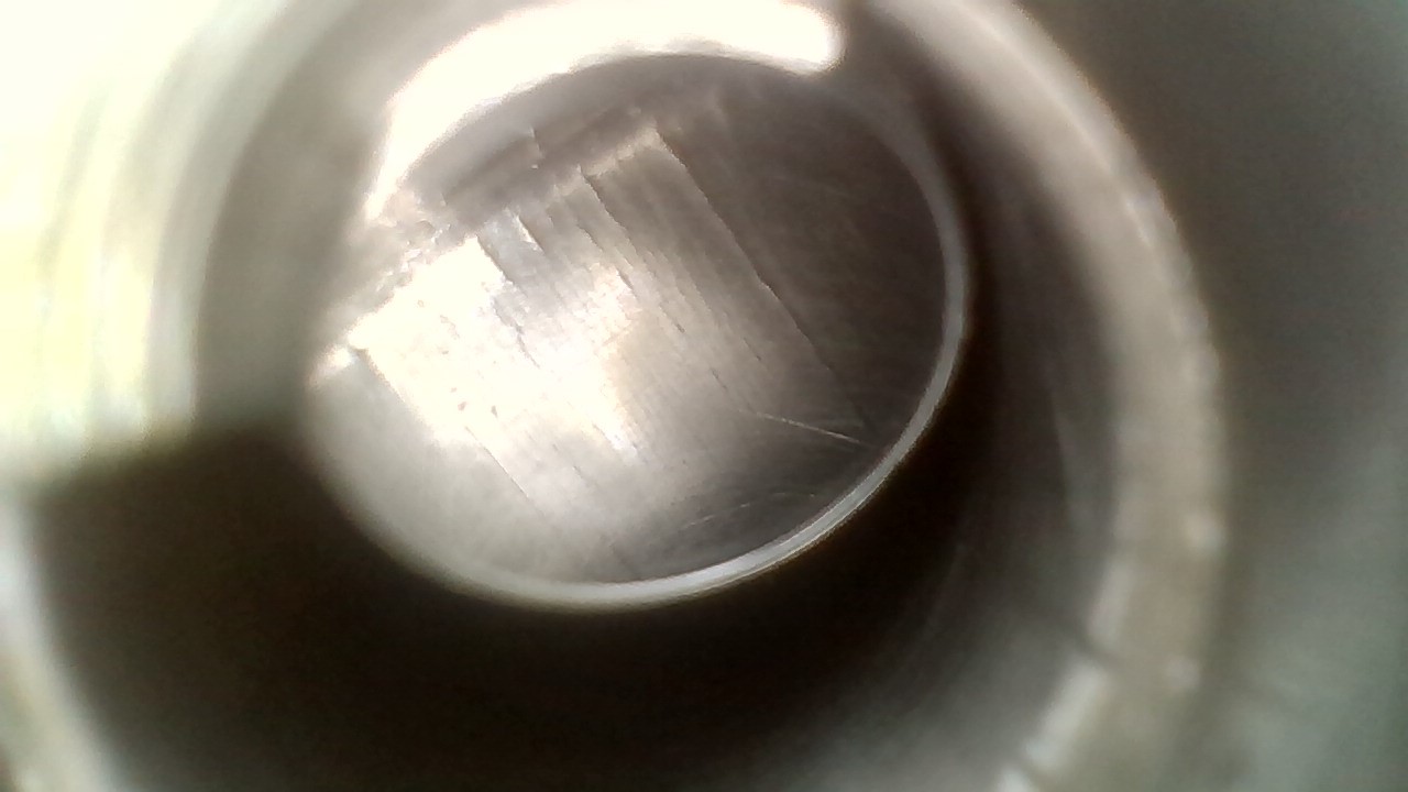

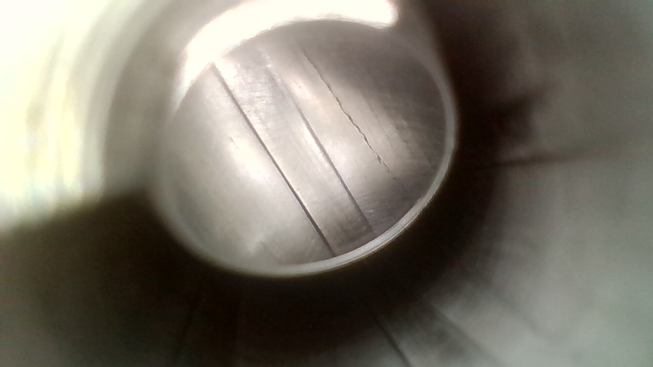

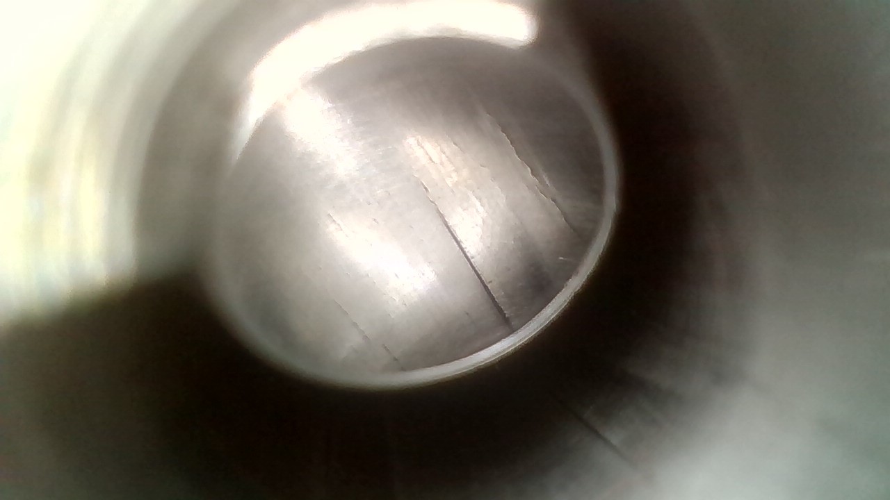

In preparing to run a new lot of powder with a new lot of Peterson brass and copper solids, I cleaned the snot out of the barrel. When I scoped it, I saw this longitudinal crack which is about 1.25 to 1.5" long on the surface, and appears to have signs of continued travel.
I did not see it a few days ago when I has cleaned and scoped it. I think the barrel is toast. There's not much meat on a CF barrel. The bummer is that I have 35 days to prepare for a CO elk hunt, had sold all of my large caliber mags, and have no other guns that are ready for an elk hunt. Even my 1903A3 needs a new barrel, but that took me 45 years to shoot out. I hope Josh at PVA can whip me an Osprey barrel up fast. @bohem
