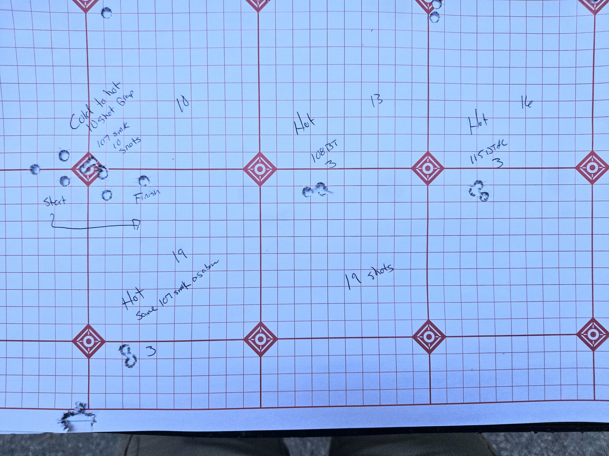

I’m not a metallurgist so I have no idea, but when the barrels last half the life with the same powder and load and the same shot strings I don’t know what else it be.
Other people have had the same stuff happen. I’ve also had a Krieger on a KAC LPR go in less than 500 rounds and KAC and Krieger both admitted the issue to a bad lot of barrel steel and it was replaced as well as the other people who also bought them and had them crap out super fast.

I shot out a good number of AINA 243 Bartlein barrels...

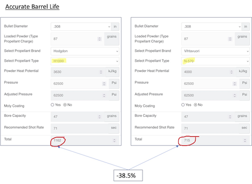

“I did choose to have them “+P” the throat for the extra velocity potential.”

Sorry but nobody is going to convince me that a +P chamber is going to cut normal barrel life in half in any steel, let alone proprietary super steel that’s supposed to extend barrel life.
There’s also a guy over on rokslide that shot out one of your MOD400 barrels on a 300RUM in 400 rounds which is less than half of what normal steel usually gets in those. I’ve shot out a number of 300RUM barrels too pushing very hot loads and know well enough that 400 rounds is not normal. Even my 15 twist for 110’s pushing them over 4200FPS got 700 rounds before velocity fell off and a couple hundred more before accuracy opened up on a Krieger barrel.
Pretty sure that guy was running a +P throat and N570 too.
Surely cutting down the lands in the throat, to allow the use of extra powder, to run a faster load, wouldn’t do anything to the rate at with the “remaining” lands in the throat erode. Your not going to convince me that you have any idea what in the world you are talking about.

Yeah I saw the original post and decided to stay out of it. IMO guys that try to wring out all the speed they can get need to accept they are probably going to see less barrel life. The chances of them pushing well beyond the max pressure also increases. When I worked in a ballistics lab we could see that going over pressure on RUMS was harder to see sometimes. Add that to the possibility one could let the barrel get really hot while doing load work up chasing velocities. It's just part of the game.
