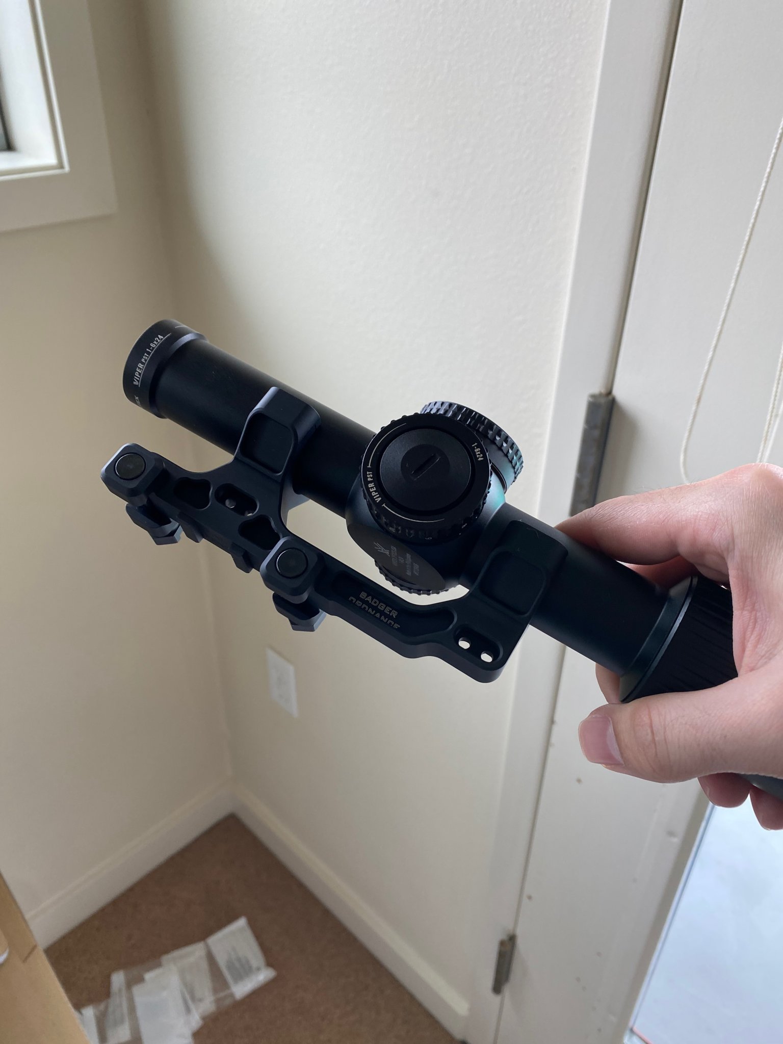

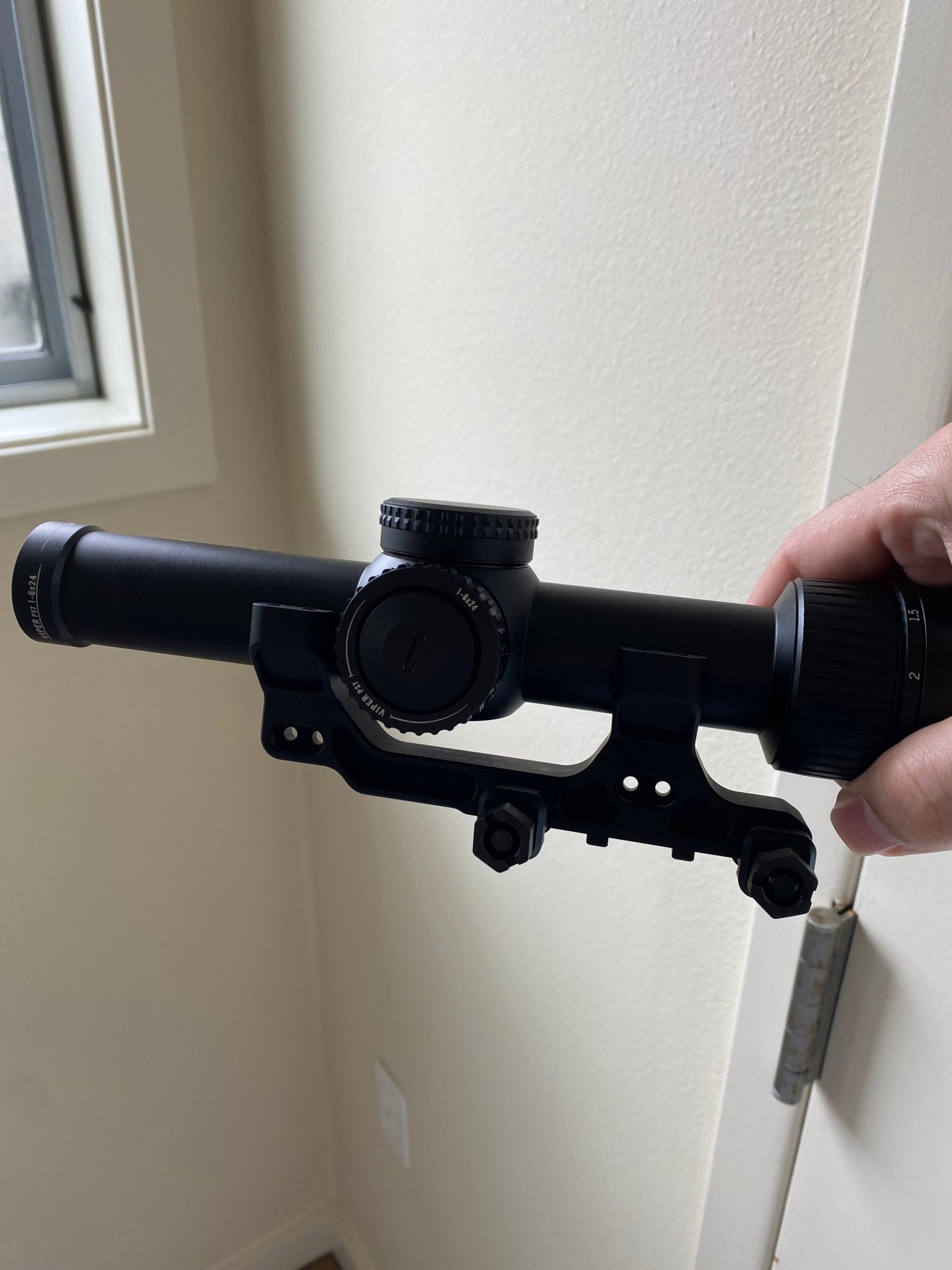

without placing the top caps whatsoever, if I place the scope into the bottom half, the sides of the rings are holding the scope a few mm above the bottom of the rings. If I push the scope in to clear them and seat the scope in the bottom of the rings, taking up the remaining gap and making the scope flush in the rings, the mount is tightly clamped to the scope tube, and the scope tube cannot move in any direction.

Could you share some photos?
first two showing the mount "gripping" the tube without the top rings in either orientation, 3rd pic shows if I rest the scope in the lower mount without press-fitting it.
