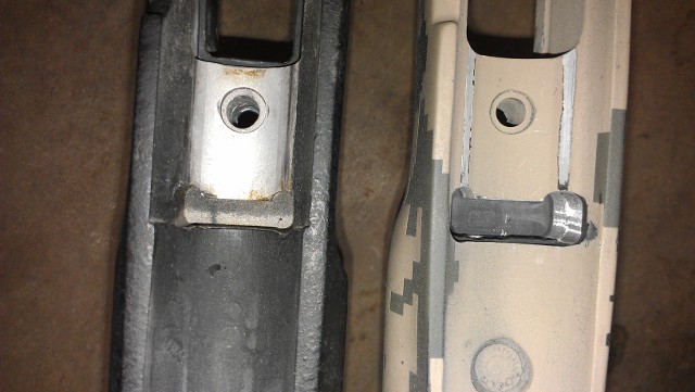

The barreled action I picked up here on the Hide has a Badger recoil lug installed. To my dismay I found it too tall to fit in my H-S Precision stock. I don't want to remove the barrel, so I plan on grinding it down as installed. I'll work slow to make sure it doesn't get too hot and square up the bottom with hand files.
I thought to post here before I start surgery.

The Badger lugs are really tall compared to either standard or .300 HD lugs. I need to remove 3/16" from the lug to get it to fit. Relieving the stock is not an option, because there's not enough material remaining on this particular model H-S stock.

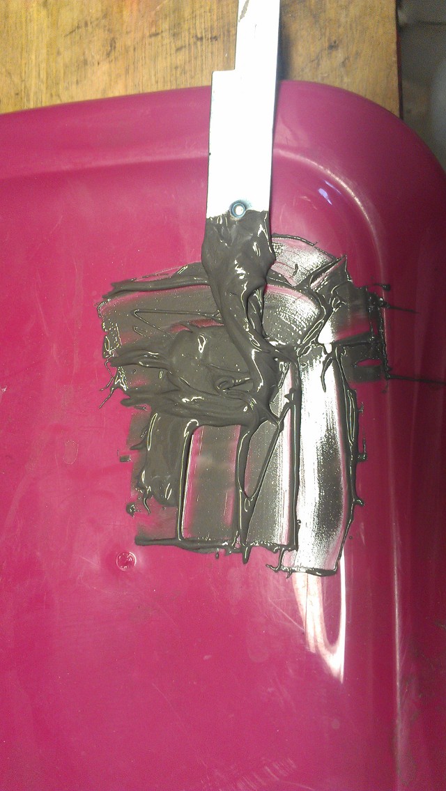

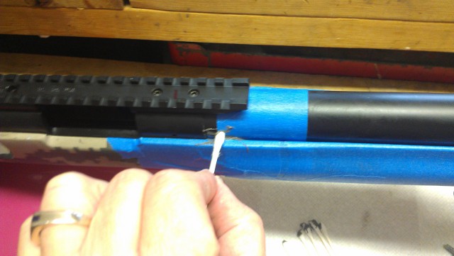

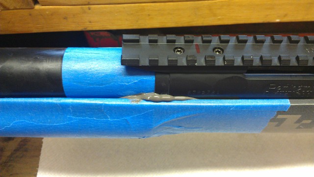

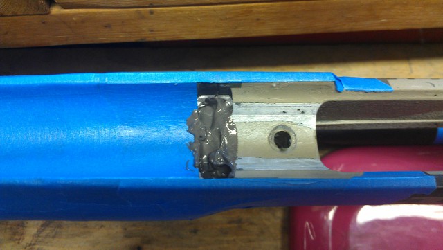

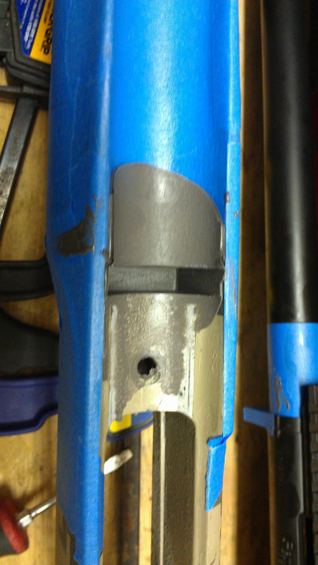

Sean -that's pretty much the conclusion and process I came up with. I'll final fit by hand file... it's safer. When I'm done I'll cold blue the bottom of the lug to prevent rust and make it look original. The lug area will be bedded with Devcon and the action skim bedded. Everything should look and fit good once I'm done.
I had no problem cutting out my HSP Stock for an oversized recoil lug. It did go completely through the aluminum and into the composite, but still a good 3/8 to half inch of stock below it. I bedded it with devcon after cutting it to size.
