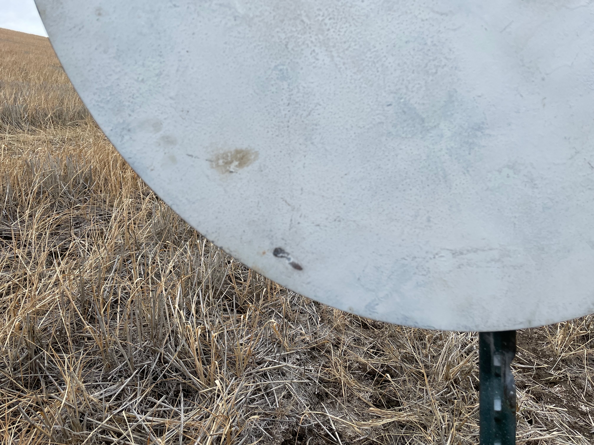

I finally got a decent load for the Badlands ICBM 255gr .338 cal bullet last week. Running a bit slow at 2855 out of my 26" barrel, but it had an SD of 7 across 9 rounds and was pretty solid .75moa so I decided to stretch it out. I put a couple rounds on a full size IPSC at 1820 with satisfactory results so I pushed further to 2510 yards. At 2510 yards I was really struggling..... really didn't feel like there was any consistency to where my bullets were going vs POA. I finally managed to make 1 hit (30" circle) on my last and final 15th round.
Is it just me, or does this impact look like the bullet hit the plate sideways? Is it possible my bullets have lost stability at that distance?
I plan to go back to load development and push speed higher but no matter how fast I push, the bullet won't be supersonic at that kind of distance anymore.

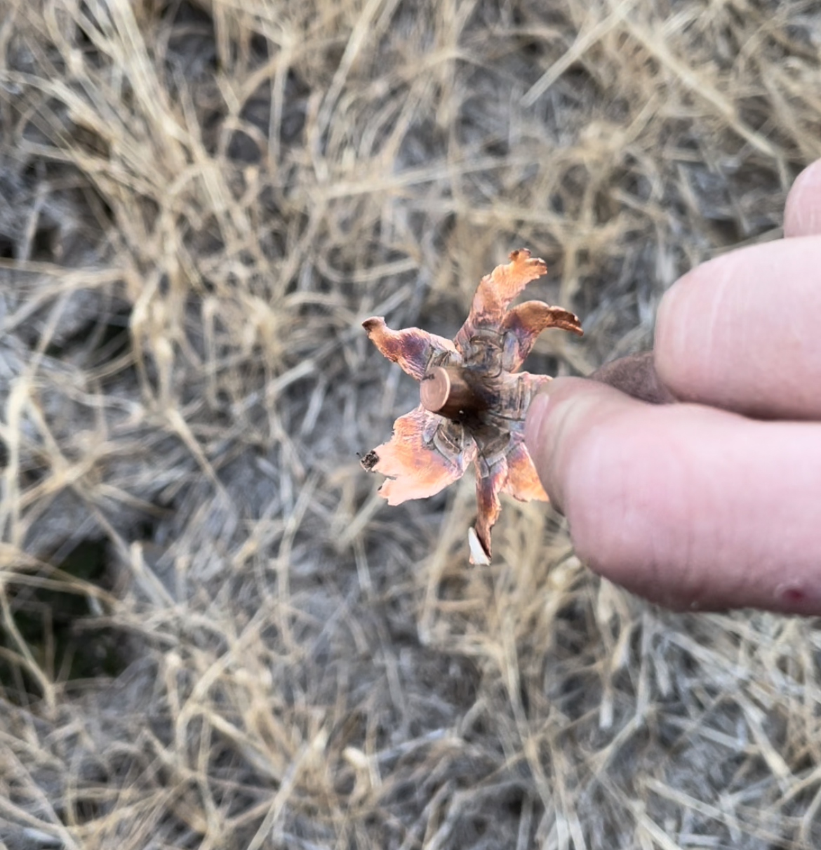

Awesome, thank you! The only bullet I've been able to recover is one that hit my plate so it's pretty well wrecked.
Is the base and at least part of the shank where the barrel engraves onto it still intact?
The front can be messed up, but what you are looking at is the base and groves engraved into the driving area.
