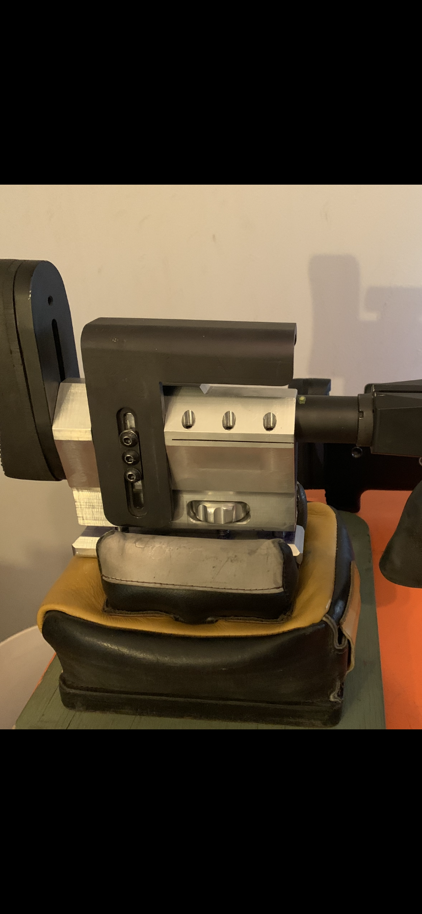

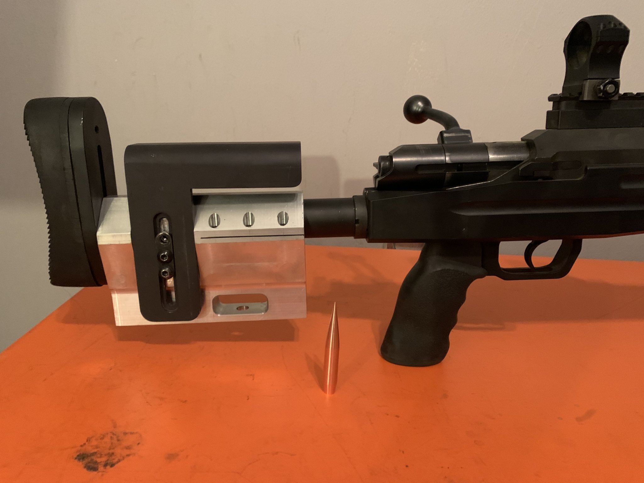

A straight bottom bag rider I found is best for the big heavy rifles. This year I’ll run a Phoenix on the front for gross adjustment and my new bag rider for the XLR in the back for the micro adjustments. I like when the rifle tracks straight back on recoil and the reticle doesn’t move. One less variable to add to the mix. There are some significant handling differences between a 50bmg with heavy recoil vs my 300norma improved. I can shoot the Norma improved well with a rear squeeze bag, the big heavy Armalite.. not so much. The armalite shoots real small groups with a good heavy bag and a good setup. I like to keep the TRG with the Norma barrel set up and proficient for field matches, that’s what it’s built for.
Need to add the adjustable foot to the back end, and I’ll bolt the stock XLR bmg butt pad on the mechanism. Should be a good setup when it’s done. Image attached for ideas. Will fit on the xlr stock tube.

im guessing that adjustable bag rider that is pictured is a custom product?
thanks for the info
For now. I’ll begin carving on it over Christmas/New Years. Hopefully have it done by the end of New Years. Busy as hell at work with other projects. If it’s a hit, maybe I should make a few of them. I’ll post some pictures as it comes to shape.

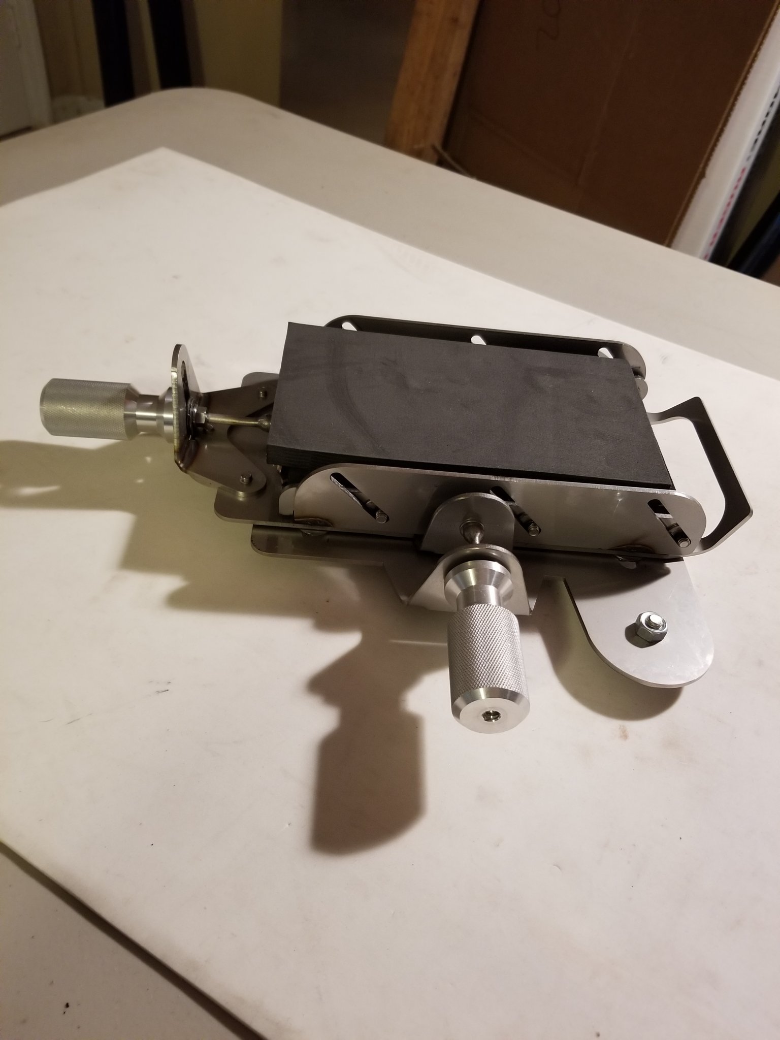

As promised.. got a little work done on this thing. Hand wheel, bronze bushing, vertical posts and bag rider foot will be later this week.

Ahh, direct from the adjustable bag rider guy will be cool. They make nice stuff. I made bronze bushings for mine, they use linear bearings. Had to take a screen shot of the photo cause it was too big I guess. Finished product turned out nice. Runs real smooth, that was the goal. I’ll anodize it in the coming month or so. Got a bunch of other parts to make black. Need to get some other small bits and pieces made yet.
