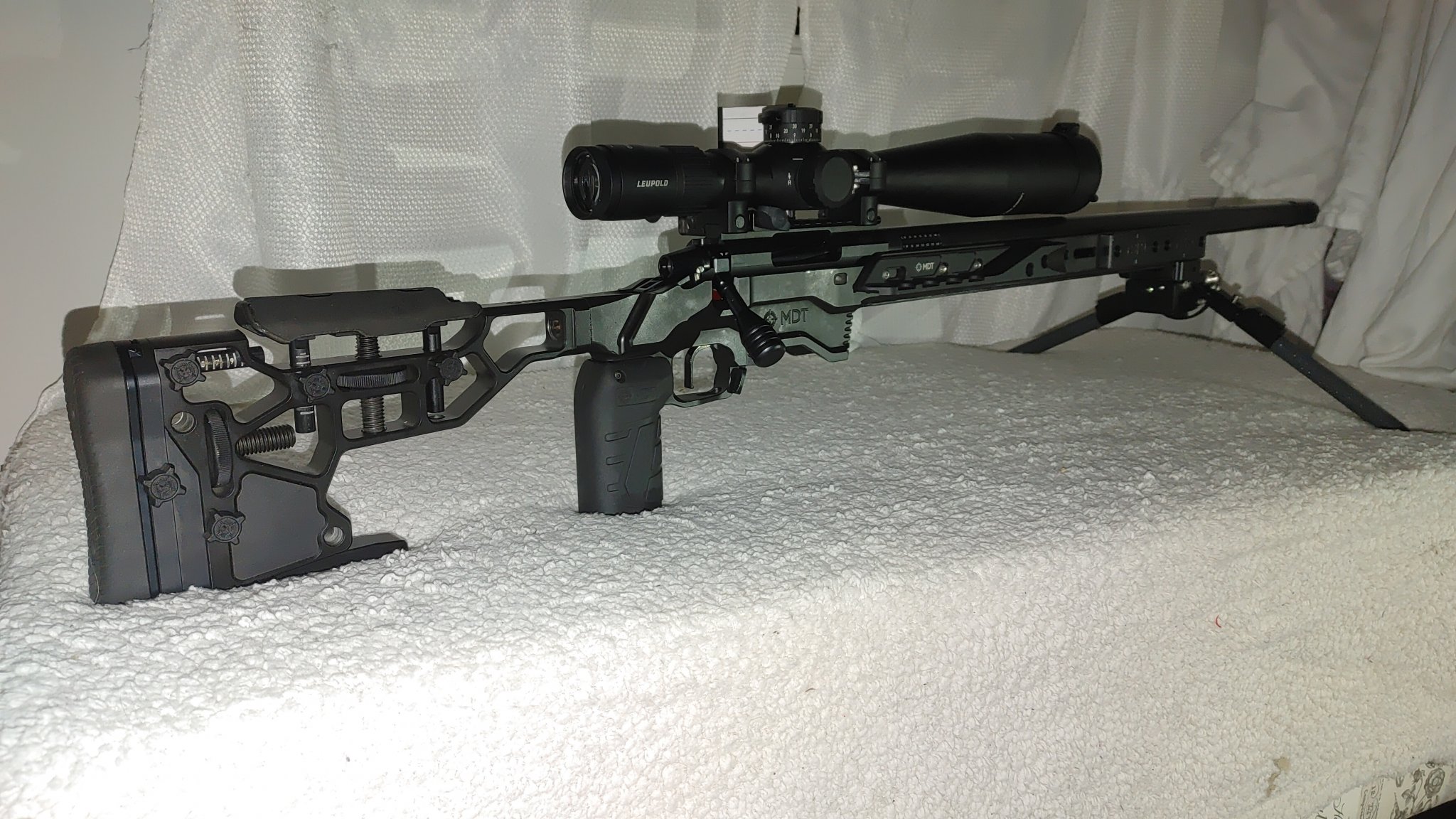

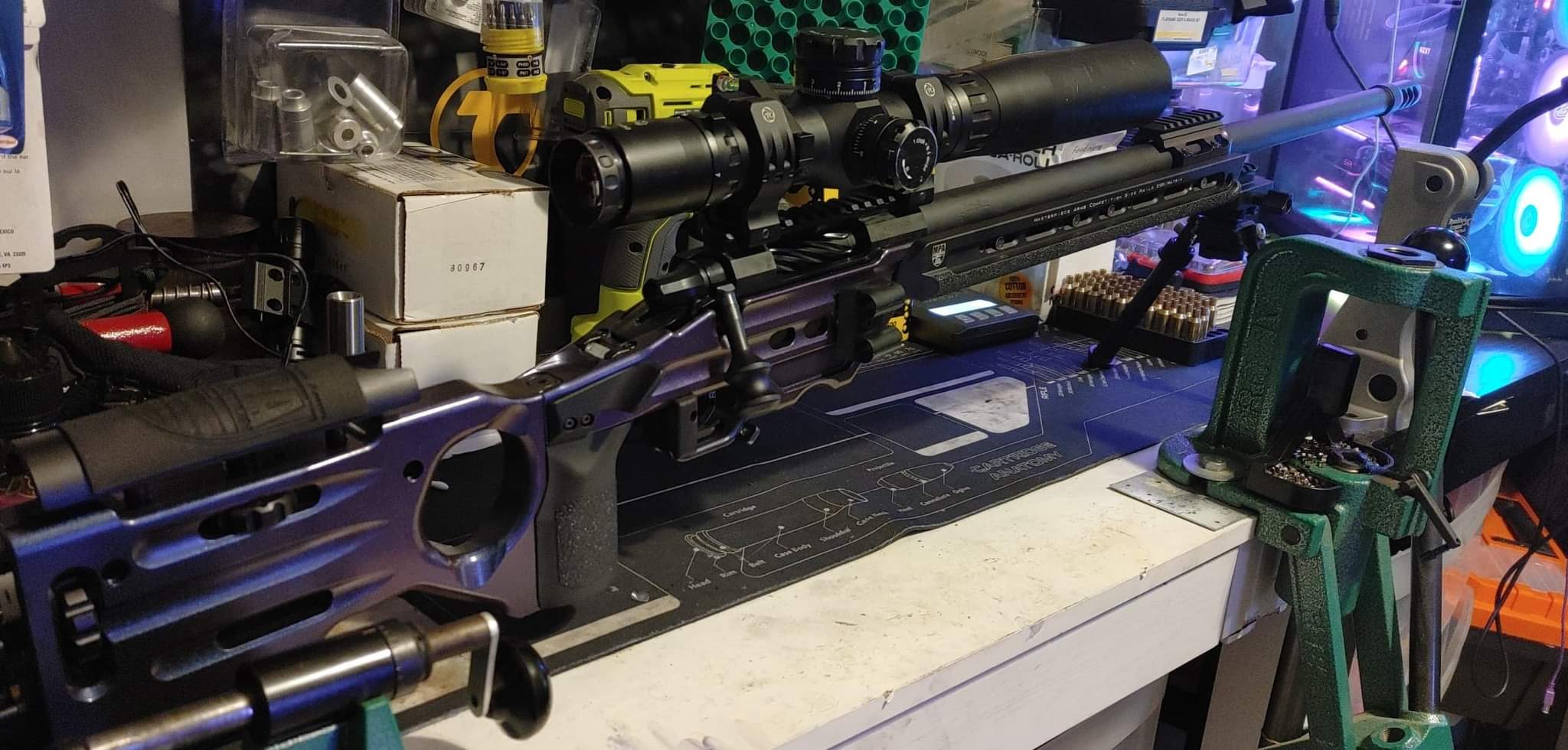

Hey guys,
I have an MDT setup and an MPA setup, I'll put my build lists below but I am trying to balance both rifles to take as much wobble out as possible and am having some issues. My MPA chassis is balanced about 1-1 and half inches in front of the magwell and it has resulted in pretty amazing stability yet most folks seem to recommend 3-4 inches Infront of the mag well, this is also where my MDT is balanced at.
The MDT though is no where near as stable as the MPA, even though it should be more, in theory. The MDT weighs 26lbs vs 22.5 on the MPA. The MDT has a 4 inch contact area on the bag vs 3 inches on the MPA.
Why is this happening?

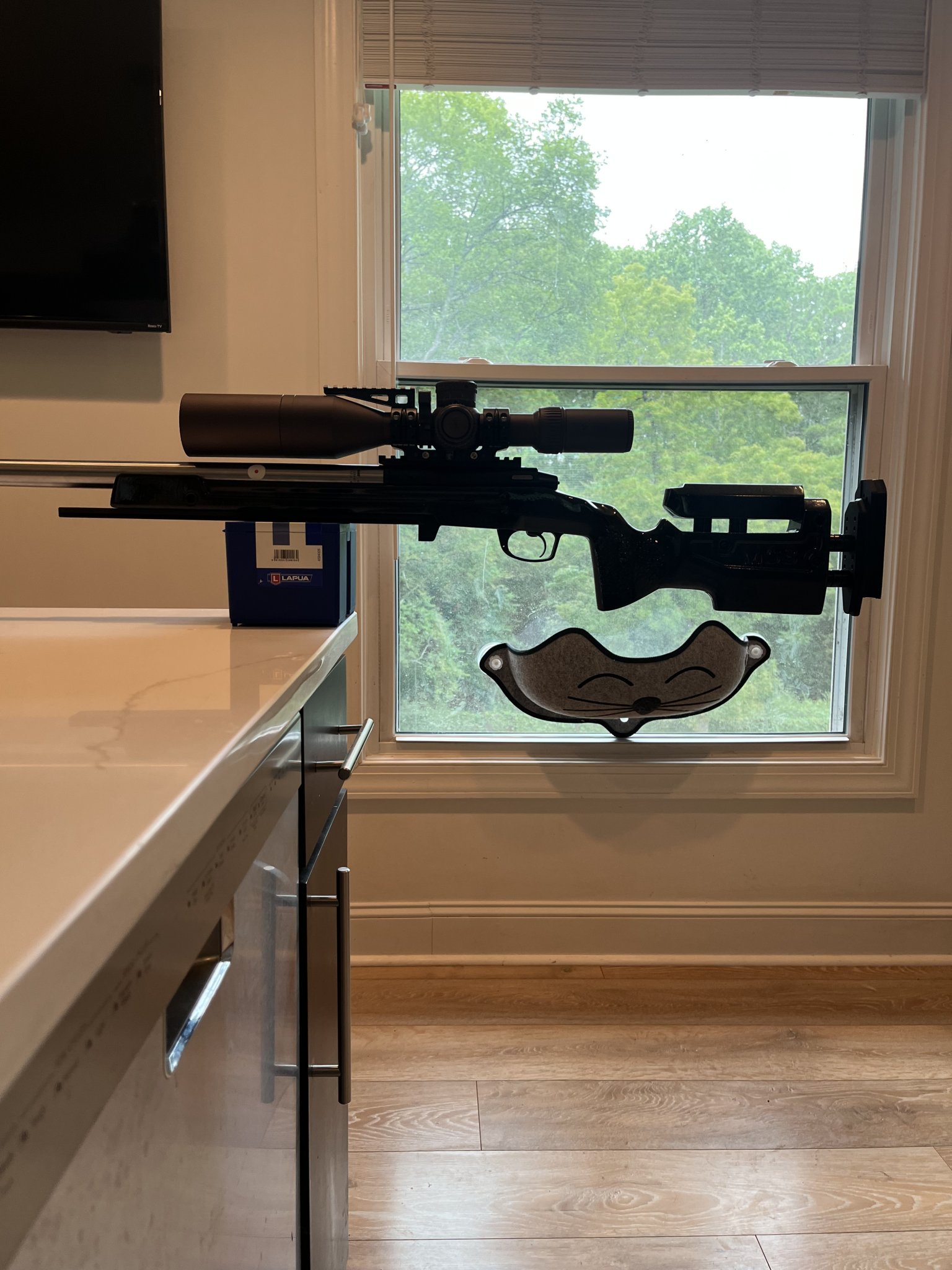

FWIW, I use a Lapua blue box to find where I like my balance:
Appreciate the response, and other responses above as well. Let me preface a little bit. The rifle will balance like how you pictured. The MDT honestly balances about where yours does. Yet I have a good bit more wobble with it than I do the MPA. Like B6Graham said though, it could be how I'm interfacing with the rifle myself. Have thought of that just haven't really thought of a way to quantify that and test the theory. I just love my ACC chassis and would really like to make it as stable as my Matrix. If it's just simply not possible then maybe the ACC Elite will be a better fit or one of the new J Allen's when they drop.

the rifle on the Lapua blue box would be WAY too front heavy for me so if that's where your ACC is that may be why it feels off, compared to the MPA which probably balances up against the magwell
Yeah, I’ve just recently gone to a more forward bias (so far I’m digging it), the pic looks deceiving though, in that that’s as far out as it’ll go, most of the mass is still closer to the magwell. IIRC I actually ended up putting 1 of the weights back into the rail near the magwell after taking that pic.
I agree though that the bias is probably what’s messing with the OP: the forward-bias is great for barricade/bag type stuff, but since taking a little more than a full pound off the ass end, it’s not nearly as easy to shoot groups with off a bench or whatever.

So last night I was playing with both rifles trying to figure this out and if it was just balance or not. I realized the MPA was certainly rear heavy rather than front. So I took 4lb off the front of my MDT and it balanced an inch further back and it got way more stable. So I tapped a 1lb weight to the rear of the rifle and then it got stupid stable. It seems I stabilize with rear heavy rifles and most folks seem to hate rear heavy rifles.

Preciate the response. It was a bit of both. I actually increased my LOP substantially and raised my butt pad up and man, I'm falling in love with the rifle all over again. Going to the range tomorrow to test my work on steel.
