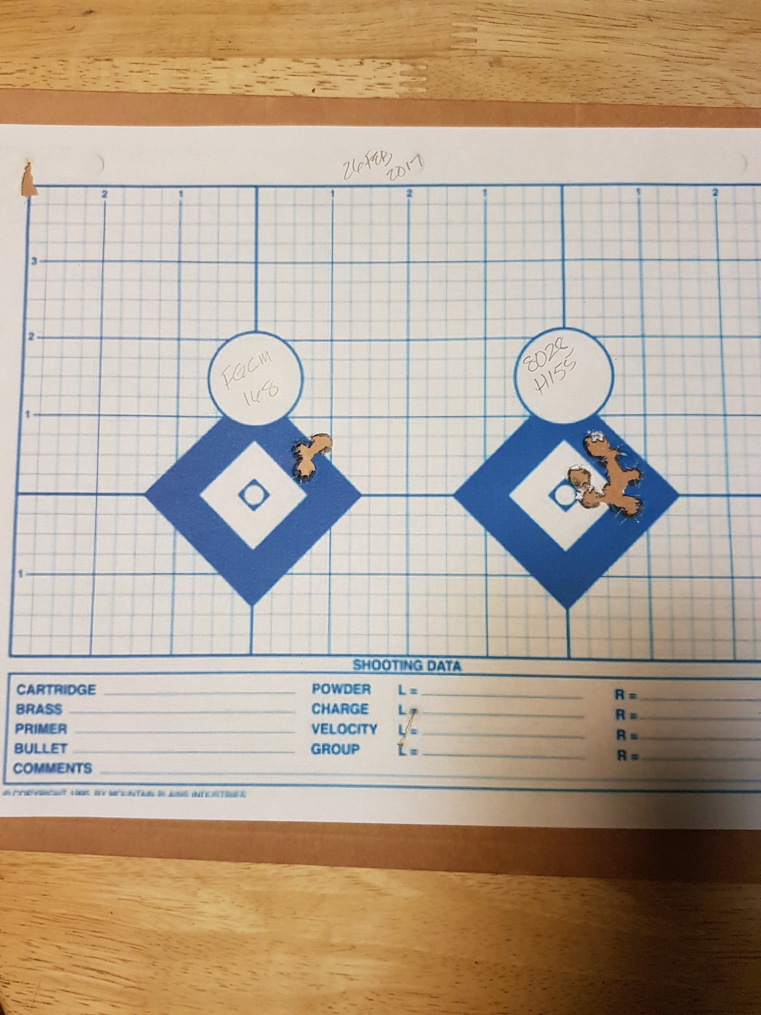

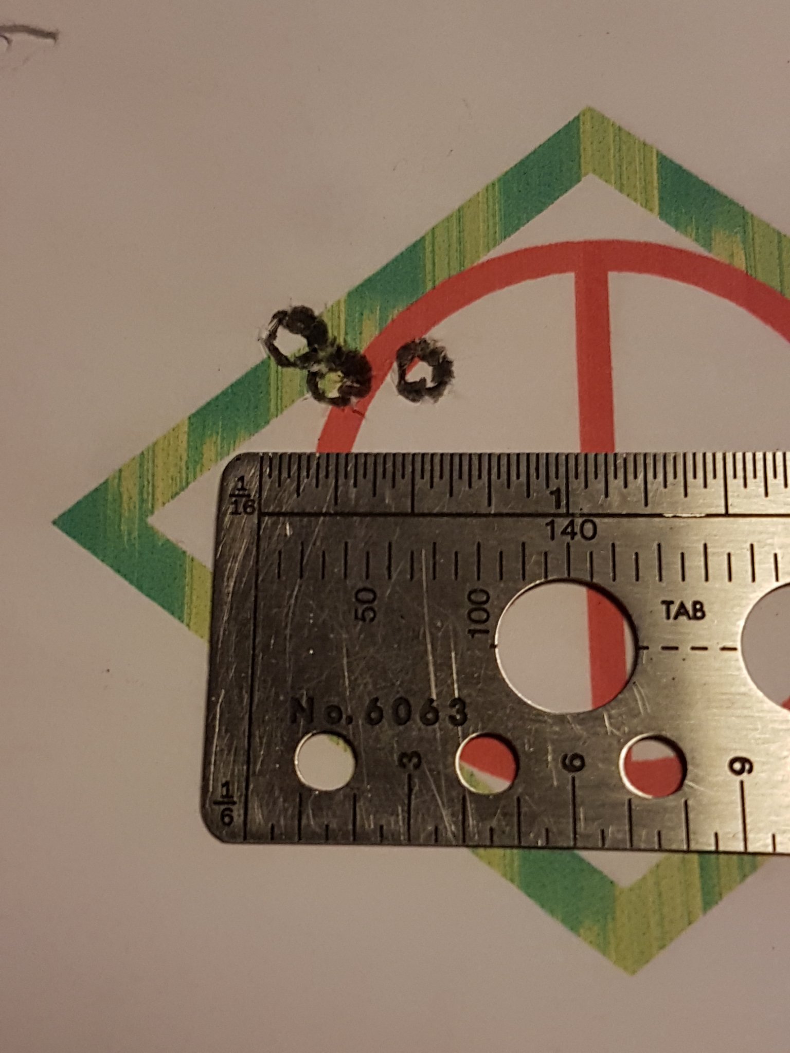

...FWIW, I have BA barrels in 300BLK, 556/.223, .308Win & 6ARC, all AR platforms. I have found tangent & "hybrid" bullets more forgiving of jump and easier to find a tighter shooting load than with the secant style bullets. The bullet you referenced is a secant style. It is possible to develop an accurate load for BA barrels when using secant bullets. The 2 pics below are pressure test results from my BA 6ARC w/Berger 95VLD (secant) and 308 w/HDY 155 OTM (secant) comparing to FGMM 168 (tangent), both are from the first range session of the new barrels.

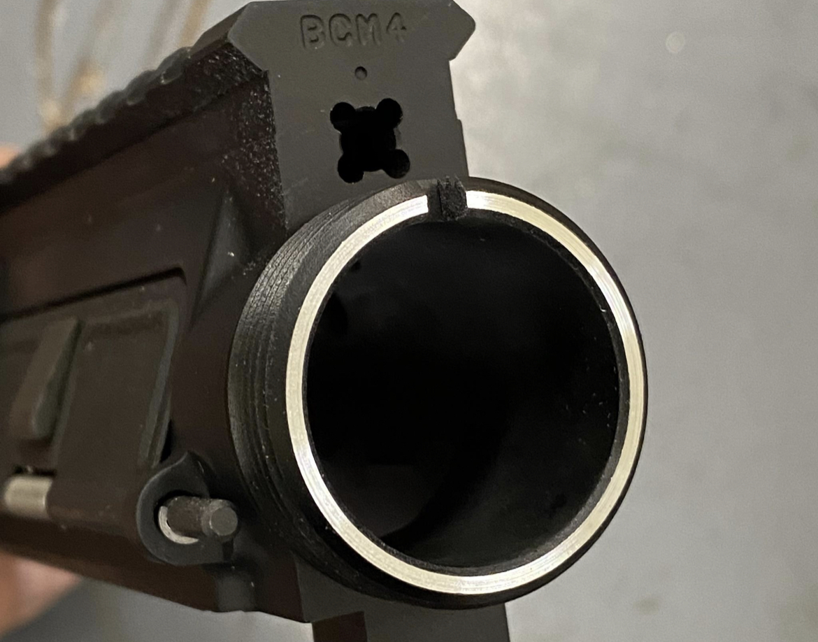

You are doing a precision gas gun did you check or true up the receiver face?
My 6.5 Grendel with a BA barrel shoots sub Moa with hornady black 123 eld m loads.

Nope I just slapped it together like quite a few before it but yes no doubt truing would eliminate that doubt regarding accuracy. But you see that target r.tenorio671 posted , specifically the group on the right, I can get my Grendel to consistently group like that with Sierra 120 mk’s/AR Comp load. And my buddies Grendel which also would not group with hornady match bullets (not talking about eld’s) instantly starting grouping with Sierra 120 mk’s/RL-15. I have some Sierra 107 mk’s comíng in this week and anxious to throw some loads. We’ll see if this BA 6 arc barrel doesn’t respond like the Grendel’s did. Thanks for the responses

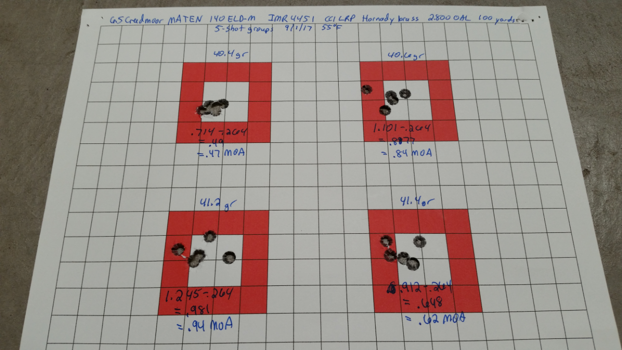

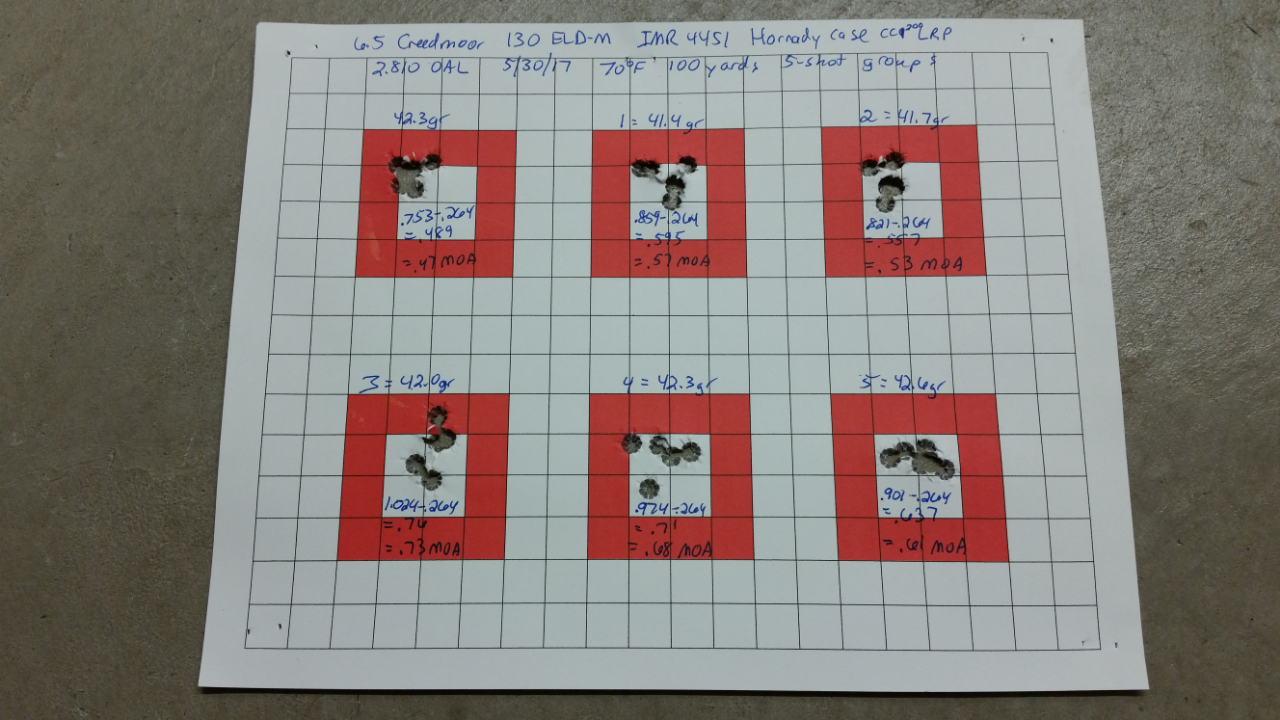

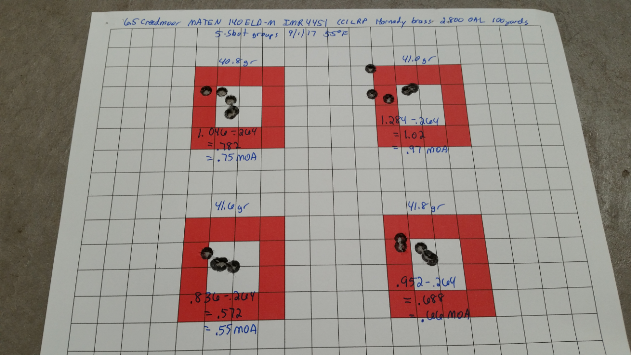

I've been very happy with the BA barrel (6.5 CM 22 inch heavy barrel) in my Mega Arms MATEN LR-308 AR. Here are a few targets during load development using the 130 ELD-M and 140 ELD-M bullets from a few years ago.
...I remember stevieb92's chronicling his 6.5CM build, alot of good info in that thread. The projectiles he used are "secant" profiles, indicative that once one finds the jump/charge combination that worked with the barrel an accurate load can be found...

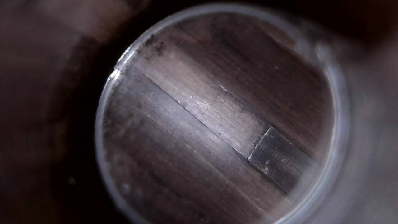

Here is BA QC for you. They sent out a butt load of barrels with this throat. That ridge was on every land in the throat. This was the Premium Black SS SPR series in a 18". There were a few other guys on sevral other boards that got the same thing in different grades of their barrels.
You may get a good one. But none of the 3 I have had met their 1 MOA guarantee. I sold all with the warning. I ended up getting a WOA spr and it shoots 60gr vmax under a 1/2".
